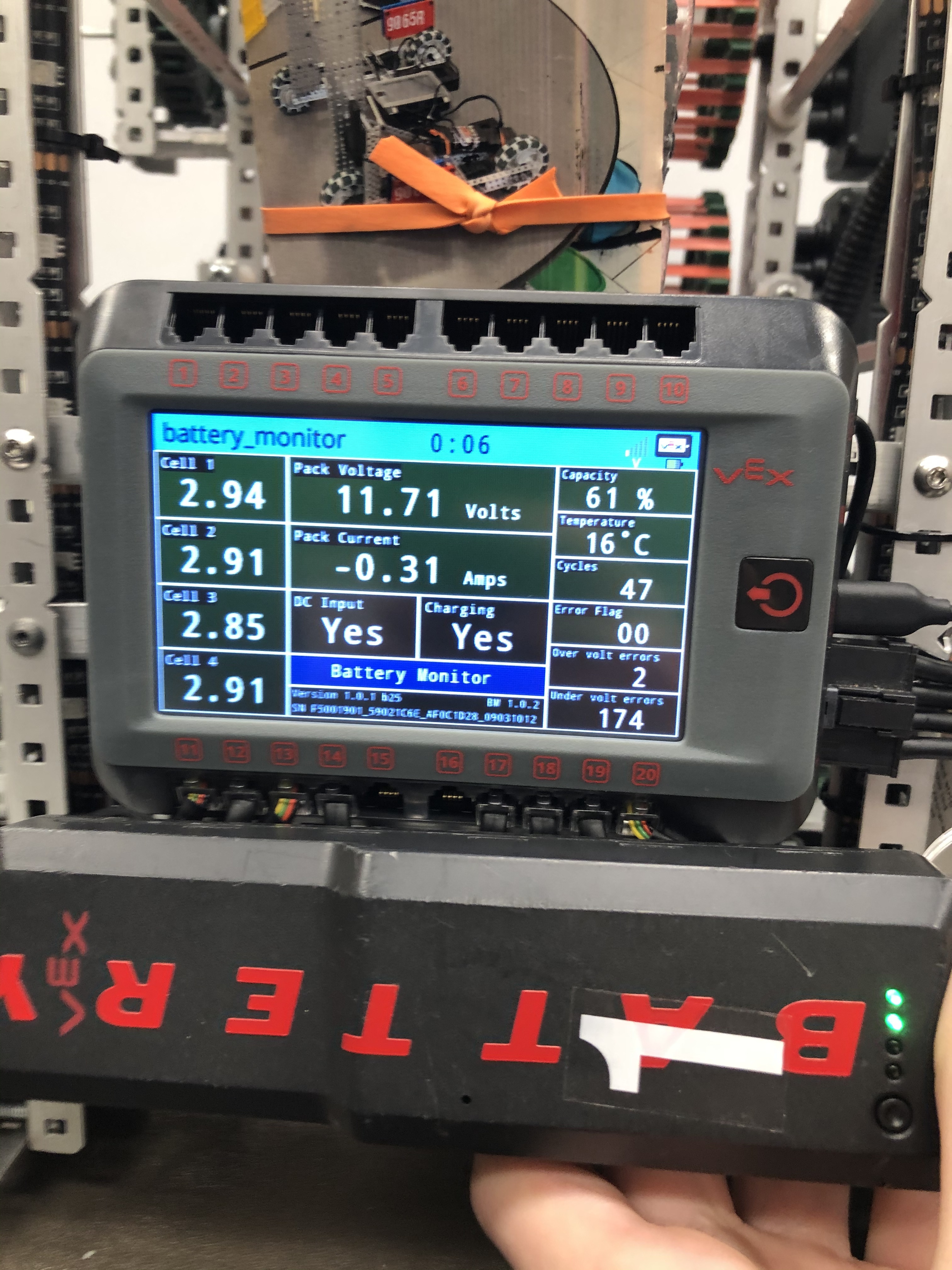

@jpearman . Sorry to bring back this topic but I was now able to bring batteries home and test them on the battery medic because I can’t get wifi at school. One of the batteries can turn the brain on for like 2 seconds then not work while the other two don’t even power on the brain. So how am I supposed to run it if I physically can’t

@jpearman we are trying to run the battery medic but when holding shift and v it wont’ pop up. What do we do
Just to be clear, you need to press shift+v and press the V5 icon. I had to try a couple times when I did the battery medic.

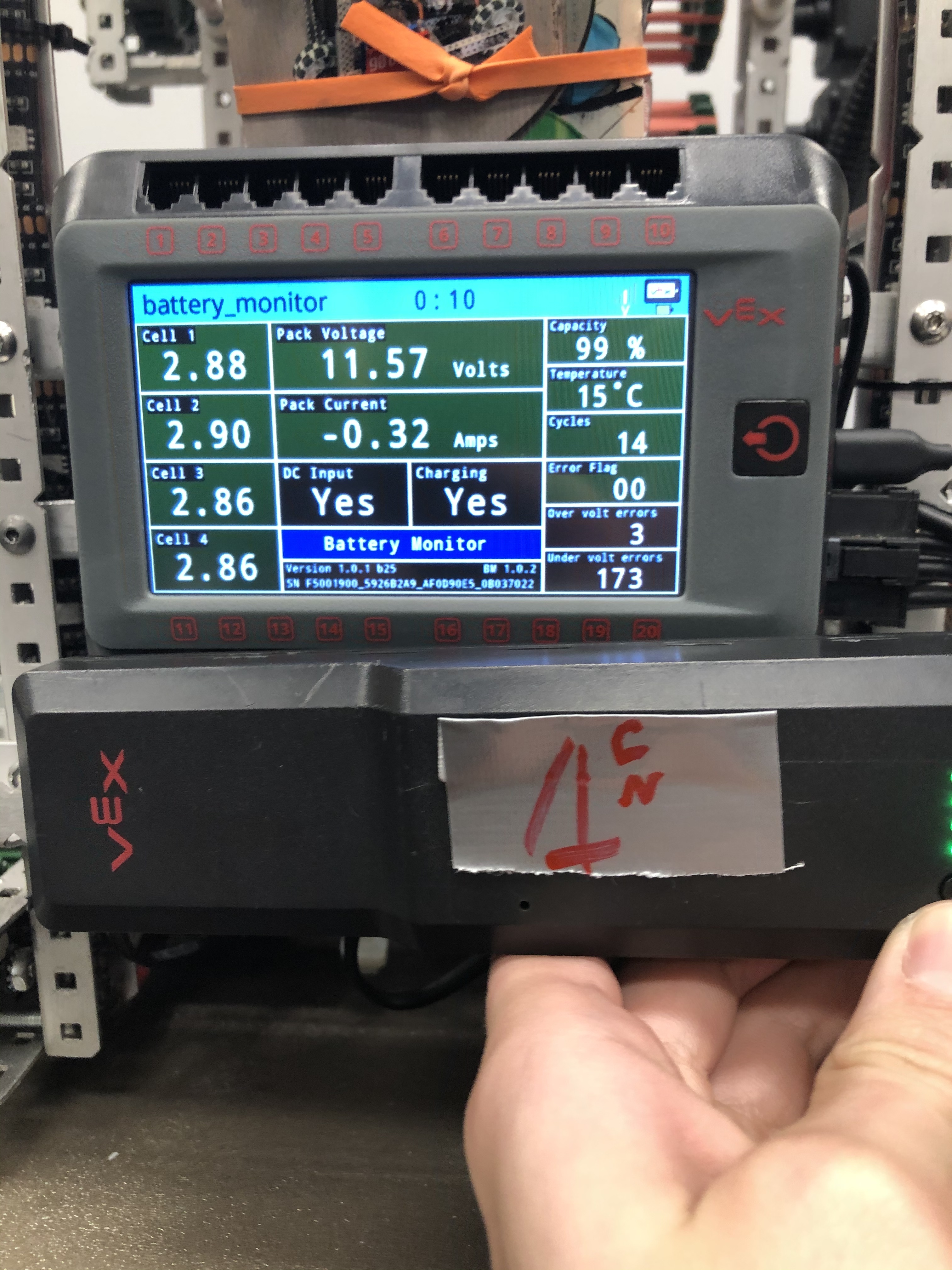

Thanks. Here the pic now.
Leave the battery connected and charging with the battery medic running until the “charging” label shows “No”, you should see a pack voltage close to 14.4 V, that may take 1 to 2 hours. Even though the battery in the first image shows 99%, the pack voltage is only 11.57 V, no where near charged (use of the reset button messes up the capacity display as I said earlier).
Once it is charged, disconnect the charger and see how the cells behave as it discharges. You have a huge number of under volt errors, we need to see if one cell is bad or if you kept trying to use a discharged battery.

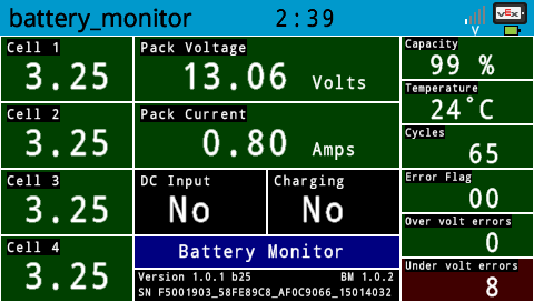

I’ve tried the battery medic, and so I’ve inserted these two screenshots, which I think are probably most relevant. The other screenshots I have are included in a zipped folder further down.

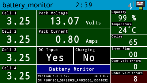

This is the max battery power it got when I charged it all the way through, at which point it stopped charging (sorry I didn’t get a pic at exactly 100%, but this should be close enough).
According to this (that JPearman also posted), the pack voltage should reach 14.4V and the cells should reach 3.6 V. :face_with_raised_eyebrow:

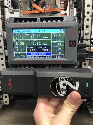

Then, I let the robot sit and run the battery down, and it died at around 47 % (it added an under volt error as you can see). I had to recharge the battery a little bit to reconnect to the computer and restart battery medic and I got this right before the battery died.
The cells are all fairly close to under volt shutdown.

Did the “charging” label switch to No ? How did you determine it stopped charging ?
Ok, I looked at the other screen shots. It did finish charging due to timeout.
Try that again with motors etc. disconnected from the V5 brain, that battery was only charging at .22A, (it would be 1A if disconnected from the brain, and close to 0.75A if the brain has no other load) so I’m not surprised it was taking a long time.

I then unplugged the charger and took another screenshot.
The sporadic screenshots are due to the fact that I was running a batch script (my first!) on my computer that took a screenshot every 3 minutes (or sooner if I pressed a key).
See above re charging with less load on the V5, if the pack voltage does not get close to 14.4V then there’s something wrong with the battery,
