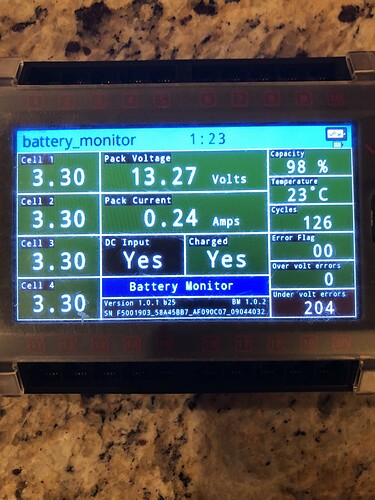

Well some how the percersnge and pack voltage last time a checked. Here you go
thanks this will help my team a lot
ok, so charging completed and now the battery is powering the V5. The charger is still connected so if capacity reaches 80% it will start charging again. Disconnect the charger to see how the battery discharges all the way to shutdown.
Once charging stops, the voltage drops quickly in the first 30 seconds, you can see that in the graph in this post.
All cells seem well balanced (ie. they all read the same voltage), so I don’t really see anything wrong. It should last 10 to 15 minutes or so when driving around a competition robot.

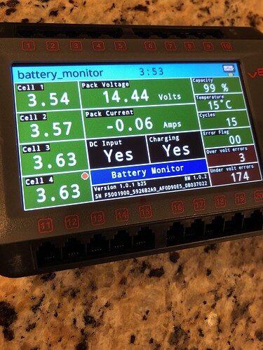

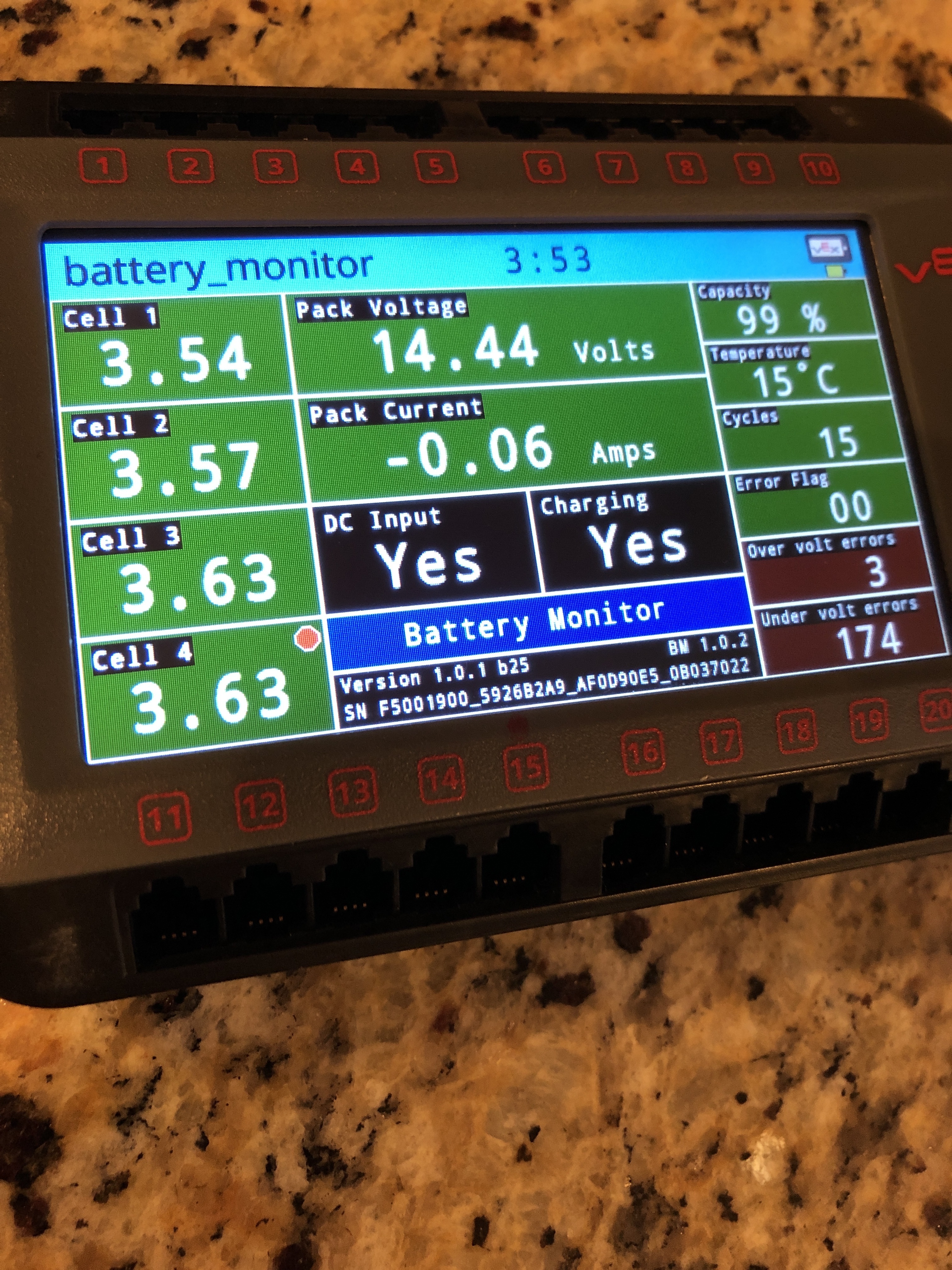

Ok I just stared my second battery and already has a problem. Does this mean it’s broken?
I don’t see any problem, should finish charge soon.
What does the little red dot on cell 4 mean?
The red dot means the cell is being balanced, charge is being withheld from that cell to allow others with lower voltage to charge more.

Do overvolt errors effect the battery at all because that battery did have 3 over volt errors and 174 undervolt errors
Nothing to be concerned about.
An over volt error can occur during charging if one cell has a state of charge that’s not balanced with the others and causes charging to be terminated. As the battery is used, the firmware will try and balance that cell with the other three, usually that will stop any further over volt errors occurring.
The battery above has many under volt errors, these occur if one cell drops below a certain voltage during discharge, again usually caused by slight differences in the state of charge of the four cells or by one cell having slightly less charge capacity than the others. If you keep trying to use a discharged battery on the robot you will just add to the under volt errors.
These batteries are being used in a high current application, there’s a lot of demand on the battery, if they start mis-behaving then allow a full charge and perhaps discharge under a lighter load (just run the brain for a couple of hours).
