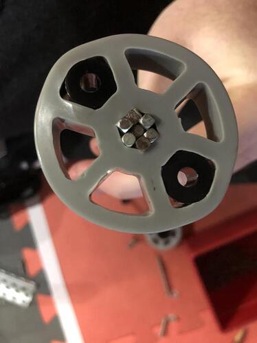

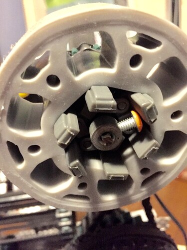

Flex wheels are really good stuff, the compression and the friction make them perfect for intakes. Unfortunately, as some people have discussed, The hubs used on the 3" and 4" wheels really take a lot of compression out of them, especially in the 3" wheels. Which is a shame, because the 3" wheels are a really nice size imo. So I experimented in alternate solutions that don’t reduce the compression, and I’ve found a slightly odd one that seems to work. I wrapped a 6t sprocket with friction treads, and jammed it into the hole in the flex wheel. the fit is so tight and the friction is so much that the two pieces are essentially locked in rotation. it would take tremendous force to make the wheel spin independently of the sprocket, far more than intakes should ever encounter. There is concern of the wheels slipping off the sprocket vertically, but again, the friction is so great that I doubt this will happen under any forces these intakes should ever encounter.
(the picture makes it look like that screw in the shaft collar is pushing on that one tread, but it’s actually not, just the angle. looks kind of janky in this picture though, even though it isn’t really)
I hope someone might find this useful, and if anyone else has any ideas I’d love to hear them.
This is very interesting to see. But have you actually tested it with that compared to the hub and if there is a difference do you think the difference is big enough to actually be more effective when intaking
its much much squishier like this. the hub removed almost all the compression, but this method preserves it.

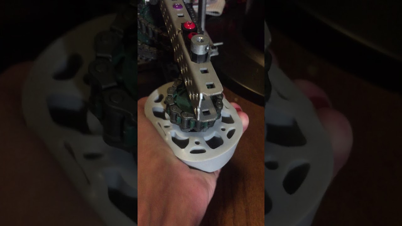

and here is the squish on mine:
I’d say its somewhere around twice as squishy, give or take a little squishiness. Definitely a worthwhile improvement over the hubs.
Thanks for that. Now I do have one more question. Even though it is a 30a grade it seemed like you were kind struggling to squish it. Was it just a weird angle or something.
even the 30a ones are pretty rigid, so it does take a bit of effort to squeeze. my arm was in at a very awkward angle though and I’m weak so it looks much harder to squeeze in the video than it actually is. I don’t think I’m actually applying any more force to the wheel in the video than it appears taran is in his.
