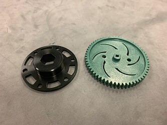

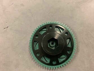

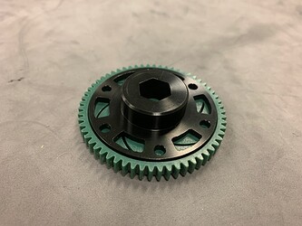

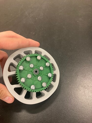

For the 2” flex wheels I’ve found that using a 12 tooth gear in place of the adapters works quite well. You can get the flex wheels to spin on the regular adapter, but with the gear the teeth grab quite well and the rotation is locked. Also, it’s completely flush with the side profile of the flex wheel instead of sticking out like the conventional adapters.
Have you tried this in a spinning flywheel though? I’m gonna try it later today if I finish modding the motor but I feel like that would expand out of the gears reach. Unsure though.
idk why you would want a 2" flywheel, and I wouldn’t trust this mount for speeds that flywheels run at. If you’re trying to run a 2" flywheel, I would just laser cut some poly to create a more secure mounting.
This would be more useful as an intake wheel, as it is likely spinning at a slower rpm and would be less likely to fall off the gear due to centrifugal forces.
Oh that’s 2 inches? Oh damn I didn’t even know :sob: I couldn’t see it looking at the picture. Wouldn’t touch that with a 6 foot pole (except for intakes but we’re doing rubber bands anyways)

I dunno, depends on the application (required RPMs). I’ll test it though, it might not even be a problem.
As the versahubs are limited right now, I could see this being useful for the intakes where they don’t spin fast enough to expand.

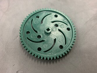

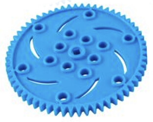

If you place a hub over a 60 standard gear they are close in size.
Use the hub as a template to drill 8-32 holes in the gear.
That’s not a bad idea. I assume you guys run these with clutches? Now I’m wondering how hard it would be to fit weights around the open space in the center. I feel like it could become a meme to use weird things as hubs… I mean more than it is… I mean, never mind. I like this idea though. Simple and easy to manufacture as well as efficient.
Thats the best non-poly solution ive seen yet, simple and effective. Only issue is you need to actually have one hub, and without its not any easier than polycarbonate
Couldn’t you just lay the gear over the flex wheel, see where the holes are then just mark them and then drill.
that could work, but its much harder to perfectly center the gear on the wheel without something to align to in the center. probably going to stick with poly for now

The IQ gear has the holes but the radius is a bit too long and it doesn’t fit unless you stretch the wheel. You might be able to use it to mark the hole positions in the VRC gear and drill inside the marks.

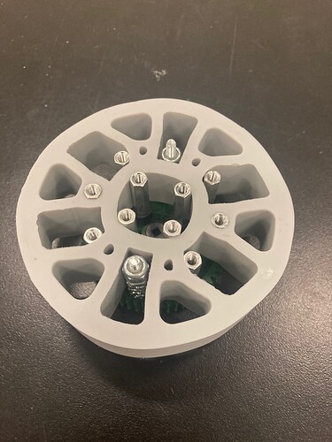

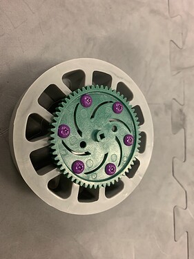

This was my solution to not having versa hubs, it’s not the most low profile solution, but it is good because you can change how much it weighs/ how much it holds the flex wheel
(Screw another gear on the other side or connect two of them together if you want two flex wheels on your flywheel)
It is important if you want to build this, notice the standoffs in the two holes on the flex wheel
I use this method, but with only the inside 4 standoffs and the 2 in the flex wheel holes.
Yeah, I added the other standoffs for weight and because anything less and the flywheel would start to warp at high speeds
