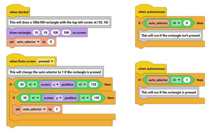

You can even do it in blocks! Of course, you would add as many rectangles as you need. You can experiment with the blocks to see how you want things to display differently.
