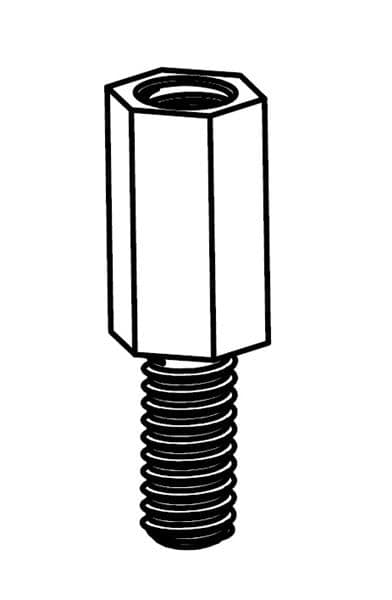

@Download Complete, don’t throw the broken standoff yet. You could ā€œrepairā€ it by using a 1" coupler screw to keep semi-broken end in place (use threadlocker to secure coupler) and essentially turn it into something like this to mount with a nut instead of a screw:

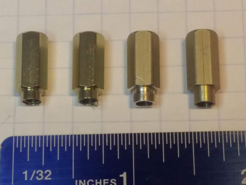

Luckily, there are commercially available alternatives that are even better than what comes with V5 motors. Here is the manufacturer link: https://www.biscoind.com/LynTronInc/AA6921D-0.437-00
Below is the picture with V5’s 8-32 motor inserts on the left and 6-32 replacements on the right. Leftmost insert is in the good condition and second from left started shredding some threads just after 3 mounts/dismounts. On the right is the commercially available replacement as it is shipped (it is slightly longer than original) and second from right is when it filed to have shorter length and with rounded bottom edges to match the shape of the V5 originals:

Are those inserts legal? They are not identical to the VEX ones.

Agreed that these would not be considered competition legal without a Q&A ruling.

I would say that according to G2 they should be legal, because it is a common sense to replace defective (and easily damaged) inserts with commercially available alternatives if VEX itself doesn’t sell replacements:
