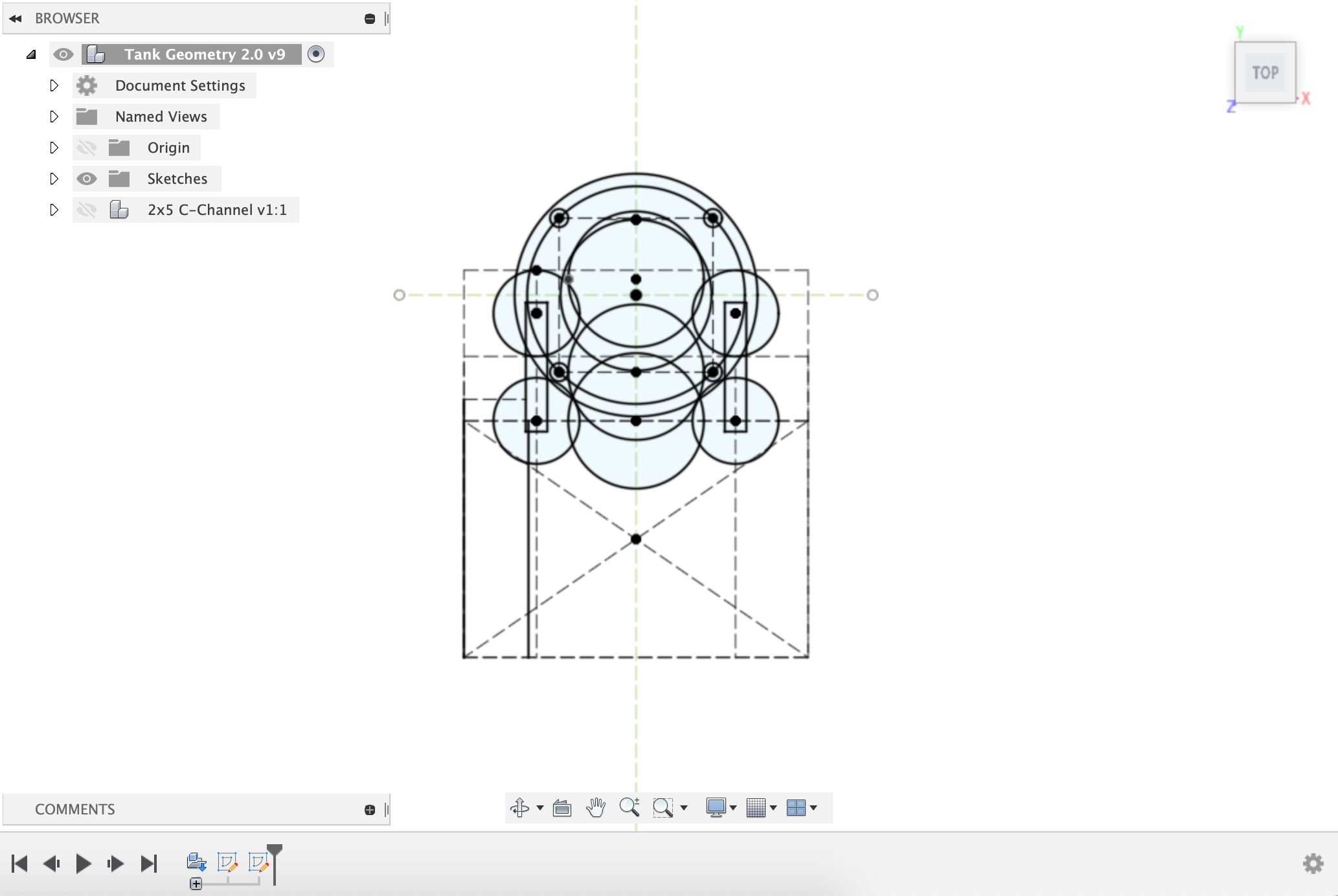

Examples from my Change Up Sketches

One of the most efficient ways to CAD is by projecting geometries of surfaces from already existing Vex parts/assemblies (kind of like the images above, a combination of optimized geometry as constrained by Vex parts). I know many people don’t utilize the CAD sketch tool for Vex assemblies often (mostly because you’re confined to Vex parts, not custom).

This is fairly accurate for a majority of the time, but something that can help is creating a semi-complete mockup through CAD, physically building it as a prototype, and playing around with it to understand how different manipulations can change the outcome. Through this, you can approach designing a second version much easier as you have the groundwork laid out for what has to be changed and what can remain the same.
