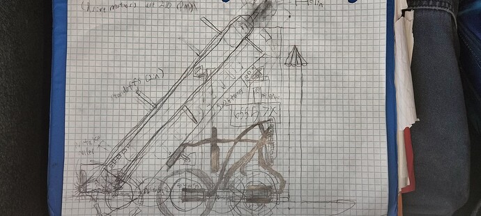

our teams blueprint looks like this, and is how a lot of teams do the basic mechanisms. This might give you an idea. If you don want to use it, most teams have: An axle at the front surrounded by something grippy to suck in rings, a conveyor belt to carry them up and backward and rop them, and a clamp using a c-channel to hook onto the mobile goals, and bring them onto a bar that hovers barely above the floor to keep away friction. This allows a way to drow the rings directly onto the mobile goal with little effort. To top it all off, a six wheeled drivetrain, with omni wheels on the outside, traction on he inside, and all connected, with 2 motors (green cartridge) powering each side, making 4 motors total for drive. The blueprint for one way to do it is below:
