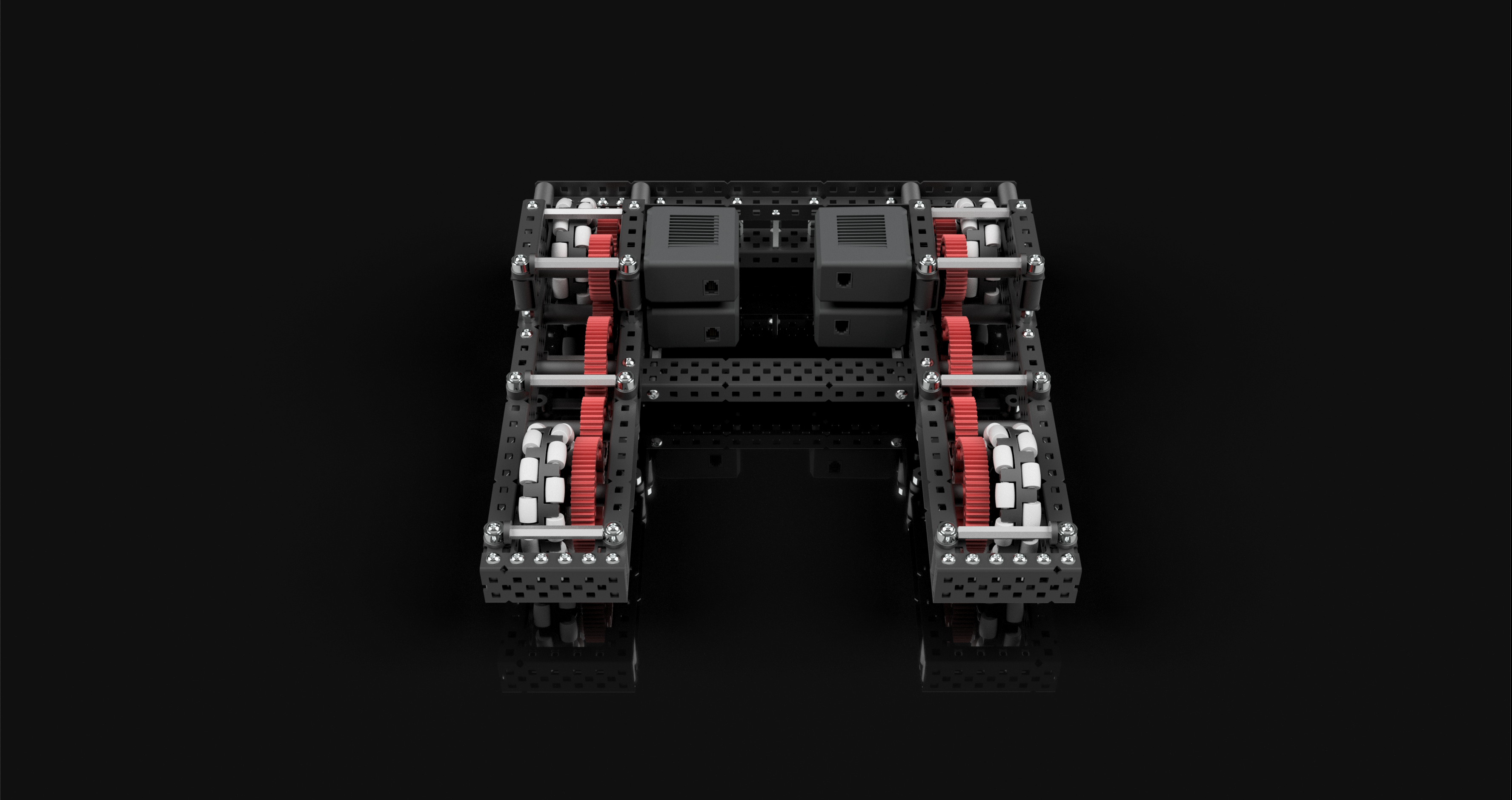

Quality Drive Version II:
Design Process
Here I’ll be detailing the process of designing this particular drive, and explain why it is how it is.
Size
I chose to make this particular drive small in profile, measuring 25x25 holes. I chose this size because I wanted a lower profile, more maneuverable drive with plenty of room for intakes and other mechanisms that could need to stick out. At this size, you essentially have 10 holes of space to work with on the front (or back) and 5 holes on each side. For a game like change up or tower takeover, smaller drive sizes were often advantageous, as it allowed robots to have static intakes (that is, intakes that don't require a deploy at the start of the match).
I also chose to make the drive small because the shorter a drive is, the fewer gears you need to link the very front and back wheels, which means lower complexity and friction overall.
However, this type of drive could easily be adapted for a larger size. Widening it is trivial, just lengthen the cross braces. Lengthening it is more difficult, you could either add 2 more gears to the front, which adds more friction, or you could do something like what many change up robots did, which is to have a very short drive, and then have some fixed, free-spinning wheels on the front of the drive to prevent tipping. Some examples of this are 2616j and 62a during the change up season.
As far as C channel size goes, I opted for 2 wide c channel this time, as there’s not really any advantage I’d gain by using 3 or 5 wide with this particular design, and compactness was one of my key goals.

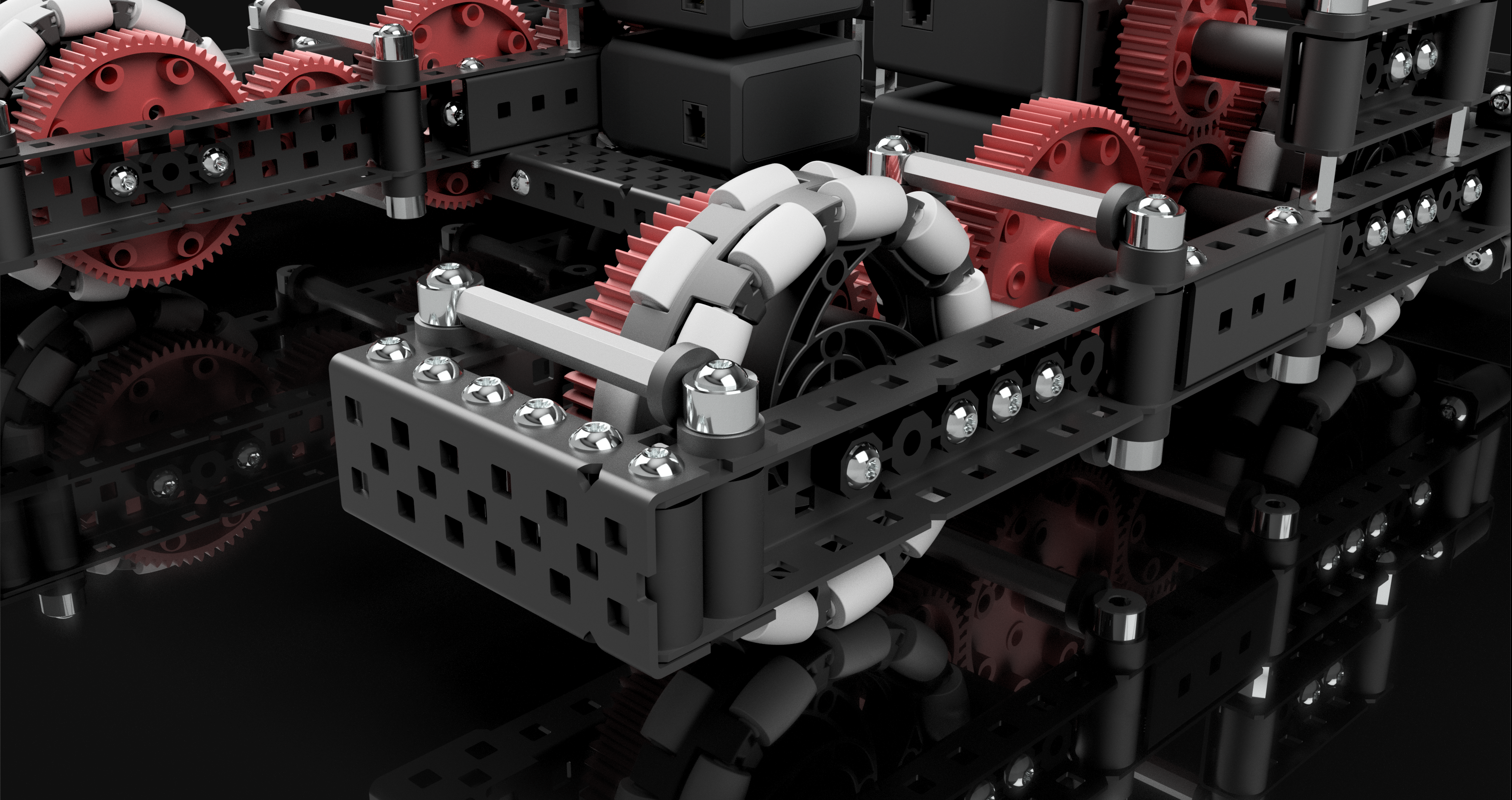

Gearing and Wheels
Let me preface this section by saying I have a strict personal policy against using chain for a drive. Many teams have used chain with large amounts of success, but I simply am not willing to risk the function of the most important part of my robot on a loop of plastic snap in place chain. I am willing to accept the extra complexity and friction as a tradeoff for the added reliability and reduced slop. Well worth the trade in my opinion, however you can certainly use chain if you so choose. Just make sure you are aware of the risks.
For this drive I’ve chosen to use a 3:5 gear ratio with 600 rpm motors on 3.25" wheels, which is 360rpm.
This is equivalent to 292.5 rpm on 4" wheels, and is roughly 46% faster than the basic 200 rpm direct drive to 4" wheels.
This gives a lot of speed to work with, and you really wouldn’t want to go faster than this for the majority of games (change up was certainly one exception to this though), but it still offers a decent amount of torque, enough where a relatively light robot built right shouldn’t have issues with the drive stalling.
I’ve also chosen to use high strength gears on my drive instead of low strength gears. The only advantage low strength gears offer is a very small reduction in friction, and a more compact profile, allowing you to fit your wheels, gearing, and drive channels into a 5 hole space, instead of a 6 hole space. But unless this additional compactness is crucial to your robot, I think high strength gears are better. Low strength gears have been known to do things like this.
Another factor I considered when designing this drive is slop. Slop is the term used to describe the amount of unwanted jiggle that something has. This is an incredibly important factor for a drive, since large amounts of slop in your wheels will allow your drive to move or turn a significant amount without you wanting it to, which is not good when trying to accurately program it. The first thing I do to decrease slop is to use 3.25" omni wheels that I can bolt directly to the 60 tooth gears on the same axle. This eliminates virtually all slop that the wheel might have with the shaft it’s connected to. There are ways to accomplish this with 4" wheels, but it’s easiest with 3.25" wheels since they have perfectly spaced holes. The second thing I did to reduce slop is to select a gear ratio that gears down the motor, instead of gearing it up. Here’s how that works: lets say a motor has a slop of 5 degrees. If you gear up 5:3, that 5 degrees will translate to 8.33 degrees in your wheel. But if you gear down 3:5 like I have here, that 5 degrees is reduced to 3. That means 3:5 has almost 1/3 of the slop than 5:3 has, which can help a lot with robot consistency, especially during autonomous.
Now lets talk more about the wheels. Why did I choose 3.25" wheels over 4" wheels? I love 3.25" wheels for many reasons, and I try to use them on my drives whenever possible.

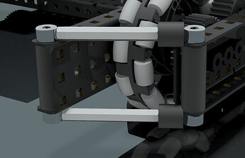

I will talk more in depth about the U channel bracing though.

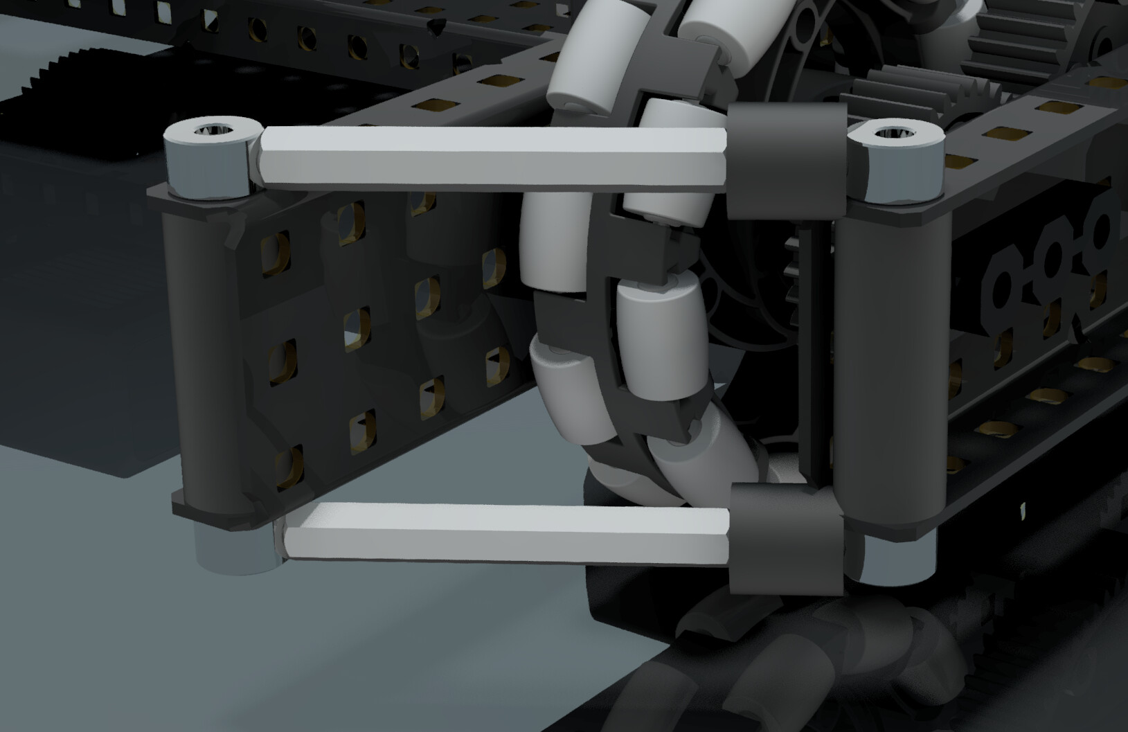

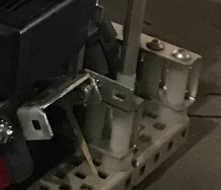

On my previous quality drive resource, I used a type of front brace with shaft collar and standoff construction creating a taper:
But on this version I opted for a more robust support, which uses a U channel with a notch cut in it for the wheel as well as standoffs to make a more rigid, robust, and compact brace.
This brace is more robust because it’s all one piece, and has multiple points of contact with each side of the drive. I also filled in the gap of the U channel with standoffs for even more strength. This is probably overkill, but it just ensures that this brace will be of the strongest build, and will be able to withstand any kind of defense or collisions your base may encounter, and it comes at a pretty low weight cost.

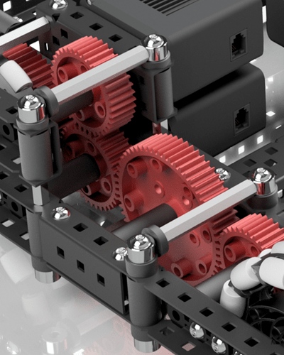

You may also notice the use of shaft collar standoff braces running along the top and bottom of the drive. These are not especially crucial to the drive, but they prevent the sides of the drive from being able to squish together or apart, and just add to the general rigidity of the drive.

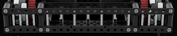

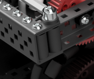

The next interesting brace I used on this drive was a modified C channel bumper in the back:
This is a similar style of bumper to what I used in my original quality drive:
But an issue with this kind of bumper is that your back wheels are not quite at the very back of your robot, which can be a problem if your robot tends to tip backwards.
What I did to improve this was cut some notches in the c channels so that the wheel fit further back in the robot. I also filled in the gap between the c channels with standoffs to prevent them from bending inwards or outwards. (I did end up building the first quality drive, and I accidentally stepped on the rear bumper, and it did permanently bend down, but with standoffs there that wouldn’t have happened)

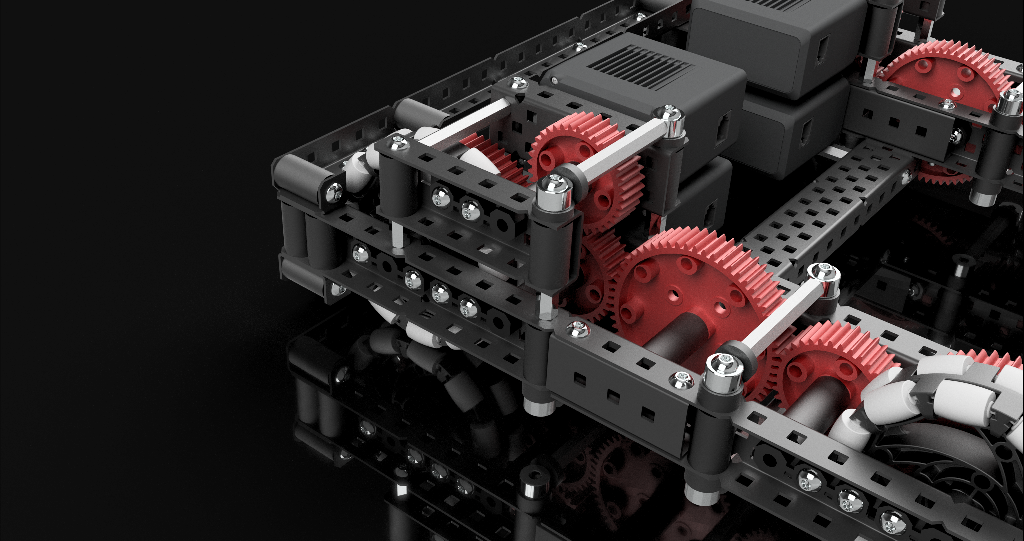

Motor Placement
You may have noticed that I've stacked my motors in the back of the robot. I've chosen to do this as a way to preserve space at the front of the drive. This space could be useful in many ways, you could have intakes there, tracking wheels for odometry, any number of things really. And if you don't need anything to be there, the motors on this type of drive don't have to be stacked, I just did so as an example of a way to conserve space at the front of the drive.

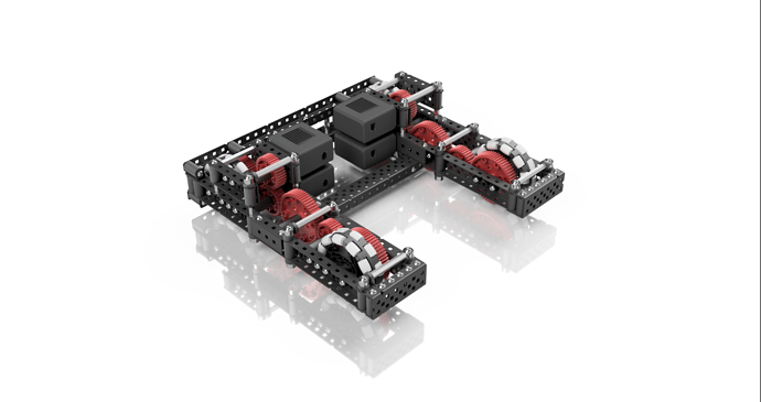

Renders
Here are all of the renders I made of this drive.
All of these renders were done by setting the background in inventor, tweaking the lighting, shadows, and reflection settings, and enabling raytracing on the highest quality.

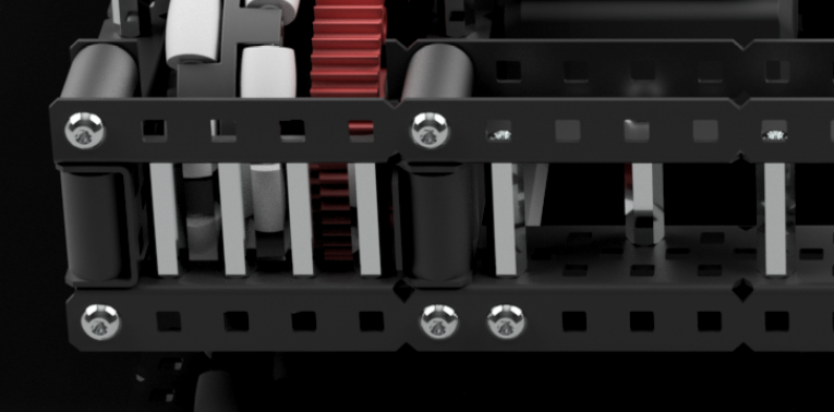

Box Bolts
A box bolt is where you put a long screw through an entire c channel, and fill the gap with spacers or standoffs. This gives the connection vastly more strength, and you should be doing this wherever possible.
Quality Drive v2.1 Box Bolt Closeup 1
in situations where you want to have a box bolt, but something else is in the way, for example a bearing, using C channel couplers instead is an alternative.
Quality Drive v2.1 C-Channel Coupler Closeup

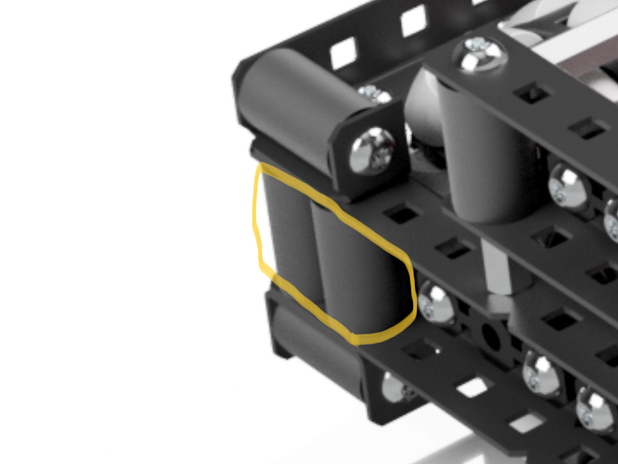

Can you explain how these spacers are attached? It is confusing me.
Just use thinner spacers on the top one, or grind them down.

Front Cross Brace:
For example, almost all of this can be replaced by two standoffs going across the inside distance and maintain similar structural integrity while being significantly lighter due to much fewer screws and nuts being used.
Gearbox Supports:
The shaft collar/standoff combos also don’t have to be there, and instead it is better off trying to fit a longer cross brace that goes across all 4 drive channels. The C-channel coupler in the middle also isn’t providing much in terms of support as the boxed spacers flanking it are taking most, if not all, of the load.
The Back Crossbar:
This is probably the heaviest brace on the design, and almost all of it really isn’t that necessary. The topmost channel is not doing much for boxing, as there are already spacers between the 4 main drive channels going the length of the base. The intermediary standoffs are also not required and can just be left empty. As for the standoffs going the length of the base, I would move those to be closer to the center of the base to provide support where there isn’t any in the case of defensive actions.
Spacer Boxes:
These horizontal spacers also don’t do much, as the reason spacers are used is to provide box support and prevent flanges from being bent in. As these are at the very ends of the base, they don’t do much.

I would agree that this front brace here is probably overkill. You could remove the standoffs inside the U channel, and remove the standoff shaft collar brace across the top there for weight reduction. The main reason I don’t like to use nothing but standoffs going across that distance is because it has fewer connection points. But yes that would work as well.
the shaft collar standoff braces here are indeed probably the least necessary of all the braces on this robot. Their main purpose is to stop the drive channels from squeezing in or out, but there really isn’t going to be many forces doing that to the robot, and it doesn’t really matter that much.
