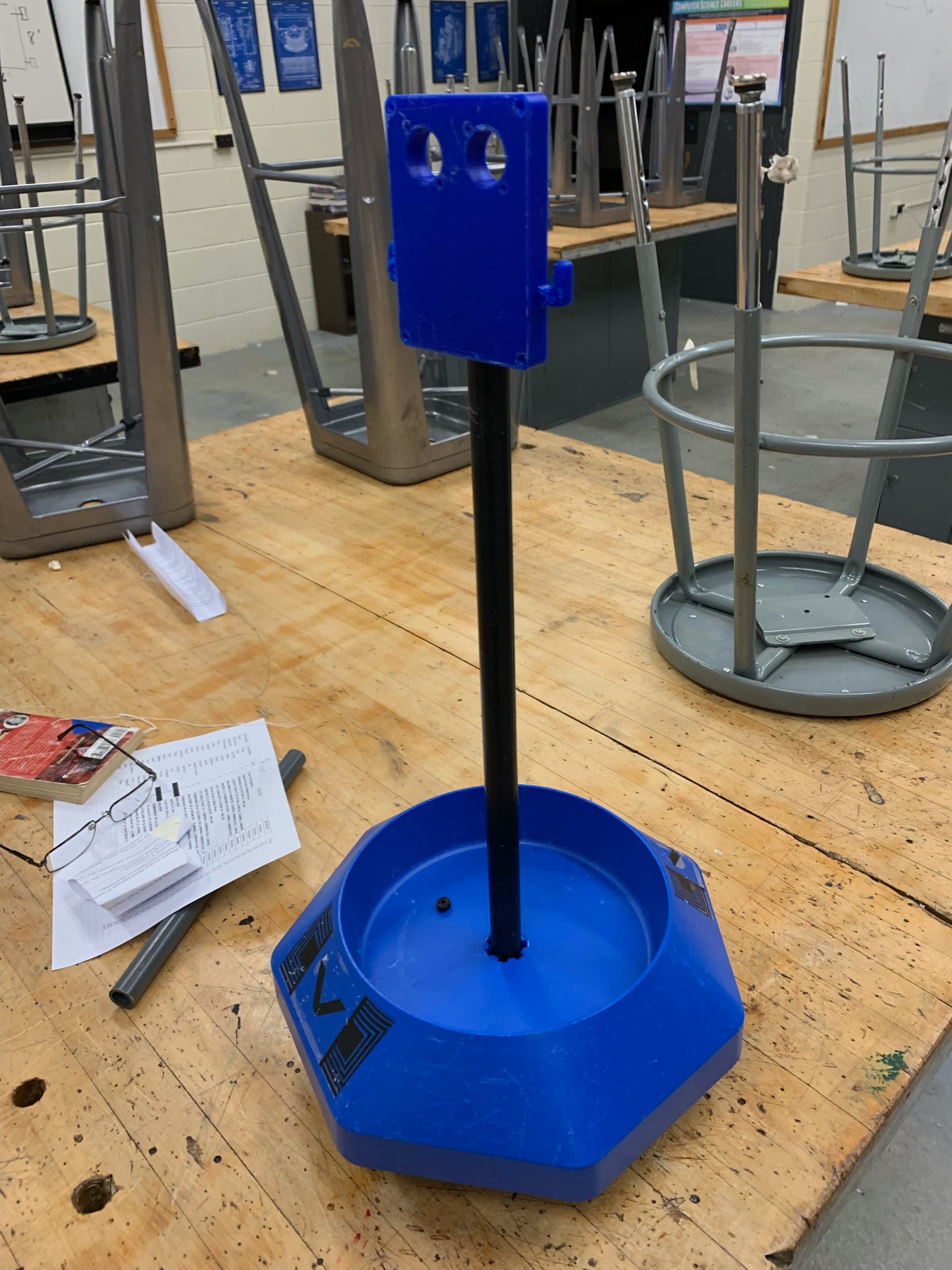

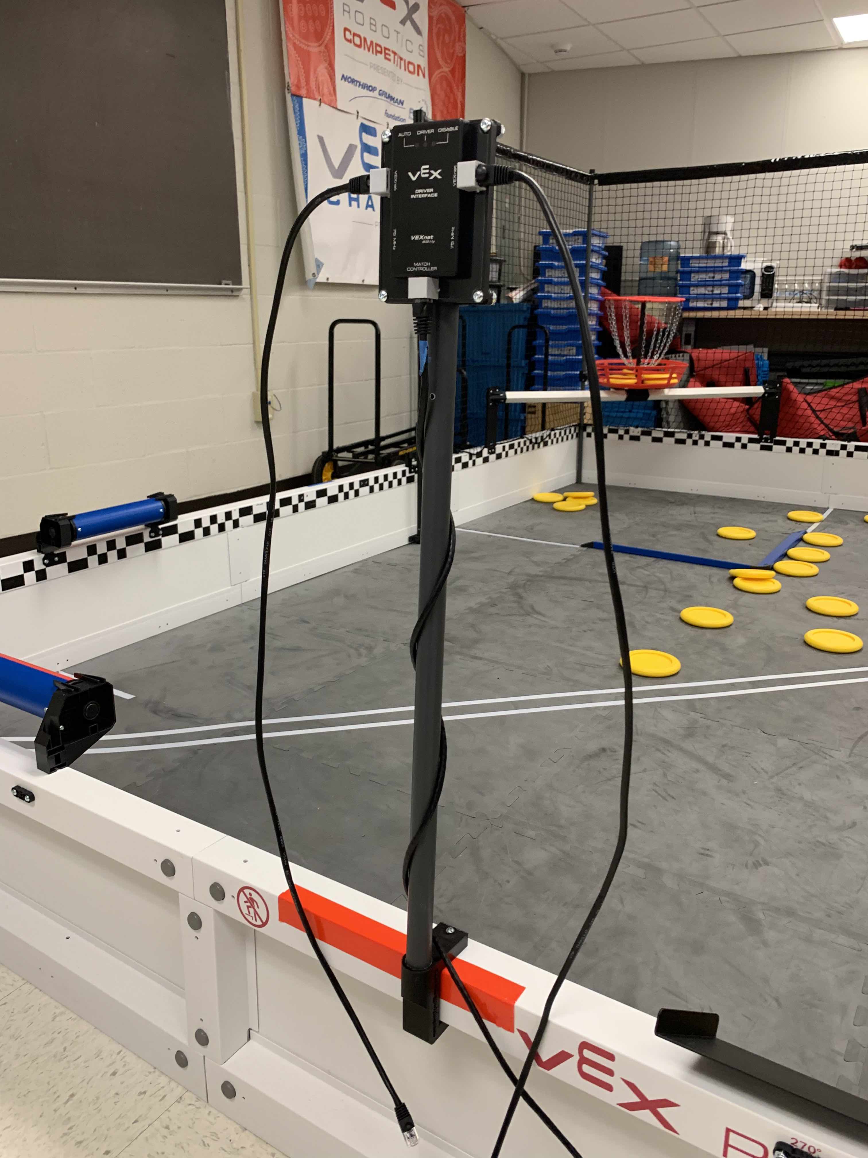

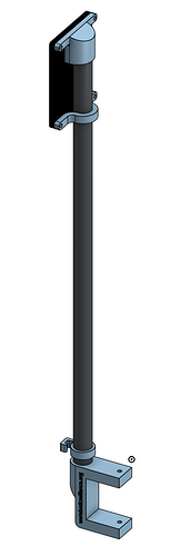

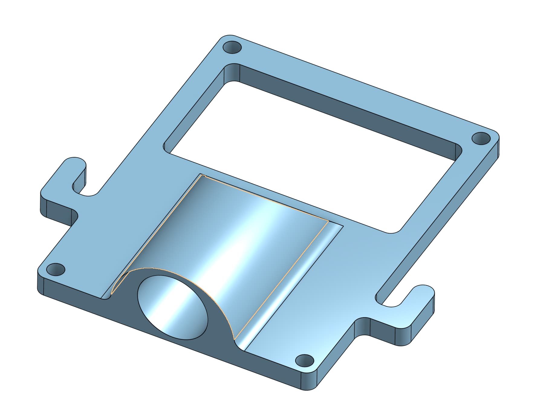

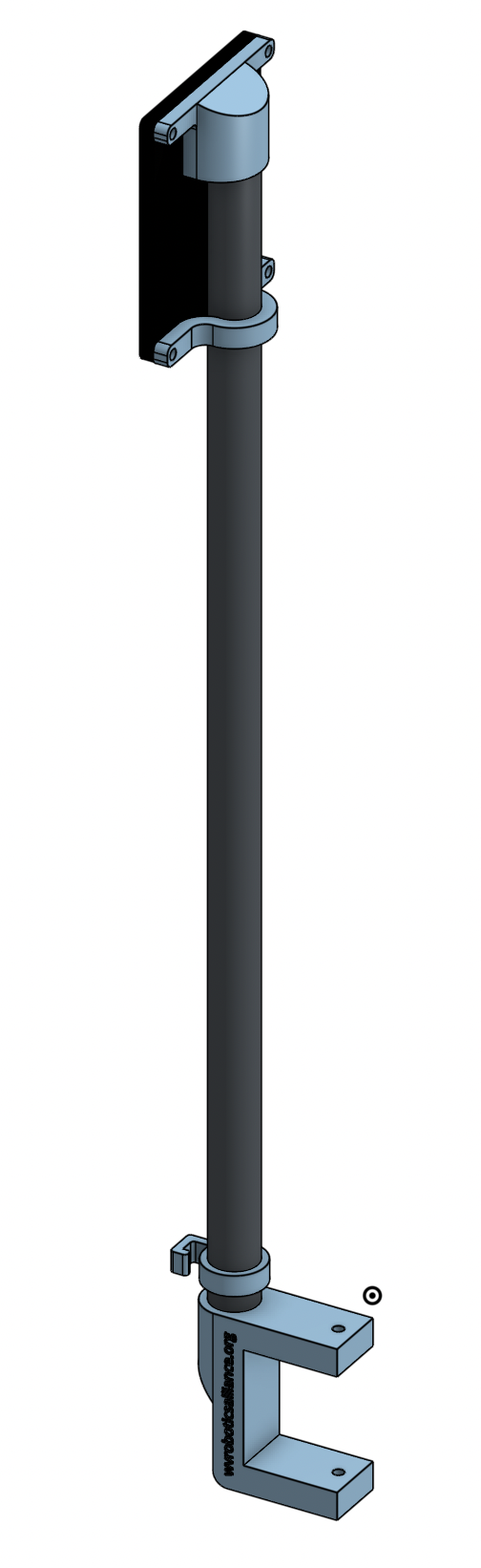

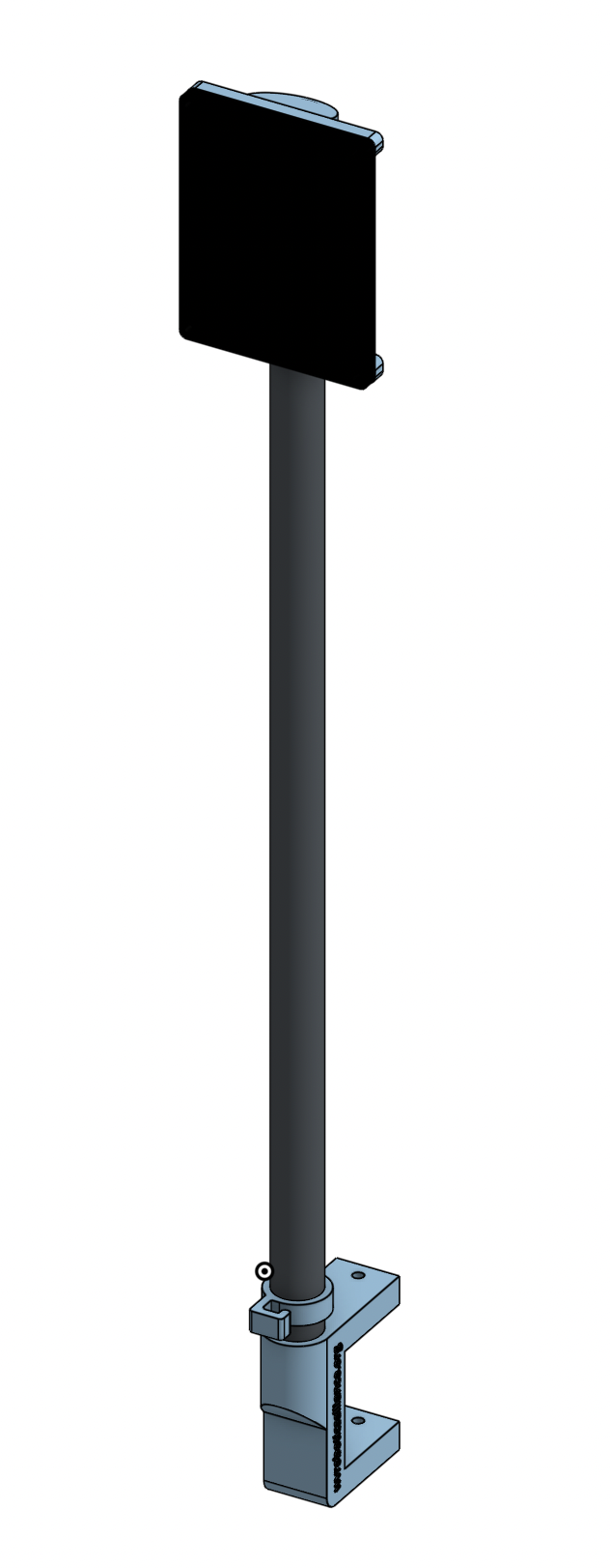

I mentioned a while ago that I was working on this project, now it’s done – the portable field perimeter doesn’t include any mount for the “driver interface” box in each driver station like the metal perimeter does, so I designed one.
More images
All the parts are 3D printed except for the 1/2" schedule 40 PVC pipe. Pipe of this size gets used in pretty much every VRC game, so you probably have some kicking around already. The length isn’t super critical but somewhere between 20 and 28 inches works well. We’re using pipes from the back of Change Up corner goals, which are 25.5 inches long.
Standard 8-32 hardware is used to mount the post to the field and the driver interface to the post. The mount to the perimeter is secured with a single 3" screw, which is longer than comes in any VEX kit (I think) but still a widely-available length.
STLs are up on Thingiverse:
And here’s a link to the Onshape project as well:

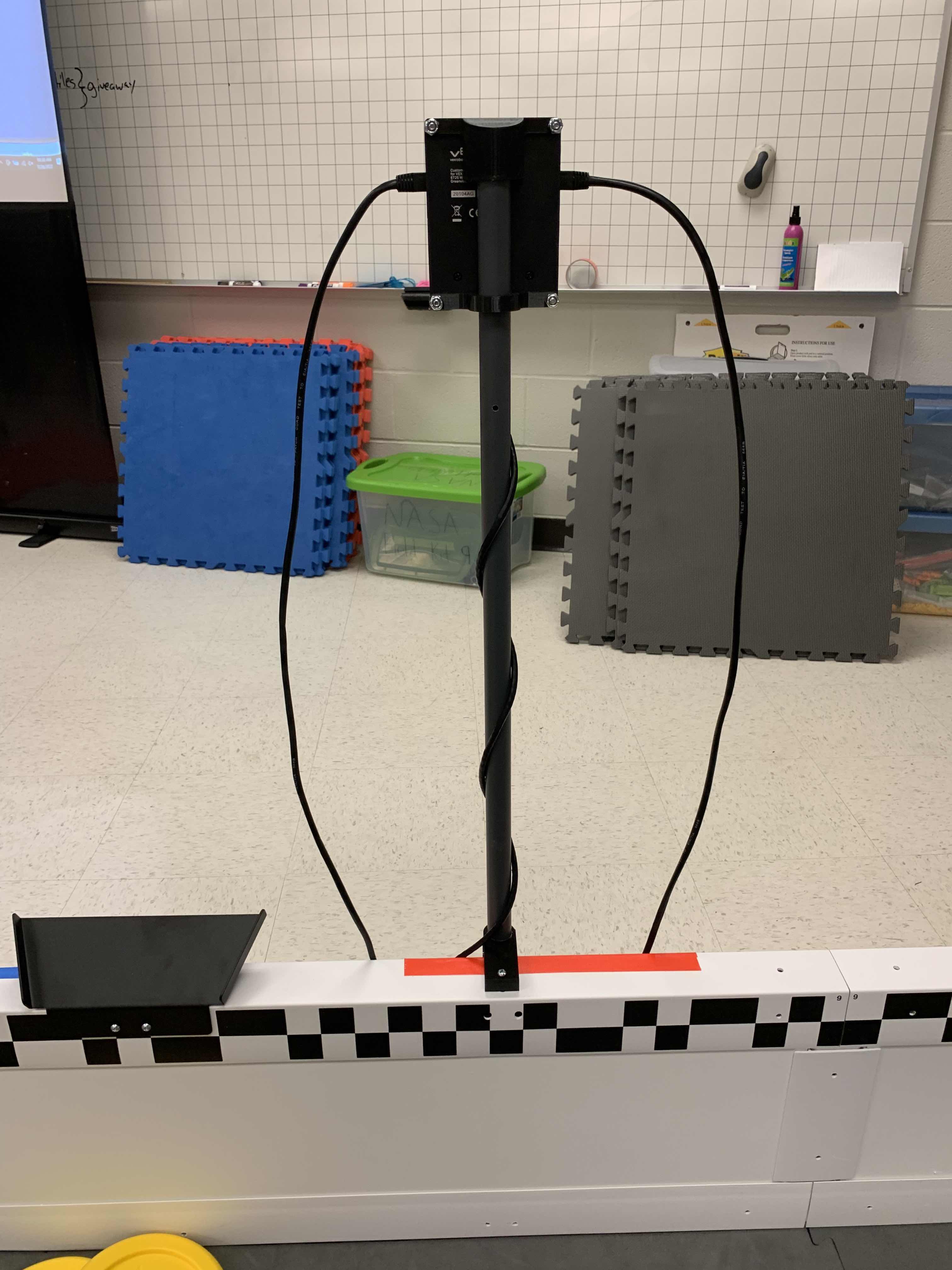

Next we need a V5 Field Control Driver station which would take the smart cables from the V5 Field Control and have an RJ 11 barrel for teams to plug into without destroying the smart cable at the end of match :slight_smile:
A cable storage hanger would be good, especially when using field risers.
I would use barrel connectors and have a short cable for the driver interface so if they break the cable, you do not have to rerun 8m back to the V5 Field Controller Brain.

There’s a second top cap which is a single piece and includes a couple hooks to stow the other ends of the short cables:

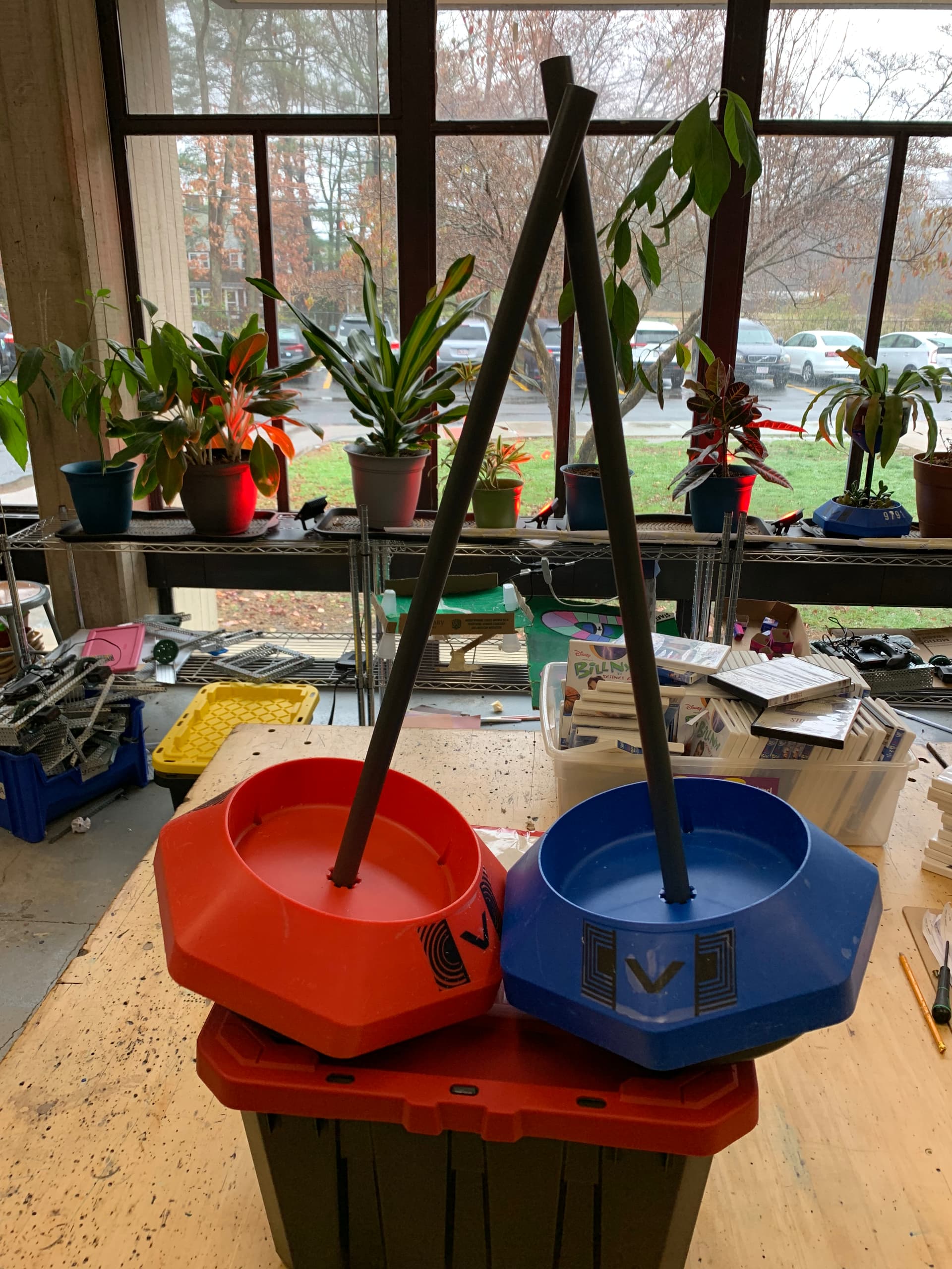

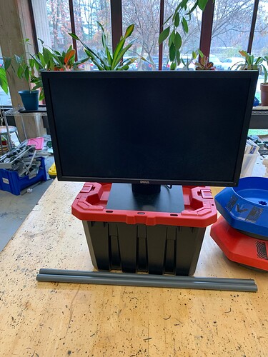

Although if our fields were elevated, I would probably just attach the driver interfaces directly to the outside of the perimeter.

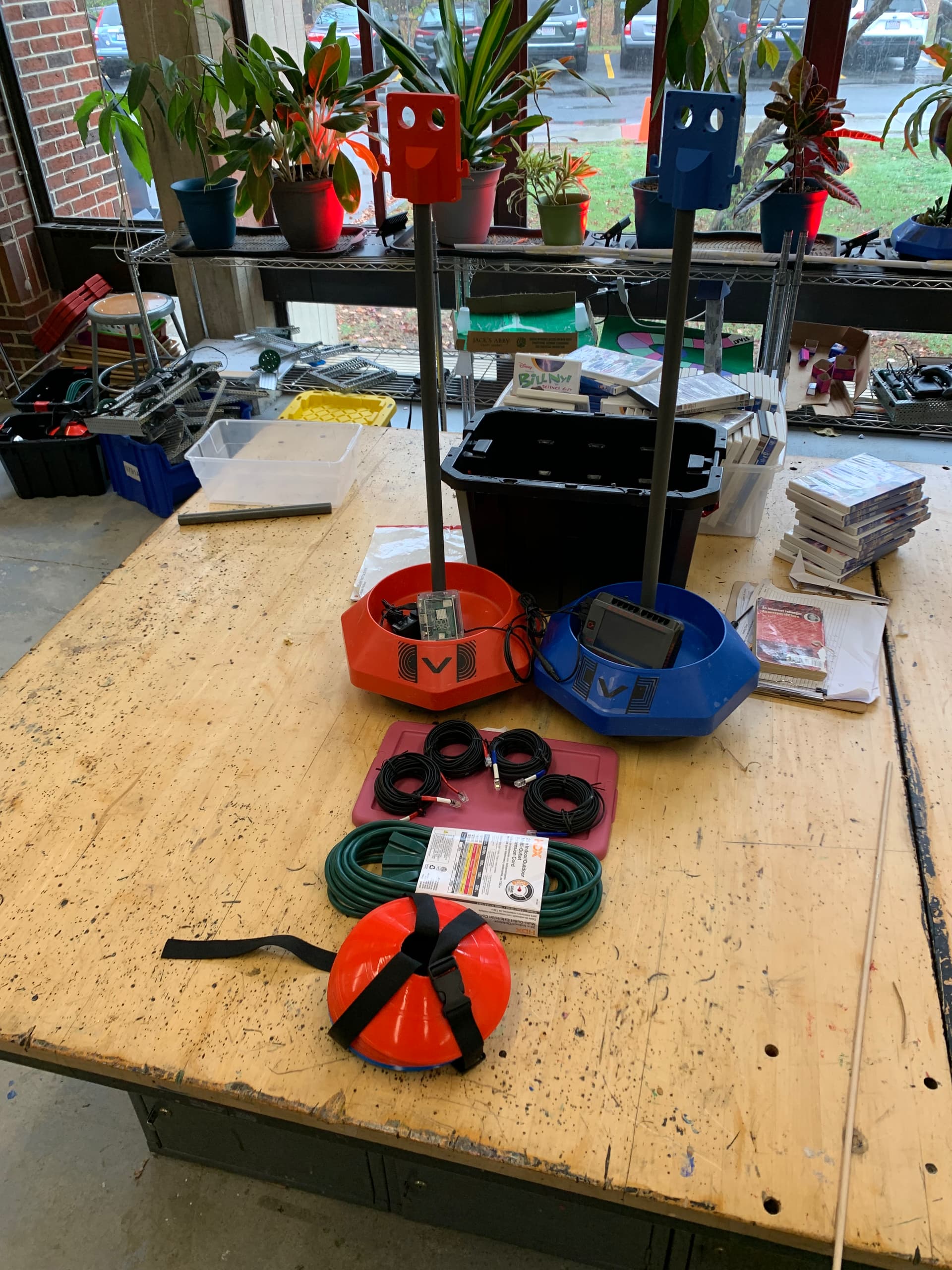

We did some mods to allow for passthrough RJ11 panel mount. Then we realized that you can just use tipping point mobile goals for base and not worry about mounting to field:
topFieldMount.stl (329.2 KB)
Here is our field kit:

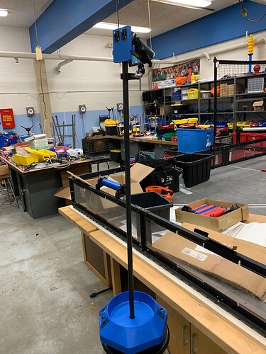

So the Drive Station posts worked well at last competition. This coming competition we added pass through RJ11 connectors for short driver cables (likely to break) and have the long cables to the V5 Brain protected.
For grins we mounted a camera on the pole - maybe an alliance station view of the game? Might try that this at this weekends events. Will also try mounting on the top of the field nets for dramatic disc shooting views!

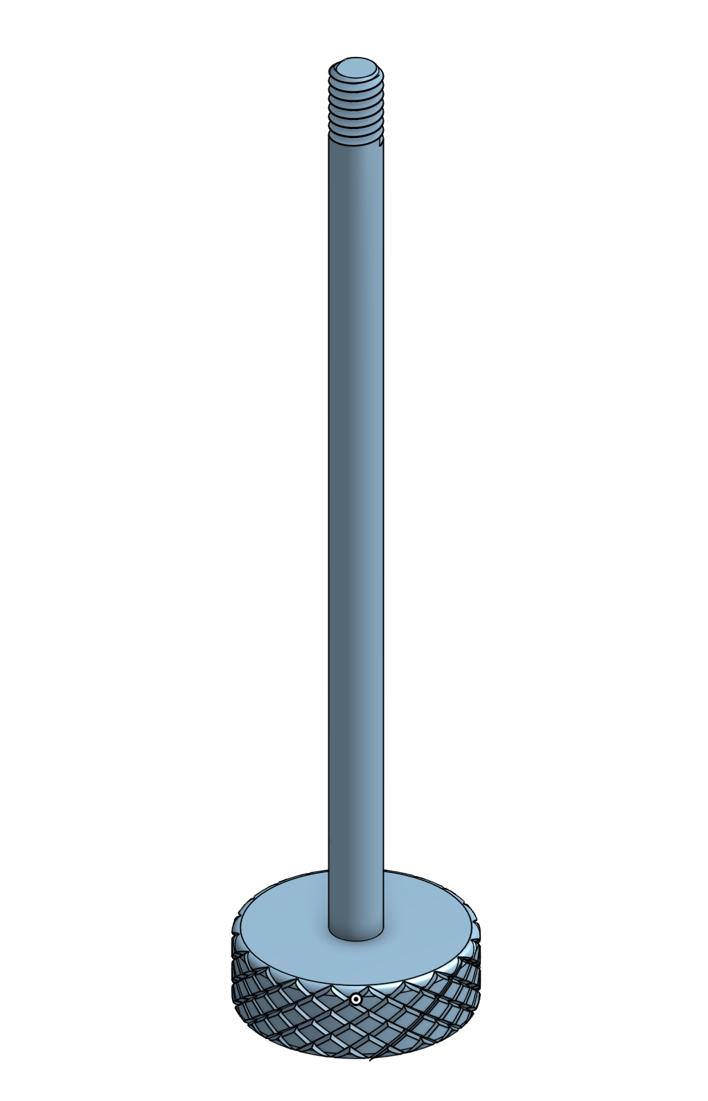

And while I’m here I actually have some updates on this project:
  1. I revised the “perimeter mount” to be a bit shorter – turns out the fit was kinda loose and I was making up for that by over-tightening the screw and bending the part.
  2. I designed a 3D printed thumbscrew which is the right length and has 8-32 threads on the end. I wasn’t really expecting 3D printed fine machine screw threads to work, but it actually turned out to work really well! I did have to to turn the layer height way down on the threads though.
(pro-tip: PrusaSlicer, and probably other slicers as well, will let you set different layer heights for different parts of the model, so the threaded part can be really fine without making the print time for a single screw too long. The bad news is, I learned this after I had run the 60-hour print job to make all the screws I needed. The good news is, that batch turned out to be slightly too short, so I had to print a whole new batch, on which I was able to use that optimization.)

I am concerned about anything that mounts to the perimeter that isn’t related to the game. As teams become more aggressive the perimeter takes a beating, and its more likely that a robot will hit a stanchion or snag a cable. I stopped mounting the screen five years ago and most EPs in my area don’t use the stanchions anymore.
