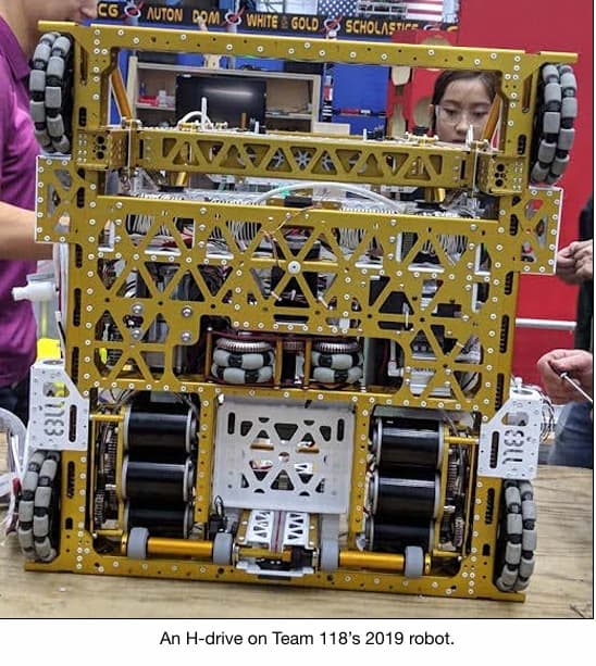

Here is a pictur of what I’m talking about on a FRC robot:
(I am biased tword H-drives, to take my two cents with two cents-worth of salt)
I think both H-drives and X-drives will be great for this game. Since you would need to use many half-motors for a 6m X-drive. I think H-drives will work well this year. Also, if you are using a change-up style robo like @9motorgang’s robot, you could fit a PTO in there and still have pleny of space for the blocks. If you are planning an a 4m drive, x-drives will be easier, but a 4m H-drive would let you designate a motor for the H-drive.
If you do use an H-drive, I would do it like this:

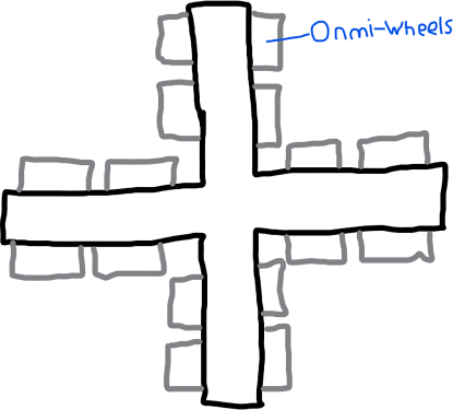

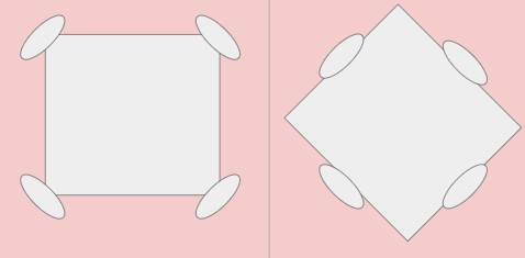

X drive, but oriented 45° to make it buildable without those horrid angles.
So personally i am not a builder. Is there any way you elanorate. That would be great.
I imagine it would be similar to a + shape instead an x shape
I can relate to your hatred of building angles :sob:
Why does something so painfully to build have to add so much strength
I think you could use 6 wheal X drive. Hear me out, if you have a standard X drive bot, and add 2 wheels in the middle, like 2/6 wheels from H drve, you should be able to get more traction, and have more front back power then a standered X drive.

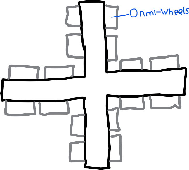

I would love to see how a drivetrain shaped like a + would work. I would appreciate if you were to explain your thoughts on a drive like this.
Also, welcome to the forum!
But in an x drive, all the motors are being used when the robot is pushing forward. In a plus shape, only half of the motors are pushing forward - hence why no one to my knowledge uses it.
I think the + shaped drivetrain would be a +, but with the wheels on the end. The configuration would be similar to X drive. At least that’s what I think

This is what I figured, but I was wondering if he was thinking of something, well… I don’t know… mabey this?
An X-drive, but better?
Like this:
