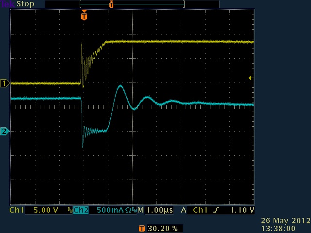

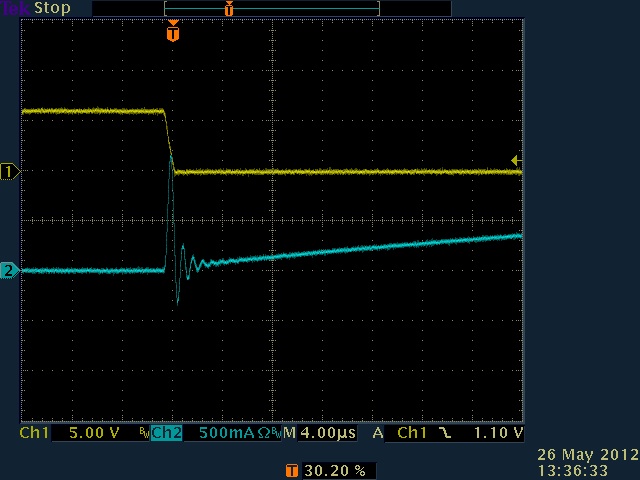

I had some time today so though I would capture some waveforms showing the actual current flow in a 269 motor. This thread seems as good as any to post them in and I post this just for information, not trying to draw any conclusions from these yet. The current was measured with a Tektronix TCP202 current probe which allows current measurement without breaking the motor circuit.
The first scope capture shows a 269 motor with the control value set around 32 with an unloaded motor. The motor was in port 10 on a cortex.
[ATTACH]6160[/ATTACH]
current to the motor flows when the drive voltage is pulled low as the other motor terminal is at battery voltage. When the drive voltage is turned off, the current continues to flow for a short period of time but does not reverse direction.
Here is the same motor running with control set to 64.
[ATTACH]6163[/ATTACH]
Finally, with the motor stalled and the same control value of 64.
[ATTACH]6166[/ATTACH]
Now all the current flow is positive with an average value somewhere around 1A (remember control was set for half speed).

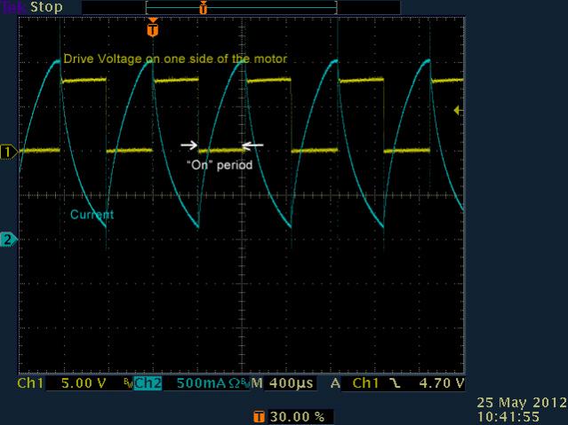

I want to explain some of what is happening in those graphs so that they aren’t totally confusing for 90% of people who look at them.
Inductors resist change in current by creating a voltage across the coil (an inductor is a coil of wire). Inductive flyback is caused by a motor (which acts as an inductor) when there is a sudden drop in the voltage supplied to it (across it).
Back emf is caused by a turning motor.
Imagine a circuit with a motor and a Cortex (and resistance in each). The Cortex creates a voltage across the motor (let’s say the voltage drops as you move clockwise around the circuit through the motor). The current supplied by the Cortex (the battery) is in the clockwise direction (positive).
This is what you see during the “On” period on the voltage trace below.
When you cut power to the motor, the voltage across the Cortex drops instantaneously to zero. But because the motor acts as an inductor, there is still current moving clockwise around the circuit (as seen on the current trace) even after the power is cut. In order to keep the current from dropping instantaneously (remember the motor resists change in current because it acts as an inductor), the motor creates a voltage increase as you move clockwise through the motor. This voltage is opposite the voltage that the Cortex created (until power was cut), which is where the inductive flyback comes from. You can see the inductive flyback on the voltage trace where the voltage goes above the zero line while the current is still positive.
[attach]6178[/attach]
Now what about the back emf?
As you can see by the voltage trace in the diagram above, the voltage across the motor is not zero when the Cortex is supplying no power to the motor (between “On” periods). Because the motor is still turning, there is a voltage increase created by the motor as you move counter-clockwise around the circuit through the motor. This would normally cause the current to move in a counter-clockwise direction, but there are diodes which (I would assume) prevent that from happening.
I think the current keeps dropping a little below zero because of the capacitance of the diodes, but I’m not sure on this one. Anyone more knowledgeable than myself have ideas on this?
The negative current appears to last for about 100μs at an average current of about 40mA, putting the charge of the capacitor at 4μC. It looks like the voltage decreases a maximum of .5V (it’s really hard to tell) as the capacitor discharges, putting the capacitance of the diode at a minimum of 2μF, which is way more than any diode, so just ignore this and the last paragraph. The negative current must be an artifact of the probe or the display or something.
On a related note, the non-linear increase in current during the “On” period is caused by the motor resisting a change in current (by charging the inductor) while the voltage is held constant. If there were no inductor (motor) in the circuit, the current would increase instantaneously when the voltage increases.
When the motor is stalled, there is no back emf (the motor is not turning), so we get a very nice look at the inductive effect of the motor:
[attach]6181[/attach]

This first trace shows the same as I posted a few days ago. The control voltage is in yellow, the motor current is in blue. Current slowly climbs during the period when power is applied and drops when it is removed.
[ATTACH]6199[/ATTACH]

Looking at the current change at the power turn on point we see lots of ringing on the current waveform.
[ATTACH]6205[/ATTACH]
And here is the power turn off point.
[ATTACH]6208[/ATTACH]
The ferrite beads on the motor wires are probably there to reduce this type of ringing.
