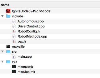

I tried deleting the build file, but it only recompiles main.cpp, it doesn’t compile the other included files. Is it possible that the other files are not included in the filechecker and only updates when the file is renamed?

source code (.cpp) should be in the “src” folder, header files (.h) should be in the “include” folder.
The root cause of the problem that @ceak had was project structure, .cpp files should only live in the src folder, they should not be treated like headers and included in other .cpp files. Lets look a bit at the infamous makefile and explain what it does. The makefile and other related build files are hidden by default in a new VEXcode installation, they can be shown by checking “show build files” in the preferences panel.

This was the original project structure that the OP had.
The file Autonomous.cpp, as an example, would not be compiled and also not used as a dependancy of other source files as it does not have a .h extension (ie. it’s not a header file). These files should live in the src folder and not be treated like headers and included in other .cpp files.

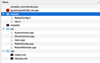

This is a revised project structure that plays nicely with our default makefile.
one new file was added that has global motor and other vex class instances.
