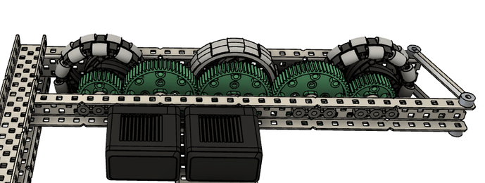

So I was trying to design a geared tank drive based off of this one, but including a center traction wheel. So I came up with this:

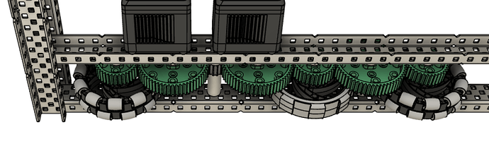

However, the main issue with this is that the traction wheel would not spinning at the same speed as the other wheels. So I came up with this:
With this one, though, the traction wheel is way off center, which isn’t very good. Would it be okay to use the design from the first picture, but just use a free spinning insert on the middle traction wheel, so that it isn’t powered?
that would be just fine. The wheel will of course not be powered if it’s free spinning, but that isn’t an issue unless you need to go over a bump or something. But that’s game-dependent, on a flat field you should be fine.
One thing you will need to look out for with that first design is that one of those motors is going to have it’s port facing inwards, and you’re not gonna be able to fit the cable in there with those motors so close.
Oooh, thanks, I never would have caught that!
Motors in that configuration can actually fit a cable between. As long as you either have quickswap on all your motors or mount the motor in with the cable already attached you should be fine.
wow really? seems like you would have to bend the cable at an unhealthy angle, and that’s only if the cable connector itself fits. But I’ve never tried to put motors like that so if it does work then I guess its not a problem.
One additional thing to consider when building a drivetrain is a conversion of weight of the robot into pushing force through the friction.
If all wheels are powered, then the full weight of the robot gets converted into pulling or pushing force through the friction coefficient specific to the wheel type and surface that it is driving on.
However, if free spinning wheels support portion of the weight, then it reduces the maximum force that is available to accelerate, push, or resist pushing of the robot.
(See this topic for more details)
As far as the placing of the wheels is concerned: if the robot’s center of mass coincides with the geometric center between traction wheels, then driving is going to be smooth and predictable.
It doesn’t matter if omnis are not the same distance from the center - you will be fine as long as all powered wheels on each drive side are aligned on the same line and have the same surface speed.
It is very easy to prove with a simple geometry of the velocity vectors, but I cannot find an illustration at the moment. Please, beat me to posting one.
do 36 - 60 - 36 - 60 - 36 and place the wheels coaxial with the 36t gears?
Or you can try out 60 - 36 - 60 - 36 - 60 on 600rpm motors, and place the 3.25" wheels with the 60t. This will be 360 rpm (close to 333). It has the same number of each gear (same track length), and have less slop since you’re gearing up
