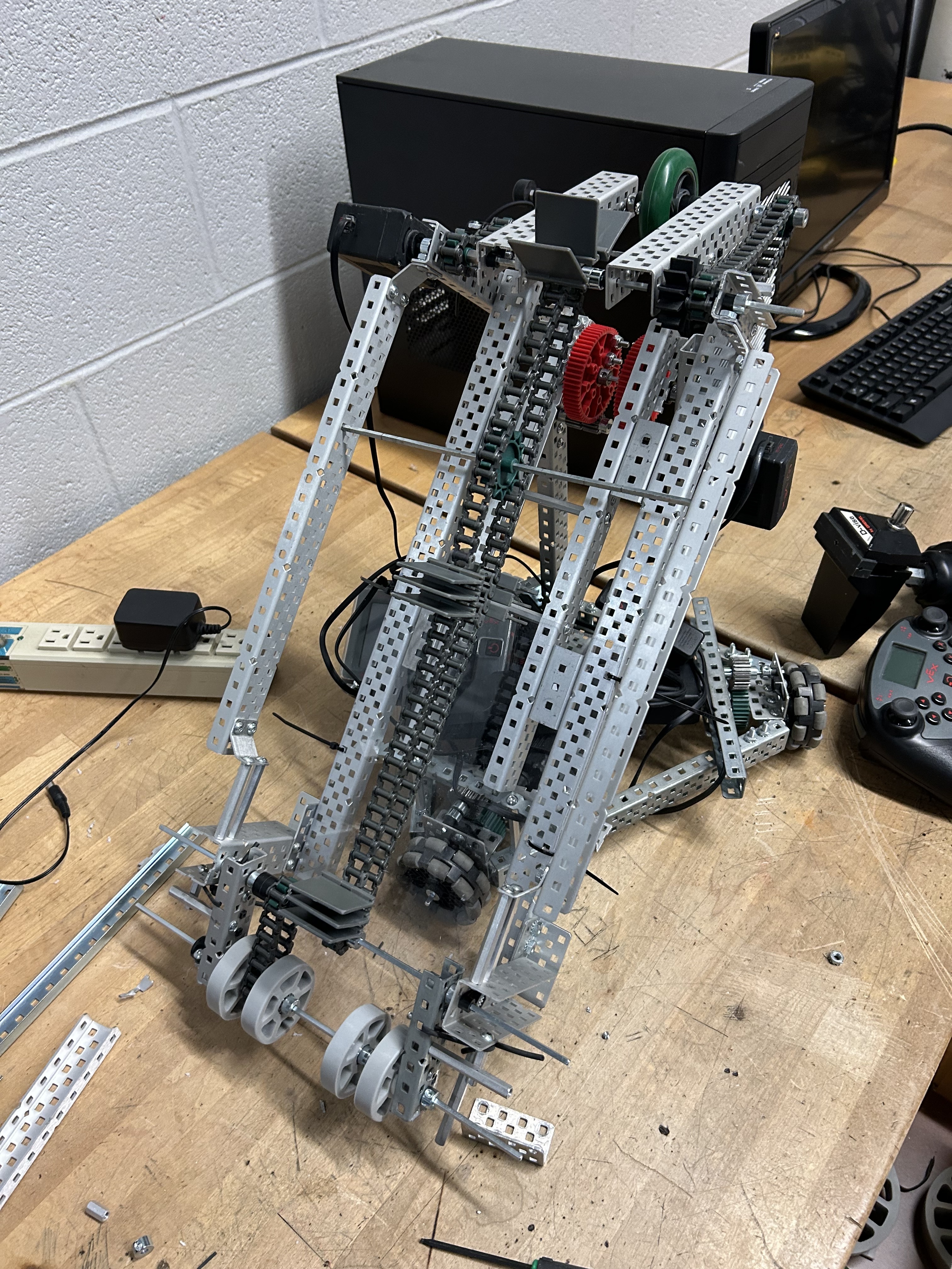

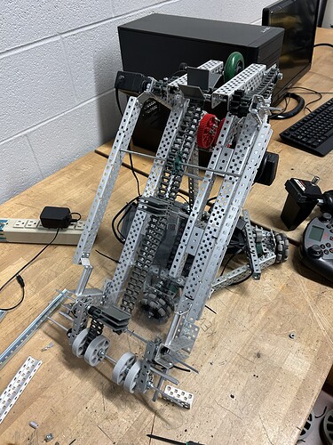

idk what a ladybrown system is, but mine just has the conveyor itself on an arm.

I currently have a hood intake that is on an arm that can lift up to reach the wall stakes but making plans on either switching to a lady brown hook intake or staying with a hood and trying to make a lady brown work with it. The only reason I don’t consider fish mech is because I believe that lady brown has more potential to be able to score 2 rings at a time where fish mech is limited to 1 by design.
