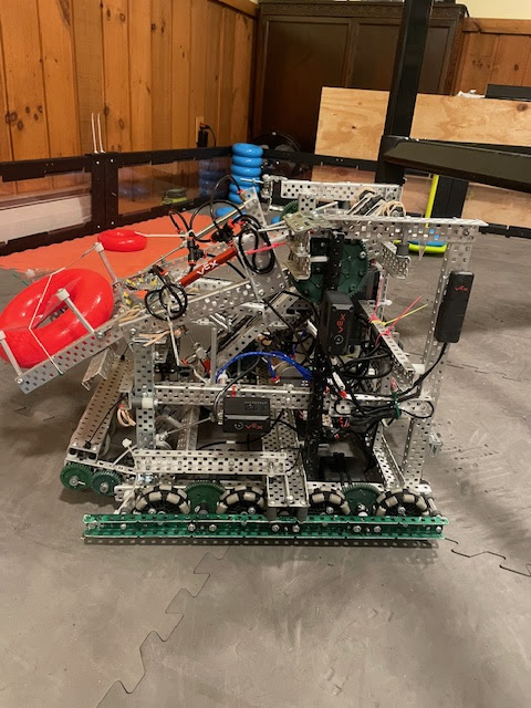

Do we have to use flex wheels intake for hood? My team is doing hood but we don’t have any flex wheels and we don’t want to build a 1st stage intake.
You don’t need to use flex wheels but they are the best overall. An alternative would be a rubber band intake or running tank treads the entire lengthy of the intake.

yes, this is what the team i’m on did (our actual competition robot, not the kiwi drive thing):
the wheels made it slightly faster but weren’t needed.
Not on topic but can you tell me how you put C-channels directly on top of the C-channels on the drivetrain?
I just used screws. :slight_smile: But seriously I used a 0.5 in spacer in between my channel pieces for gearing spacing but otherwise i just put a screw going through each channel and put a lock nut on there to keep it secure.
