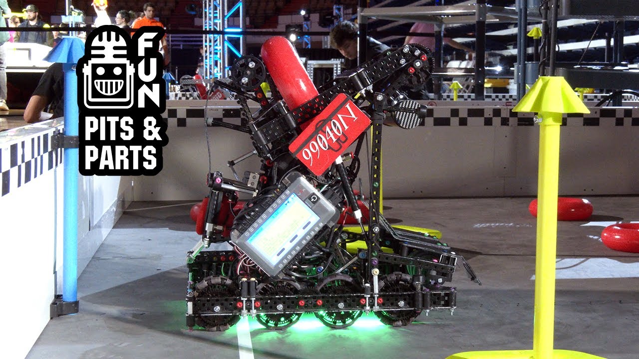

Have you seen 3 chain hooks? First saw them on 1095r
If you’re talking about Post 77
I see two small chains connecting flex wheels to hook chain.
But what I mean is that the chain that the hooks are on might break
I’ve never actually gotten a broken chain though (double chain flap hood, horrible robot)
I’ve done both flaps is much faster
Not the flex wheel to hooks, some teams have taken the tank tread and made basically that hook track ran by 3 chains
Notebookers also has it
