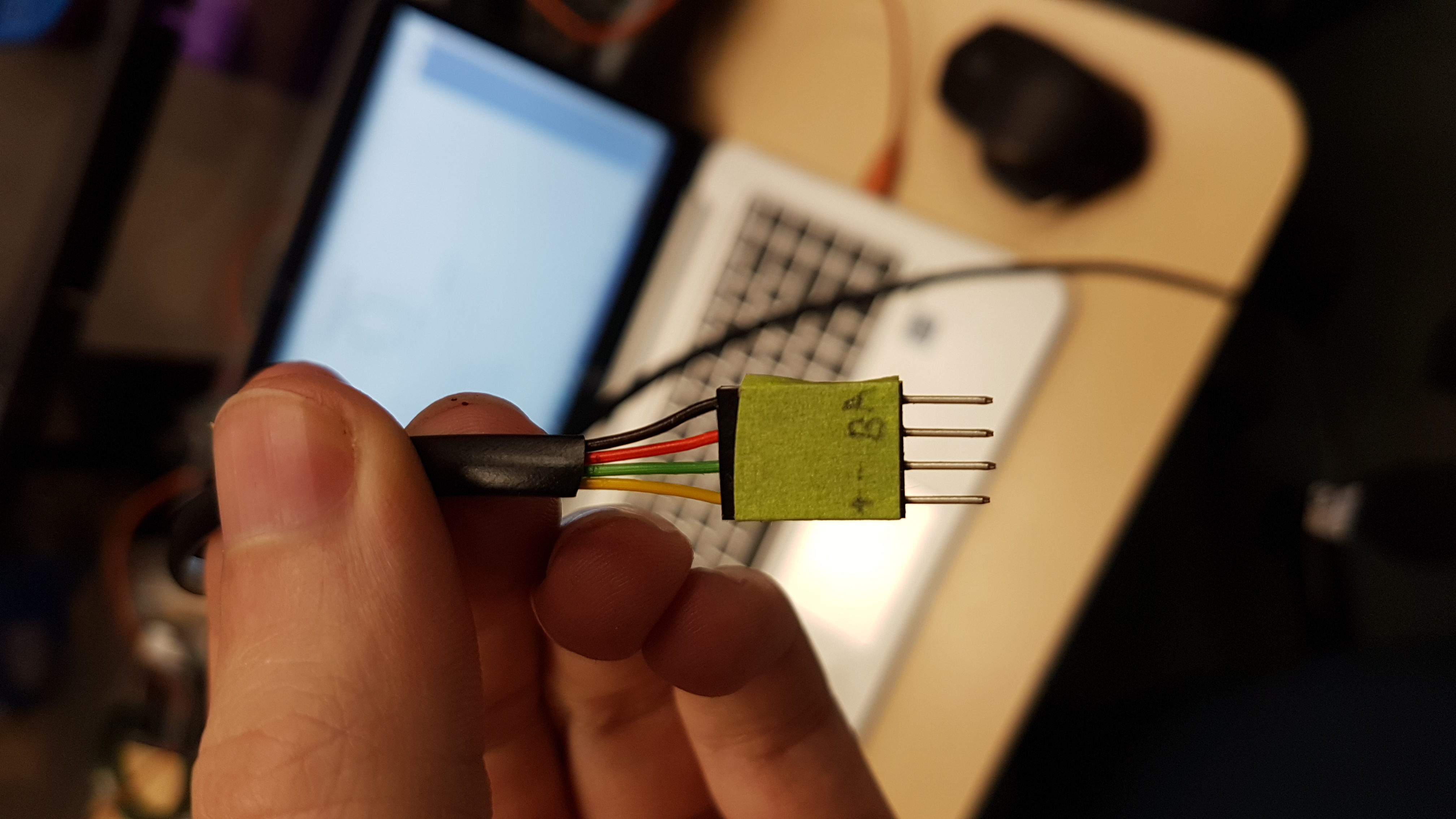

You can also do a wired connection between brains by making a port a generic serial controller and connecting the brains with a smart cable
You can, also VEXlink can be used wired.
It’s best to use a custom cable if you do this with the power wire disconnected.
How exactly do I mod the smart cable? I cut the red wire assuming it was the power wire (wasn’t sure there was zero documentation on the color codes of the wires in the smart cable). I then copied and pasted the program for the wired connection from the document shared before, assigned the rolls and port numbers appropriately, and the brains won’t connect. Did I cut the wrong wire? Was there something I missed?
VEX has not officially released the pinout for the V5 smart ports. Some community members have reverse engineered it, I’ve linked one example below, just be aware that there is always the possibility that some smart cables may not have exactly the same wire colors, the cables are straight through (ie. both ends wired the same) and there’s a chance that some may have black and yellow wires reversed, especially if they were customer made.

I also cut the yellow wire and its running fine so far! Thanks for the help i’m supper happy this is working now!
