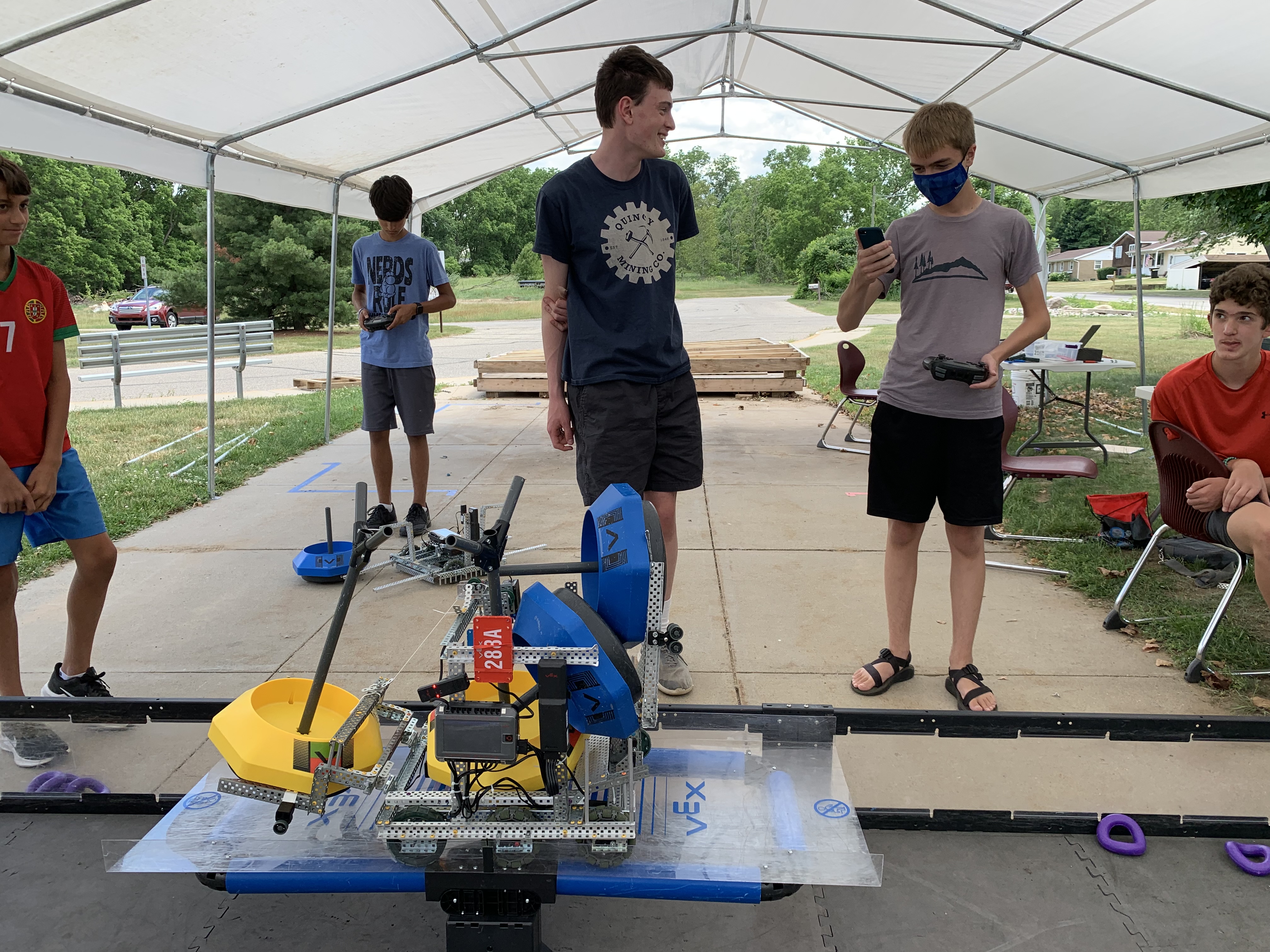

Two days into our day camp and one team already gets four goals (two of theirs and the two small neutral goals) and parks on the ramp - almost every time.
You are right, it’s not unbeatable, but it’s close. especially with a partner that just tips over the big neutral goal (easy to do) and is just a pest to the others.
Not perfect, but pretty hard to beat.
I’m genuinely curious how they do this, any chance we could see the particular robot?
surprised someone’s done it this early into the season, and it’s probably a very effective strategy this early, although I expect if they went up against a really good versitile robot alliance later in the season they would be defeated.
How long does it take them to grab the goals?
Why is that smart and dumb at the same time lol.
