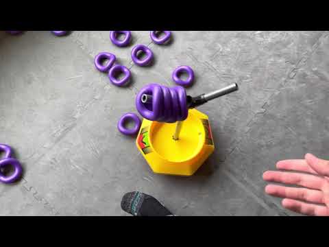

That looks really cool! I would really recommend trying a ringle mechanism to put a couple rings on one of those goals. If you can do that, or have your ally put ringles onto a goal before you pick it up in the endgame, that would be tough to beat!
