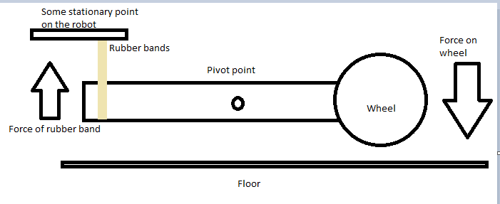

you mount your wheels on a pivot, and rubber band them into the ground.
One way you could go about doing this would be to have the odometry wheel mounted on an arm with a joint connected to the robot. You could either just let gravity press the wheel in the ground or you could have a rubber band past the pivot point to press the wheel into the ground
How would you go about rubber banding them into the ground? Thanks for the reply.
Thanks! I’m wondering how you would go about rubber banding them into the ground.

Here is a poor MS Paint drawing of how it may work
Sorry, but I don’t have CAD skills
This is a very helpful drawing. Thanks!
That’s really helpful! Thanks!
