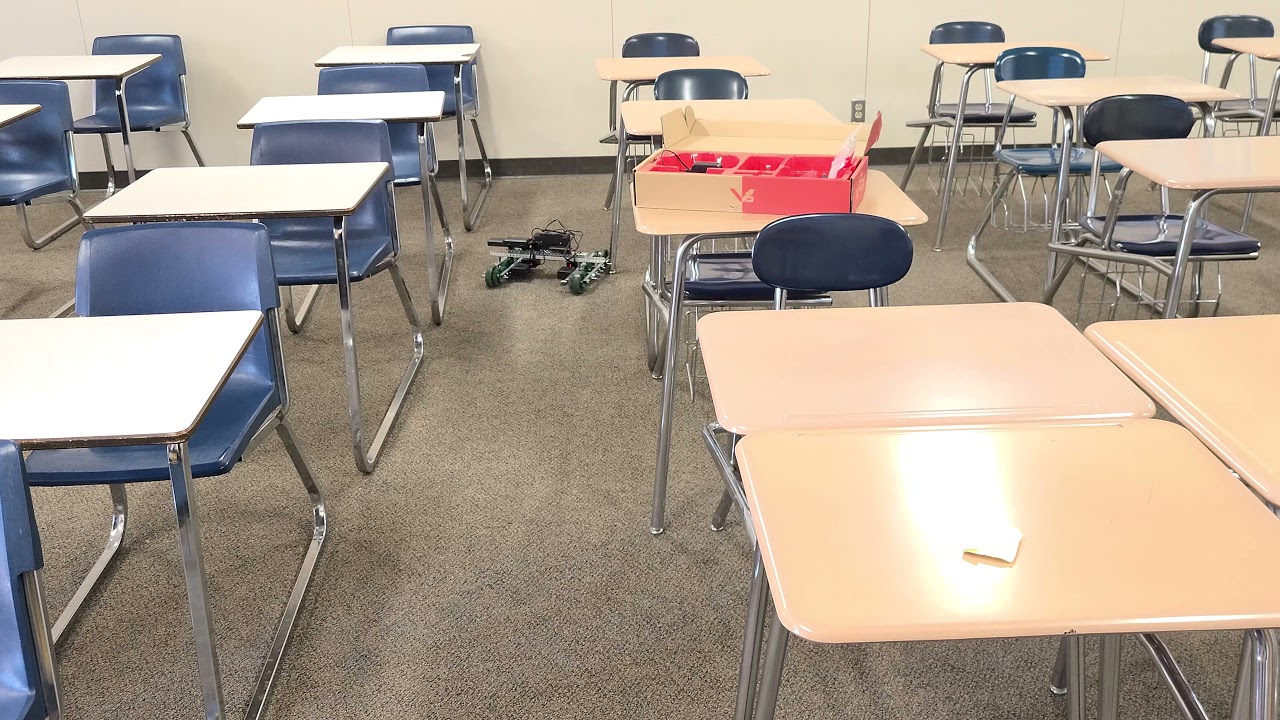

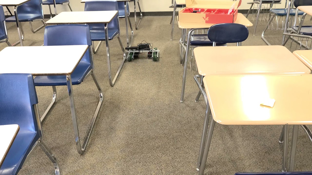

This is the video of our drivetrain.
I saw some issues and fixed the spacing.
I also make sure that the bearing flats were aligned.
Even so, there is still some slight drift to the robot.
Longer video: Vex Tipping Point Drivetrainrivetrain Test #3 - YouTube
Here’s a list of stuff to consider.
You’re driving on a carpet, and the pile of a carpet is never perfectly vertical, so that will bias your path.
A parallel omniwheel drive has no lateral constraint so it will surrender to the tiniest whim of a carpet or undulating surface.
You’ve got a big heavy battery hanging off out in space so it has the maximum possible moment of intertia, so setting off swiftly an turning will be resisted in a way that causes the carpet pile to squish to accommodate the attempted change. All sorts of things will happen on the scale of a wheel’s contact patch and depth of carpet pile that you don’t want. Certainly I would expect a yaw to the battery side on sharp takeoff or braking.
You’re piloting it in tank mode, so you are unlikely to perfectly synchronize pushing the sticks forward, so that could introduce further initial veering to one side, and the lateral component of that momentum will last some period till it’s lost in friction and deformation of the carpet. I would guess mostly carpet and not long, but you could see how far the robot will drift if you just push it to the side by hand.
Driving on a hard floor or competition tiles would remove any pile direction problem, but be aware of undulation of the surface.
Coding arcade drive would allow you to reliably express an intent to drive straight ahead from the start.
You have no control over going sideways other than initiating skids - no stopping power. During auton you are subject to variations in the level of the field surface, which may be comparable with the carpet or worse. Whilte driving, you’ll have to be ready for someone who would prefer you to be further to the left or right.
Enough from me.

Your robot is is balncing and put the tires on the outside of the c chancels.
Are you really telling them to put wheels on the outside of the c-channel? We ain’t trying to have camber here lmao
Also, lets assume you set the velocity to a number. What is really happening is the motors are trying to keep spinning at that velocity by modulating the voltage applied to the motor. It is reactive, so if there is a sudden decrease in velocity due to the carpet, friction, whatever, then there will be a short moment that one motor is faster than the other. That is, until the other can catch back up in speed, but the difference will already have caused the robot to turn slightly.
This idea also applies during acceleration. If one side has more friction or inertia than the other, then it will cause that side to take slightly longer to reach the desired velocity, and a small turn will be imparted in its motion.
So between inertia, resistive forces, motor strengths, build quality, tank drive, and more, there are tons of reasons that the robot would not drive straight.
Slightly reducing maximum speed and using an inertial meter and a PID might sure that up some, but trial+error and arcade style sticks should take care of most of it. Identify when the bias is introduced and fix it, and make sure you test exclusively on foam tiles.
