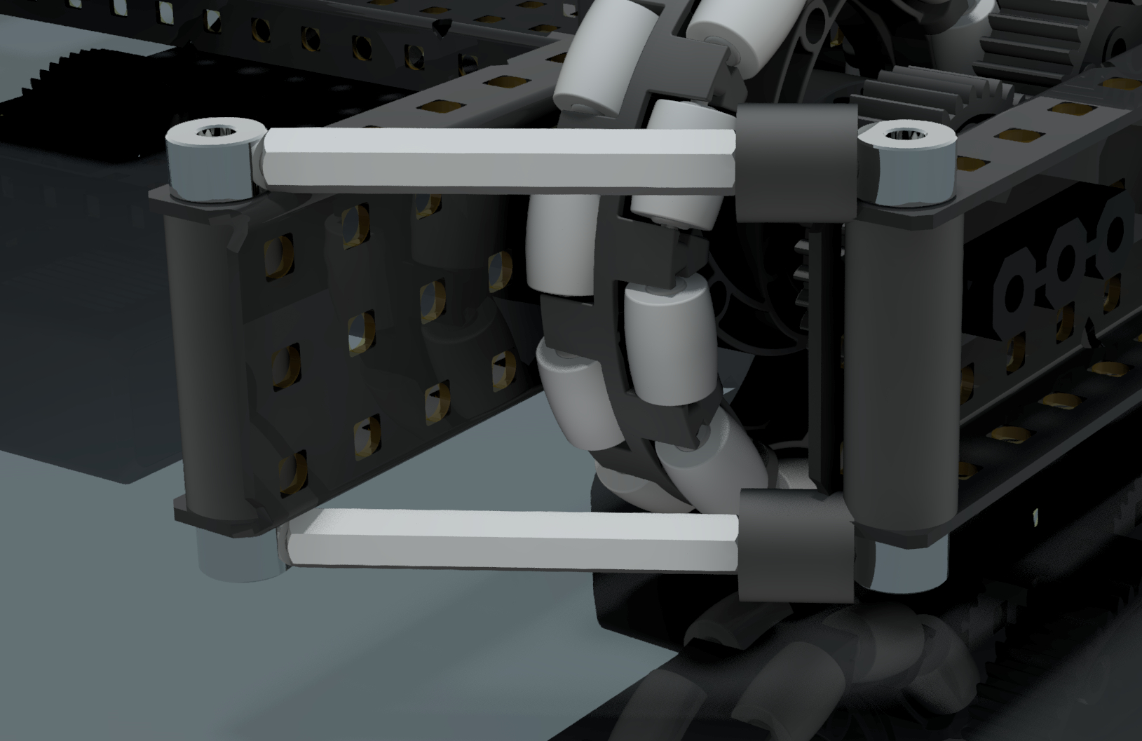

Using box bolting is a really powerful technique that makes the connection of pieces incredibly rigid for very little added weight.
in the above image, you can see how box bolts work, basically its just putting a long screw all the way through the c channel and filling it with spacers. This should be used wherever you can tbh, it’s such an effective building technique.
In general, just make sure to brace all the parts of your robot together in a way that the whole thing may as well be one solid piece. If you find that it’s floppy, flexy, bendy, or even a bit wobbly then something isn’t build right.
