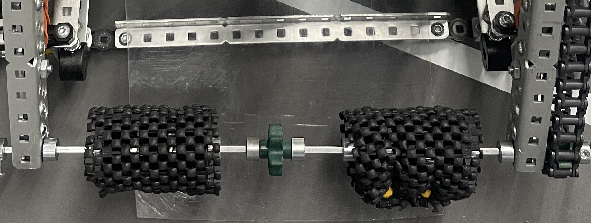

My team when we were waiting for flex wheels wrapped the intake rollers with the grippy fabric.
Woah. That… is… Not something I had thought of.
Make sure that the mesh that you use is legal. I almost didn’t pass inspections at worlds because my coaches bought similar, but not identical mesh.
