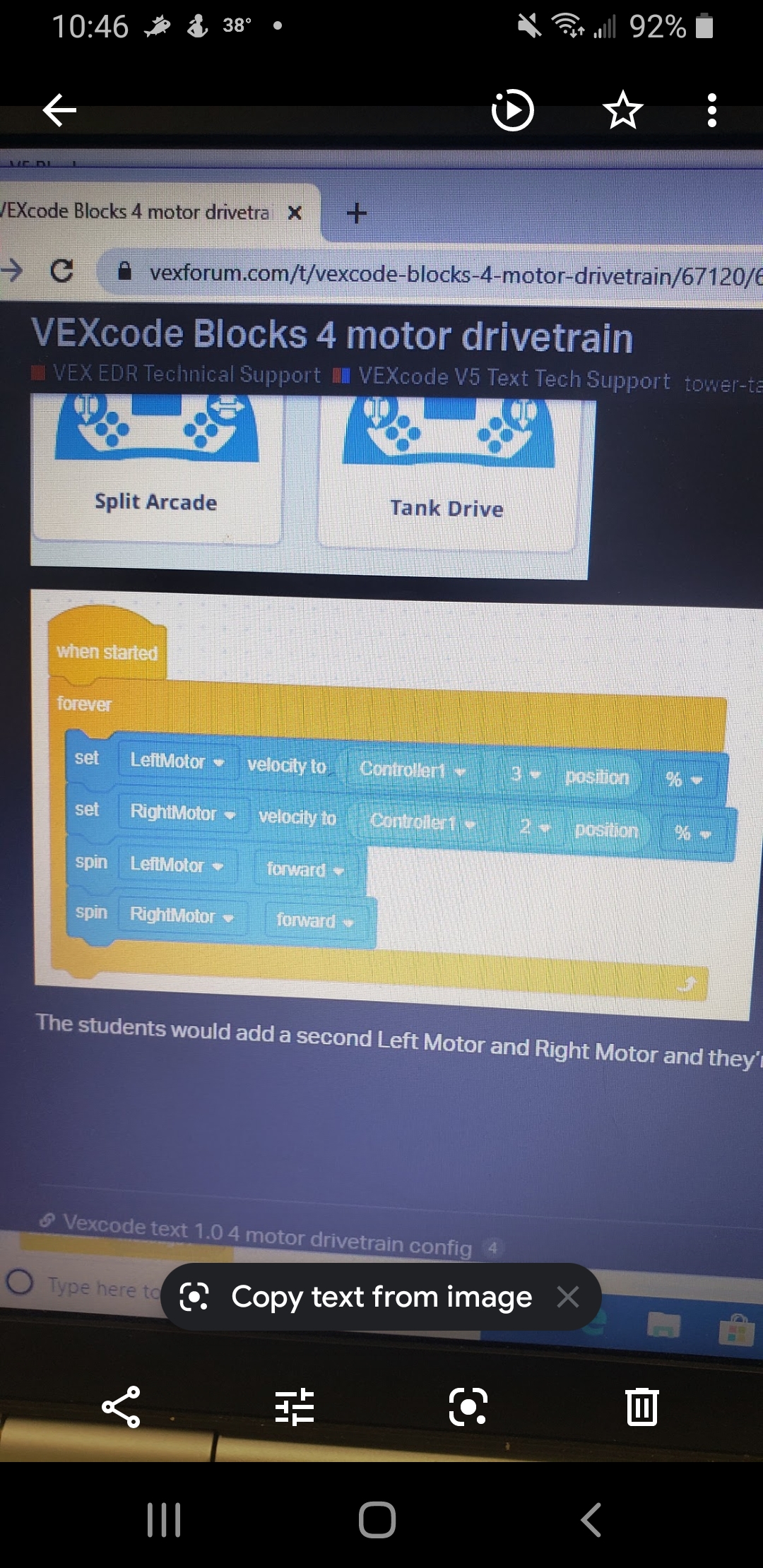

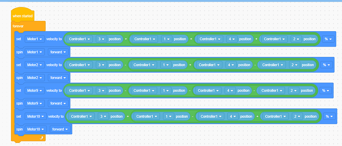

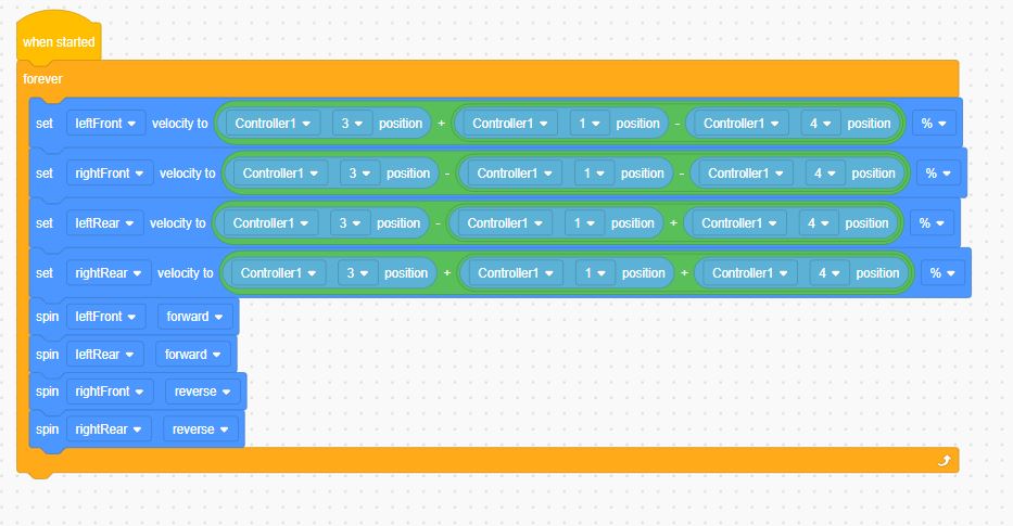

I am trying to figure out how the block code works with Mecanum wheels. We currently have a drivetrain set up and can’t figure out how to drive each motor on its own.
How do I make it go forward and backwards straight
