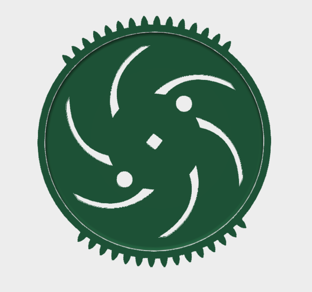

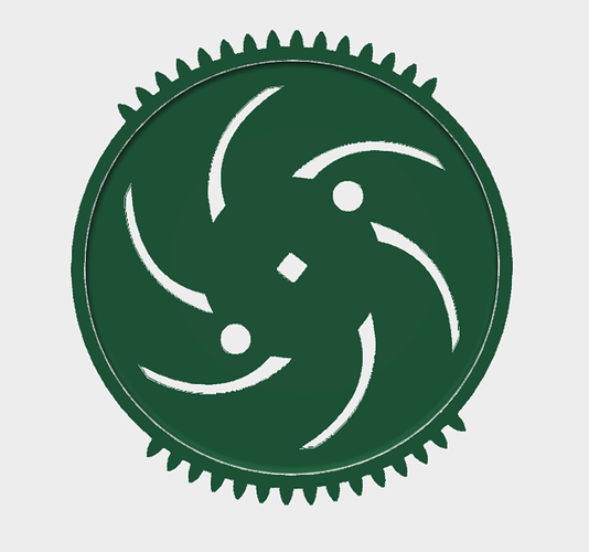

Is this gear you used commercially available? or was it 3d printed/sanded out?
That looks like a low strength gear that has had some teeth cut off to make it into a cam.
Welcome to the forum.
This is a 60t gear that I removed the teeth off of to make a slip gear. You can remove the teeth in whatever way you wish, whether that be a belt sander, a good pair of snips, a file, or sandpaper.
