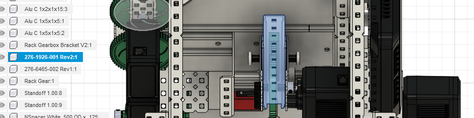

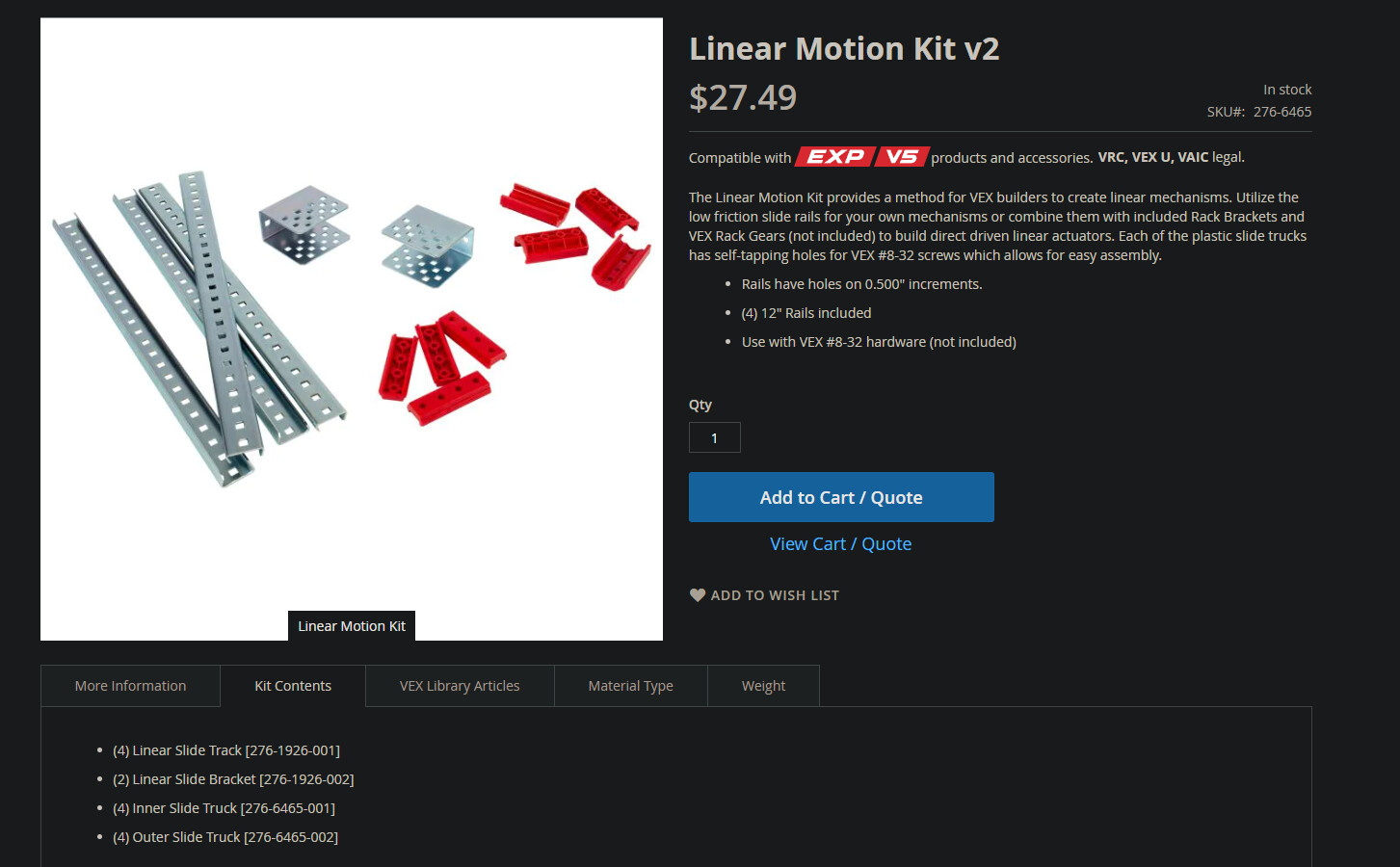

What are parts “276-6465-002 Rev1” and “276-1926-001 Rev2”?
try looking at vex v5 store and searching for the part number. then, click on whatever pops up and try to match the part numbers.
