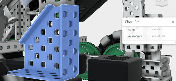

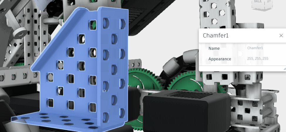

can i get all the measurements for the polycarbonate plates like all the angles and length and width
All polycarbonate used on this robot came from the VRC Change Up field. Either consult Appendix A of the Game Manual for that season, or the CAD file of this robot for the appropriate measurements.
Read the entire topic first, then ask questions. Many of the posts in this thread have already answered this question.
I need the exact measurements for the 4 polycarbonate pieces not how big the total plastic sheet needs to be
like all the angles the pieces are bent where the cuts are and screwholes
You can check in the cad for the sizes and angles of polycarb. If you for some reason can’t open the cad, you can always just eyeball it.

where can i find this piece
