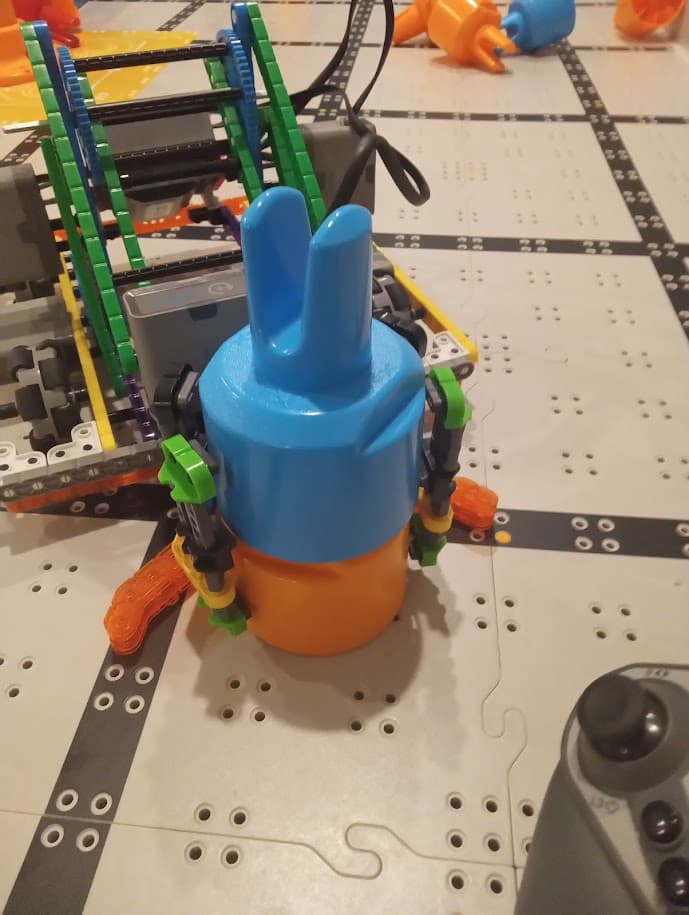

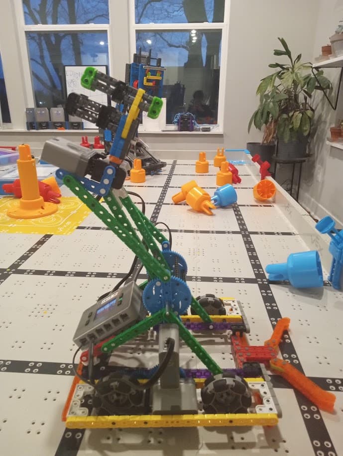

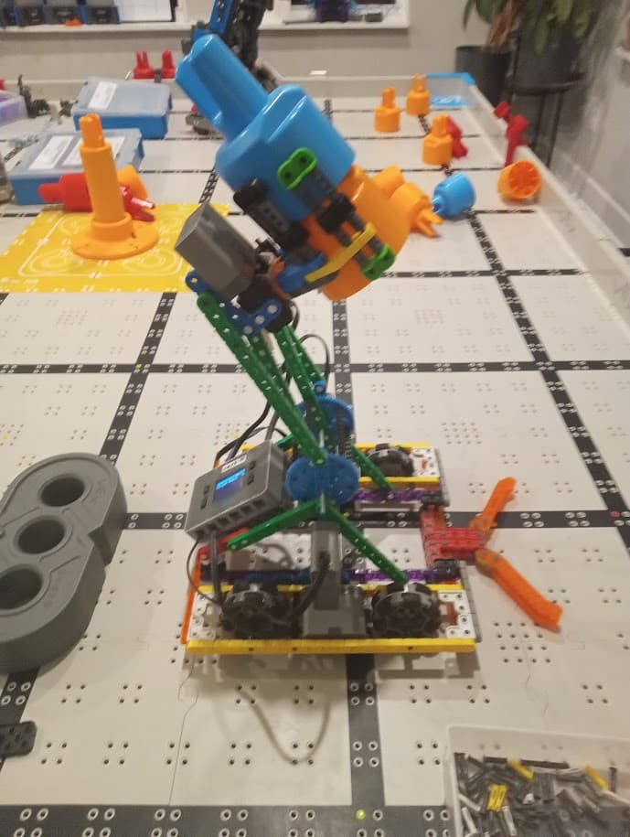

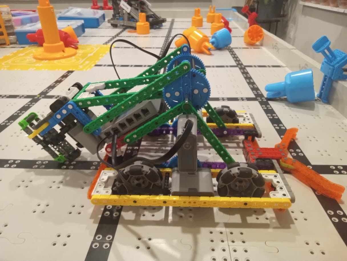

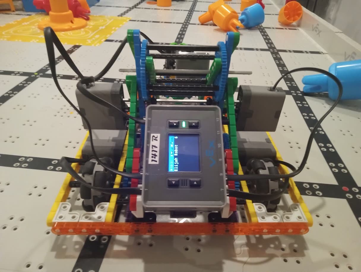

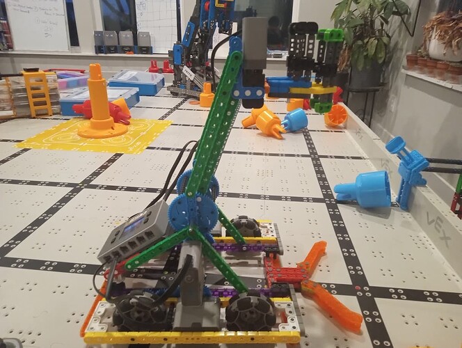

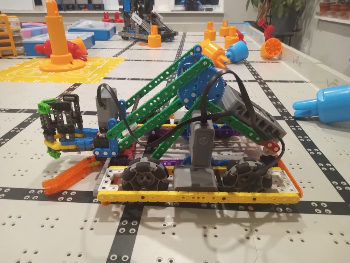

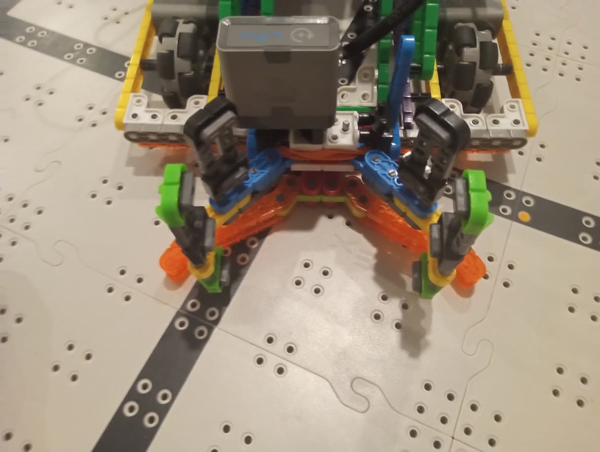

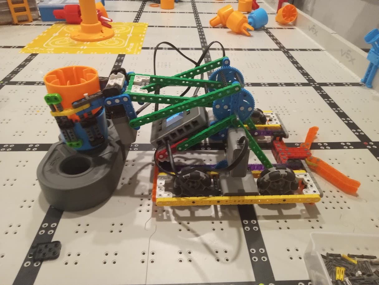

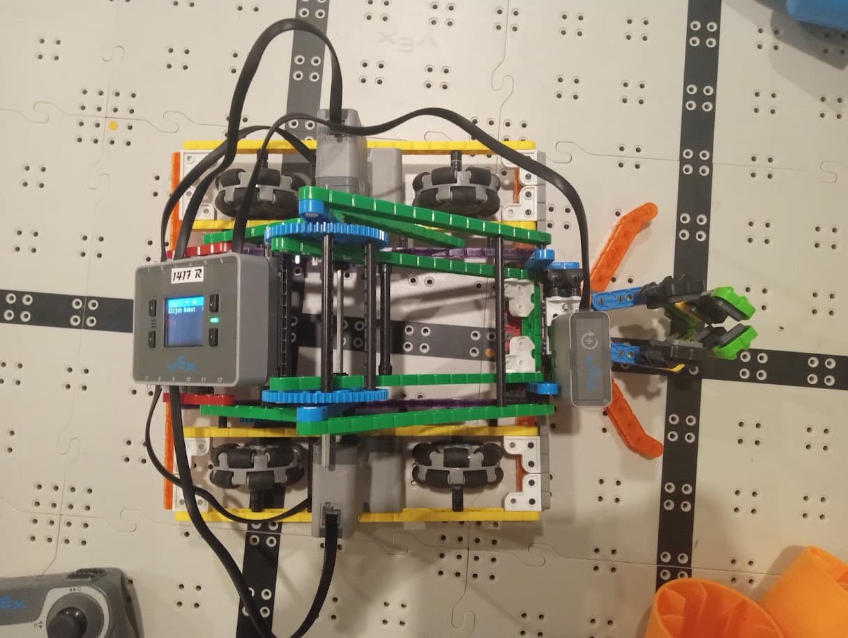

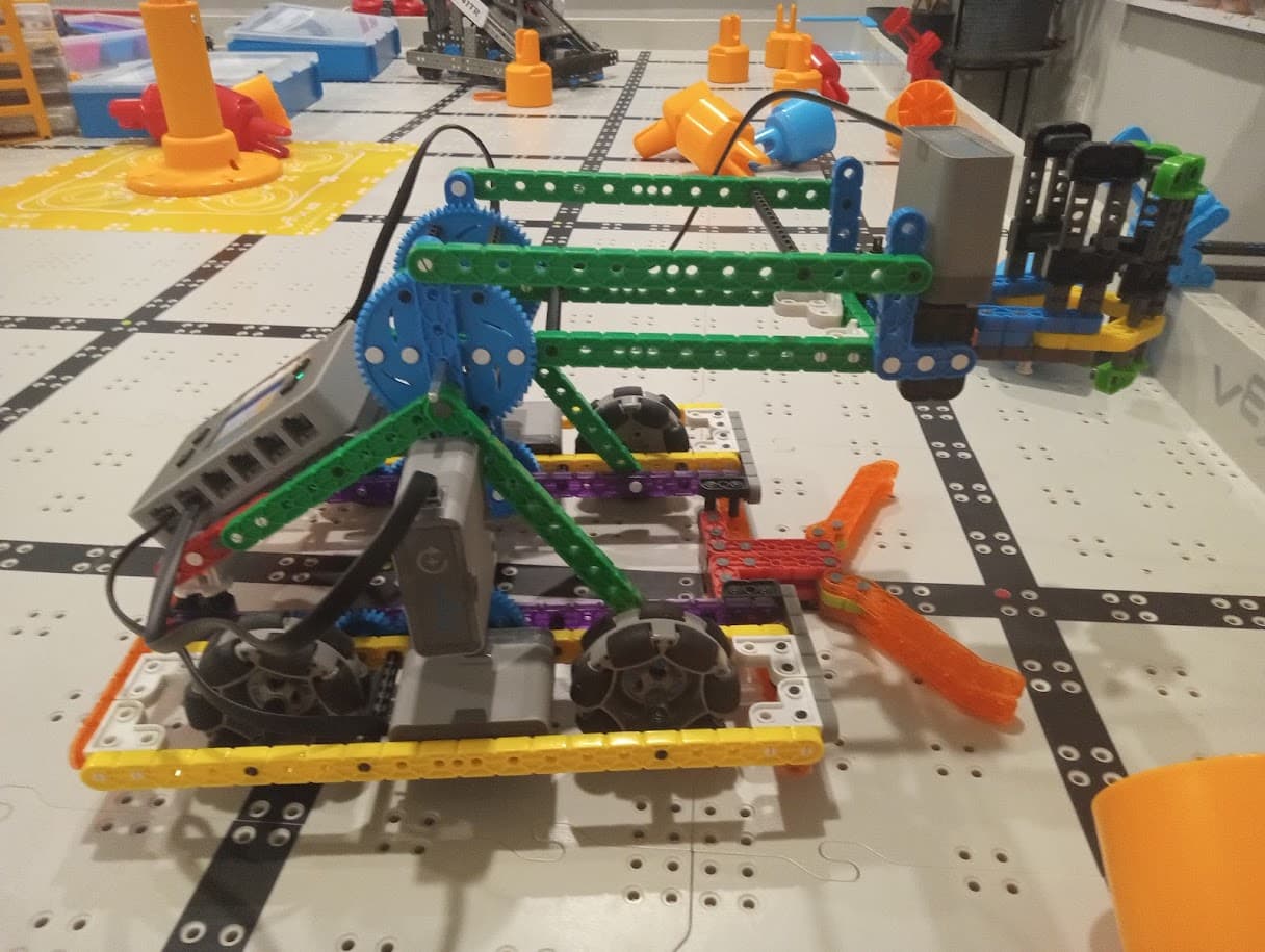

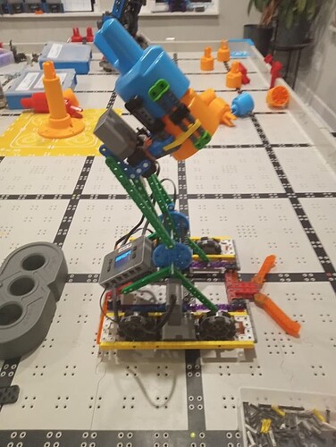

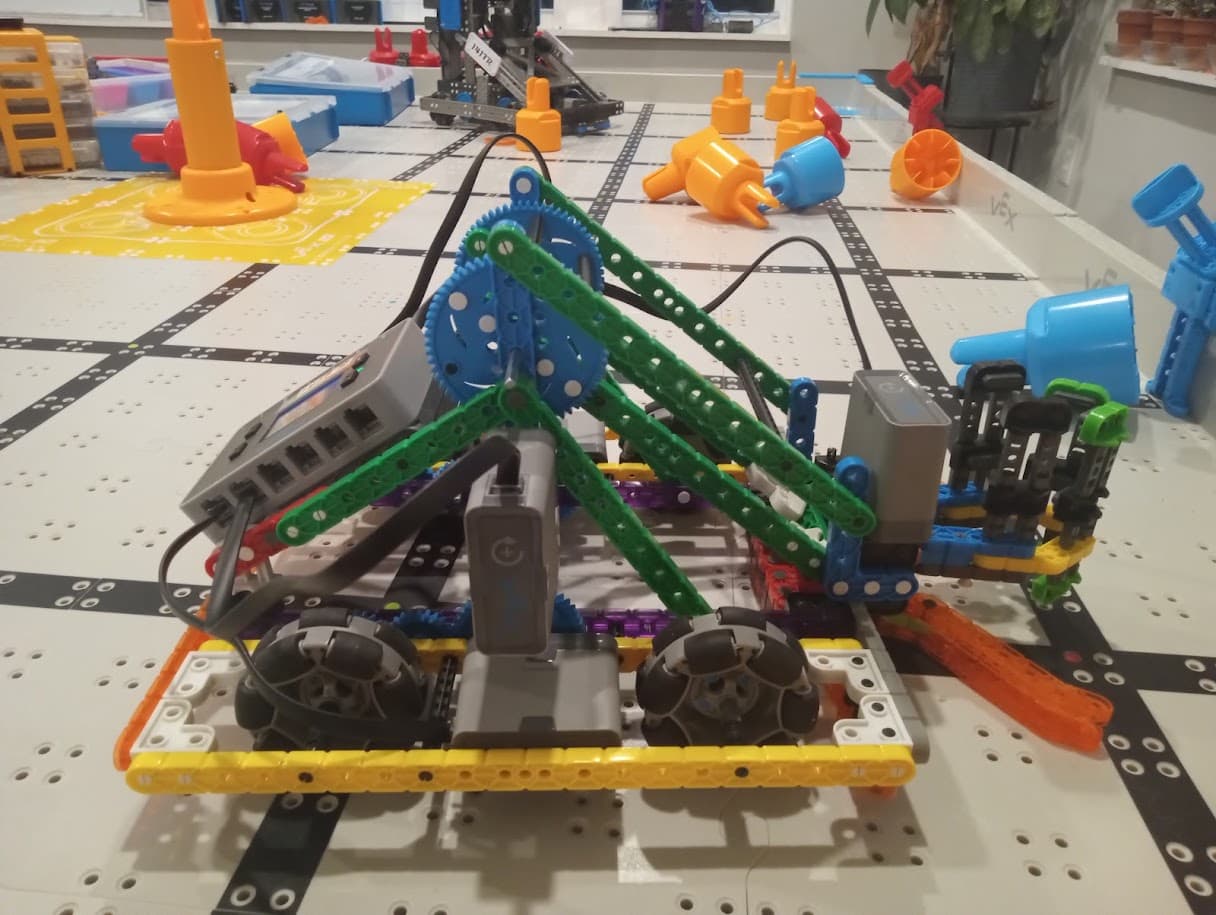

I present to you, the 210-mech!
Specs:
  • 2m drive 2:1
  • 2m 4-bar 5:1
  • 1m claw 1:1
  • planning on adding a beam mechansim or an h-wheel with the last motor.
Photos of the 6 sides of the robot
This robot features the innovative 210-mech: a four bar that has both linear and rotational motion at the end.

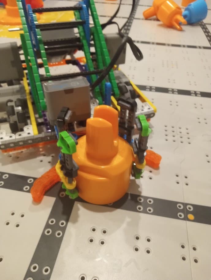

This robot can make 2 stacks with ease and invert them!
This robot can even flip itself back on its wheels, so no more excuses kids!
https://photos.app.goo.gl/rXUaTFUbBUSNyrGUA (I can’t upload videos to VF, so here are some short videos of the robot doing things)
Since I am not IQ-eliglble (16 years old) I will not be competing in events. This robot will merely serve as a practice partner to the team I am coaching.
If yoou have any more questions, please let me know!

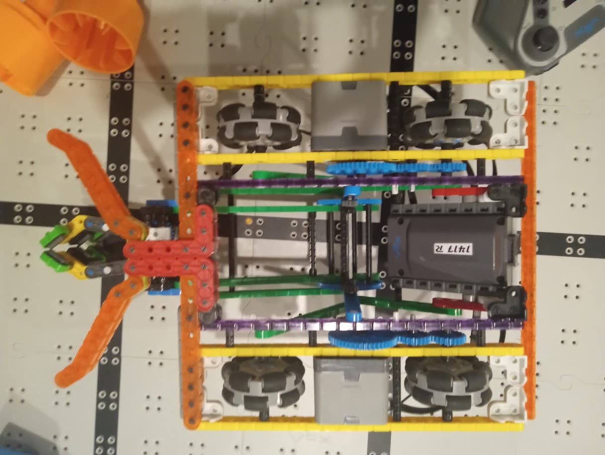

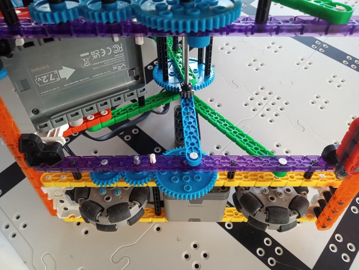

The kinematics on the 4 bar is pretty interesting. I’m out so I can’t watch the video. Can you post a picture from the bottom, I would like to see how you supported the center.
This is a solid design, did you CAD first or just snap&go?
Here’s a picture of the 4-bar support:
Basically, I had to use a bunch or triangles to get everything supported (I love trig!)
No, this was free-built.
For this challenge, I wanted to make an innovative robot to the table (well, computer). I also wanted to use this robot to teach my students differnet techniques.
I noticed several teams used this “180-mech” robot, which I assume you are familiar with. The biggest issue with that design is being able to stack pins, since the normal 2 bar angles back too much. One day, when playing around with IQ pieces (and failing to make a DR4B), I accidently created this masterpiece: (Can someone help name this please?) This mechanism allows me to have all the benefits of a garden-variety 4-bars while having the rotational advantages of a 2-bar.
Finally, I had a good excuse to build a 180-mech. I started with the drivebase. Being limited to only 1x beams, I had very few options for the drivetrain speed. Eventually, I decided I didn’t need to spend too much time on this (my V5 robot needs some help…) and made a 2:1 ratio with only 1 wheel driving.
Next, I attached the… mechanism… to the drivetrain. I originally had the 4-bar thing angled at about -20-degrees, thinking that would help the pins stack, but I eventually made it more square. After this, I had the claw.
I wanted to retain the double-stacking ability, but the limits to 1x beam geometry made this too difficult. I decided to stick with a single-pin claw. This worked pretty easily, allowing me to test the robot out.
Due to the “light-ness” of the robot, I had some issues with the robot tipping. However, this actually allowed me to score on the standoff goal. It isn’t consistient yet, but I’ll tune it later.
If you have any more questions, please let me know!
