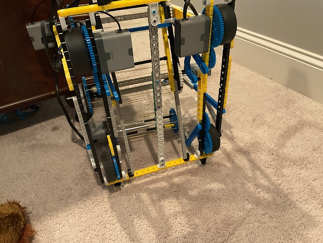

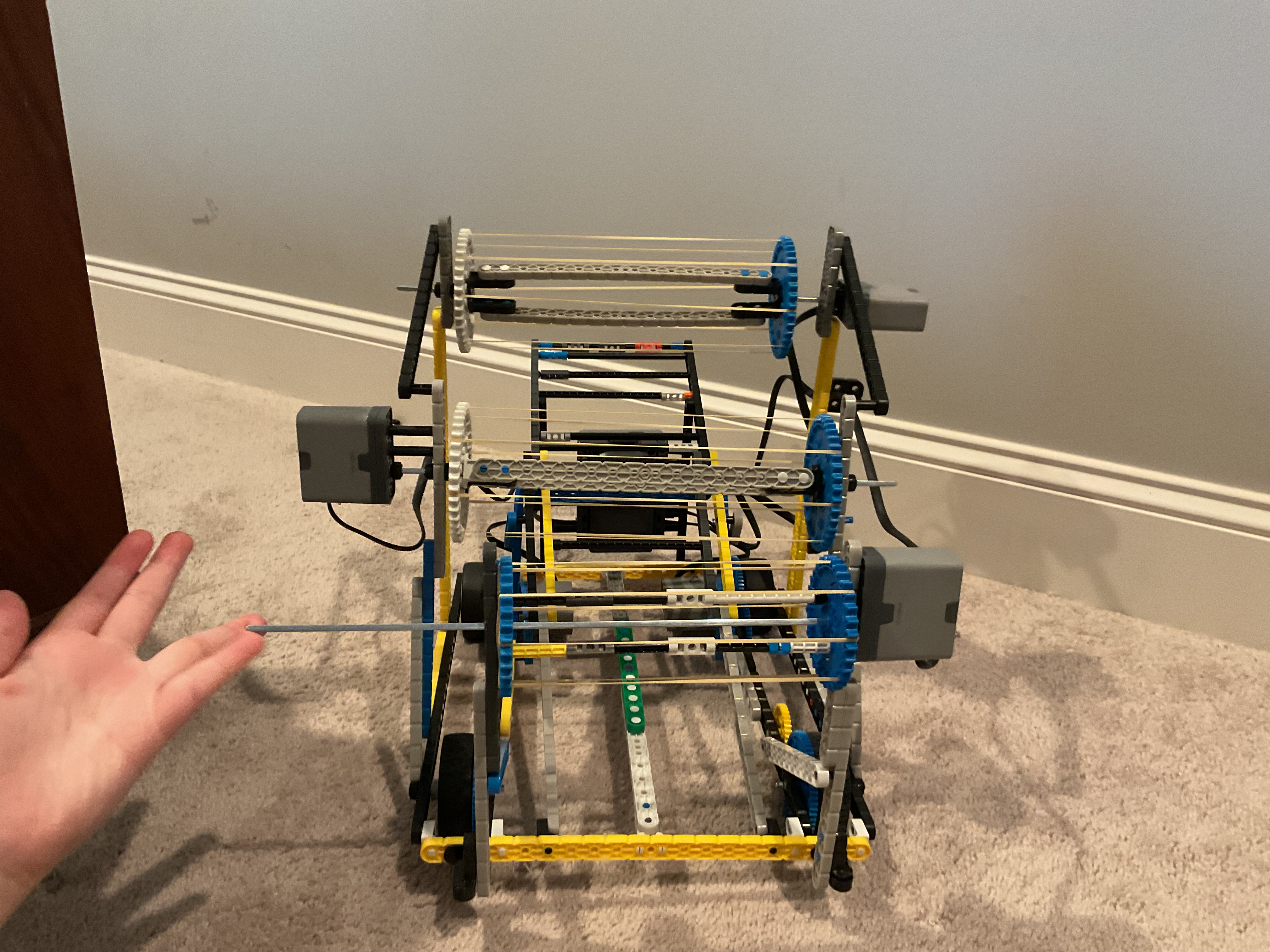

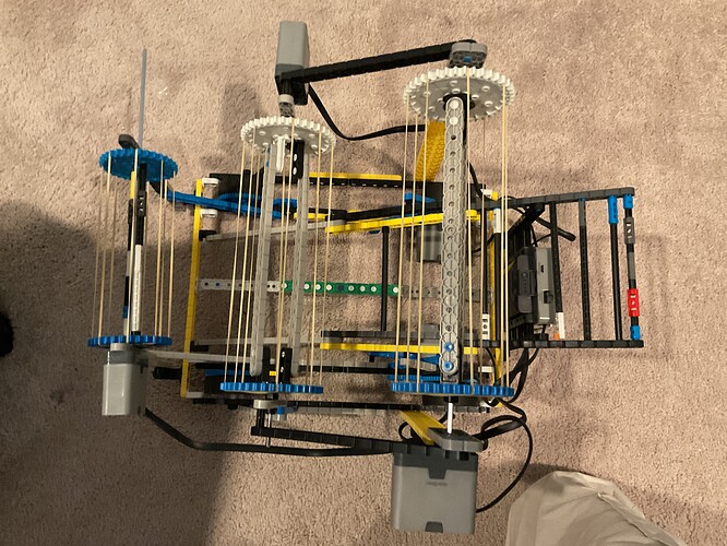

His name is stringbean, and he can score lowgoal.
We were a bit limited on parts (hence the crazy shaft lengths and brain placement)
this was super fun!
Wow, very impressed, the robot is almost ethereal with the few number of 1x components. I really like all of the standoffs being used all over the place as supports and in the intakes.
Looks like there is only 4 pieces of 2x, if you had some more 1x20 and 1x10 could those 2x be swapped out? I’m impressed with the 2 hour build time, most days it takes me that long to find the right pieces.
Stringbean looks like it’s pretty sturdy, I see you have ~500 of the 0x2 pins holding things together. Even with all the random axle lengths it’s a very clean build.

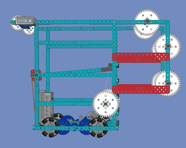

This is my robot for the entry:
His name is Vexy!
  • It was made on LDCadVEX.
  • It is a backroller robot, which is the current meta, and type of robot used to set the world record robot for teamwork and skills.
  • It is made and designed entirely by me, a 13 year old.
  • It has a 2 motor 2:1 drivetrain, a 2 motor 5:1 intake, a 1 motor 1:1 gravity gear winch/catapult and a 1 motor 3:1 backroller.
  • The way backrollers work is they have a catapult for scoring high goal and a spinner at the back for scoring low goal quickly.
  • I have coloured the 1x beams in aqua.
  • There are no cables as I couldn’t work them out in CAD.
  • There is also no chain or rubber bands on the intake and spinners because i couldnt work them out in cad, the spinners are supposed to have rubber bands on them and the is supposed to be chain from the motor powered 40 tooth sprockets to the small 8 tooth sprockets on the same axle as the three intake spinners.
  • It took about 15 hours in total to CAD.
  • This was a very fun competition to build a robot for! Thank you so much for organizing it!

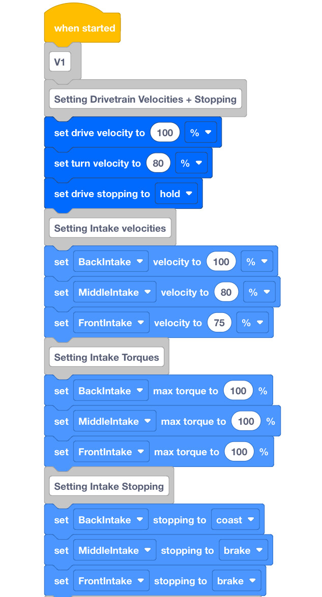

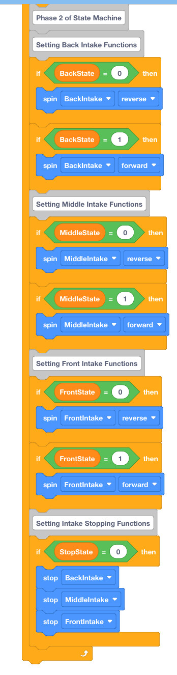

bean man is running a custom code
We wanted to be able to run all intakes individually, so that we could outake one ball for a pass, and pick it back up instead of wasting time moving the first ball back up the ramp. Additionally, we wanted to set the velocity + stopping.

Nice job on the code, I like your decisions on what functions you needed to split out to make all of this work smoothly. I like the thoughts into the strategy to be able to out-take to get the pass to work.
Thanks for our first CAD only entry! Nice job. I appreciate the description block of what you’ve built. I’m impressed that you spent as long as you did on the CAD. I really like how you really supported the base.
I want to as about the 2x parts that you used. Like @3apples could you have done doubled up 1x parts, maybe pinning across the beams with 1x2 connectors?
From the CAD file you sent me, it looks like you are using LDraw, maybe someone can chip in on how to do the rubber bands. Can you tell me what parts library you are using for LDraw?
Overall great job on the design!!
I don’t think it will, the brain / battery is pretty low to the ground. There isn’t very much weight in the superstructure. The base is both wide and long, (18x20) so it has a substantial base. But maybe you’ve seen something I missed. Do you think that the three floating motors will move the CoG that much?
I don’t know exactly, but I think with the chain and rubberbands on (mayye not rubberbands, thoes are light enough) the robot will be unstable especially with stopping and reversing. I think just putting a small anti-tip piece, and it will be fine.
On our robot we used this season at nationals had the same size drivebase and was longer than this robot, and still didn’t tip over!

Submission #2 for Vexy, all information is the same as the last submission, so read that first please. I have now added chain, pins holding the motors on, and beams at the front to ensure it does not tip. (+2 hours of cadding time)
Thanks @holbrook for the tips.
@RoboticsIsFun - Nice job on the update to it, thanks!
