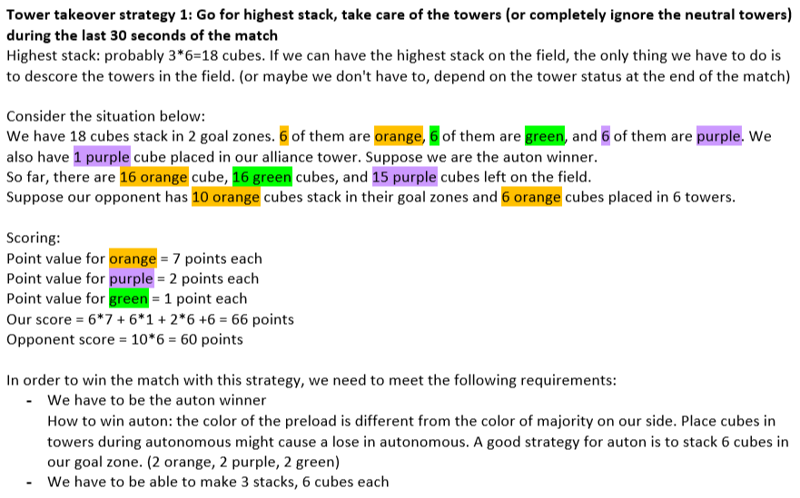

One strategy my team thought of was to start stacking cubes that the opposing alliance is placing in the towers. If they start putting orange cubes in the towers, start stacking orange cubes. That way you also benefit from the cubes that are in the tower and don’t have to waste time placing/descoring cubes in the tower. As long as you get more of that colour cube in a stack than the opposing alliance, you will most likely win. You might also need to stack a few extra cubes of other colours just to give you a few points to ensure a win.

Your opponent would score 70 points, because they also get 7 points per orange cube.
You are right. Then descore is necessary.

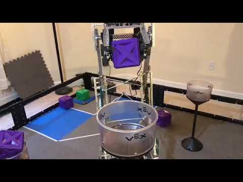

Also, it is extremely easy to descore the cubes. Simply ramming into the poles will cause them to fall out.
are you sure of this? based on images from the game manual this should not be the case.
Here you go. This is kind of a broken strategy, but I’m not 100% sure if it is legal.
Oh okay. Thanks
