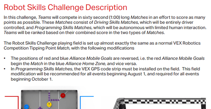

The field code strips will be required on skills fields but not head-to-head competition fields:
As of now, it’s required by October 1 for skills fields, for the programming skills only. So you will need a gps field perimeter if you will be hosting a tournament.
I expect Qualifying Criteria to clarify what is required and when. This is the guiding document for EPs about what they need to offer for events.
It’s actually in Appendix B:
It’s only required for programming skills, not driver skills. So, you could designate one or two fields as the “programming” field(s). This would of course depend on the demand in your area. If you are using competition fields for skills you could say they are for “Driver skills only.”
