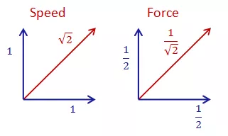

wait… but the x drive has wheels pointing at an angle, which should mean speed loss, but how is it sqrt 2 times faster
Watch the Famous Cody Smith explanation about Omni wheel drives
of course i know that omni wheels have small wheels and how they work, but when the wheels are at a angle, isnt some energy lost by spining the other wheel?
Sorry, I didn’t mention this before, but that is for a square x-drive. Basically, you could think about a square x-drive. if it moved forward it would be moved at the speed of a tank drive. If it moved diagonally it is moving sqrt 2 times faster because that is the diagonal of a square.
This image shows the basic idea, assuming the x and y-axis represent forward and horizontal movement. You can check this article out for a great explanation,
Yes, you get more speed (1.4 time as much) but less transferred power.

The speed is sqrt(2) times faster, however, some torque is lost due to the increase in speed making the torque 1/sqrt(2).
