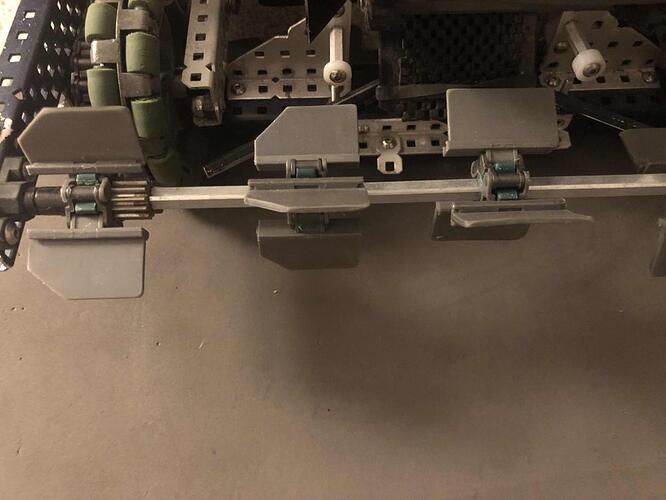

A high strength axle that was “Mushroom headed” (Simply hammering down the end until it becomes wider than the original diameter) was then hammered into a metal High strength pinion.
It’s a crude solution but it was the only one that I could think of that was thin enough to fit within the side of a 6 tooth sprocket. It was very strong and never broke during over a month of use, scrimmages, and worlds.
Here is a picture:

Does that mean that the middle sprockets are free to slide?
No, For those I took pipe cutters and scuffed up the axle then hammered the sprockets over them. There was not space for collars.
