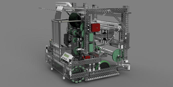

Finally got around to stop procrastinating finishing the 202Z ITZ cad.
Hope you like it, files will be up shortly in the google drive.
An update on the rest of this project, I think I am only going to be making 1 more robot which is 400X Nothing But Net.

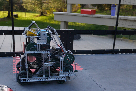

Nice work on this Zach. One thing though is that the intake motor was mounted at an angle to not hit the cones as they were sucked up:
Ahh didn’t catch that in the pictures, i’ll fix it in the model soon. Thanks!

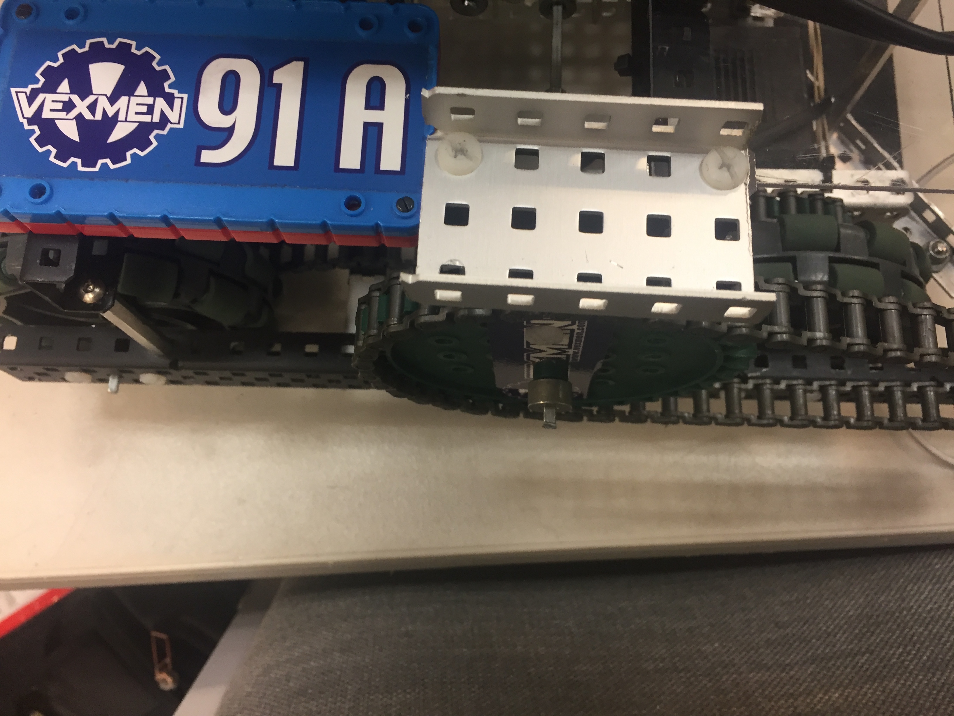

Just a quick question about the quadrature encoders on 202Z’s robot. Is it practical to keep the encoders on the outside of the robot’s drive base? Will they get destroyed by defensive bots? just asking because my team is considering doing the same thing. Honestly though, insane bot.
It is not practical to put them on the outside of the chassis because I have had them sheer right off. Given how early in the season it is, maybe spend some time reconfiguring the chassis design so they are properly protected. I anticipate a lot of defense in this game, and the wider availability of v5 now means there will be no shortage of it.

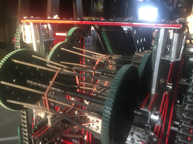

Here you can see how we attempted to protect poorly placed sensors/wires/chain. The potentiometer wire was safe but the encoder’s plastic mount eventually sheered causing it to fall off.
In these early TP robots, we tried to protect the chain with a guard. At our first tournament it back fired when the guard bent inwards on impact and derailed the chain. We moved it inwards after that, and it never broke for the entire season until our first elims match at worlds. Even though it was “inside” the chassis, it was too exposed. Getting B01’d the same way at my first and last tournament of a season is enough reasoning to strongly discourage exposing critical elements to the outside of your robot.

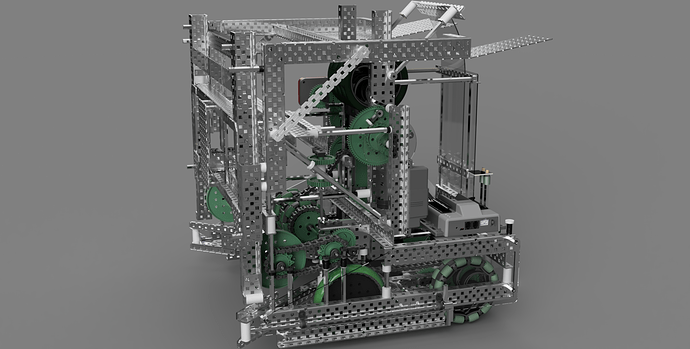

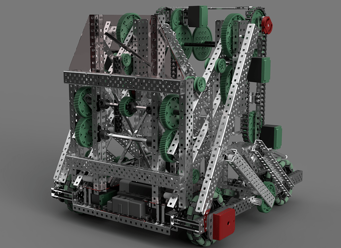

Hello again, this is probably the last model i am going to work on/release for a long time. It’s been fun and i’m glad people have gained something from all the work put in.
So without further ado, 400X Nothing But Net:
As always, higher quality render pics can be found on the google drive and the file will be up soon.
