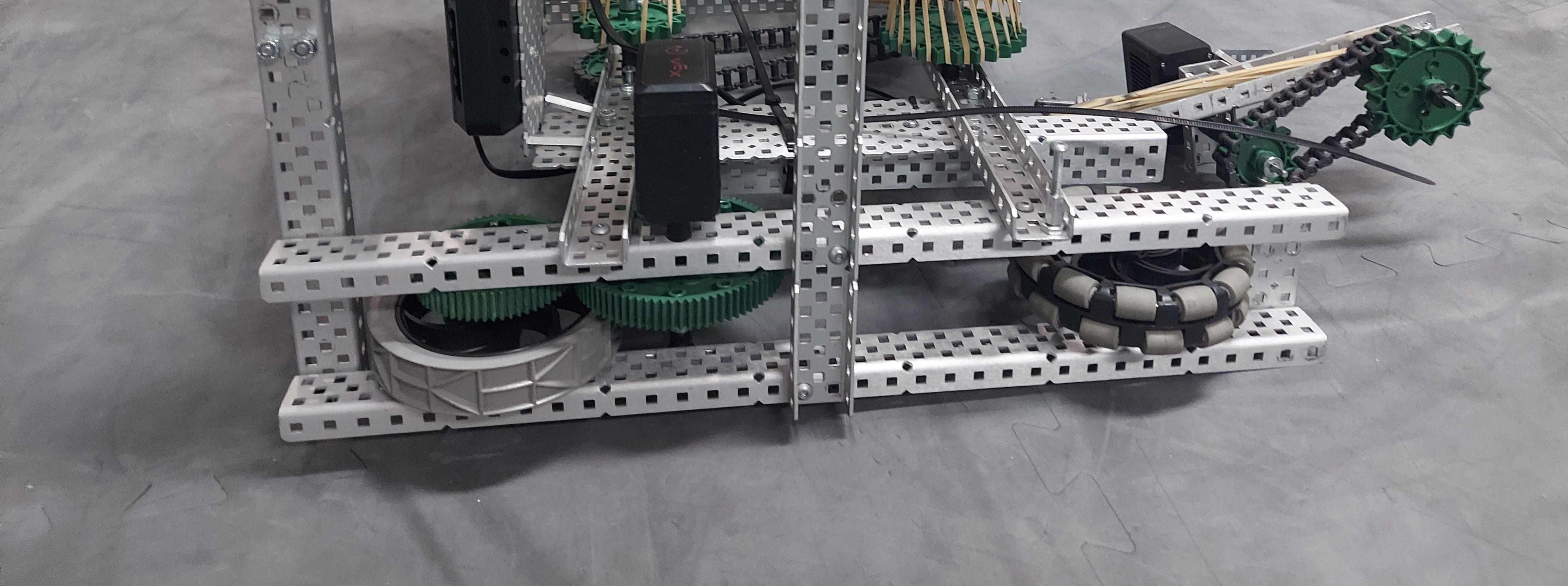

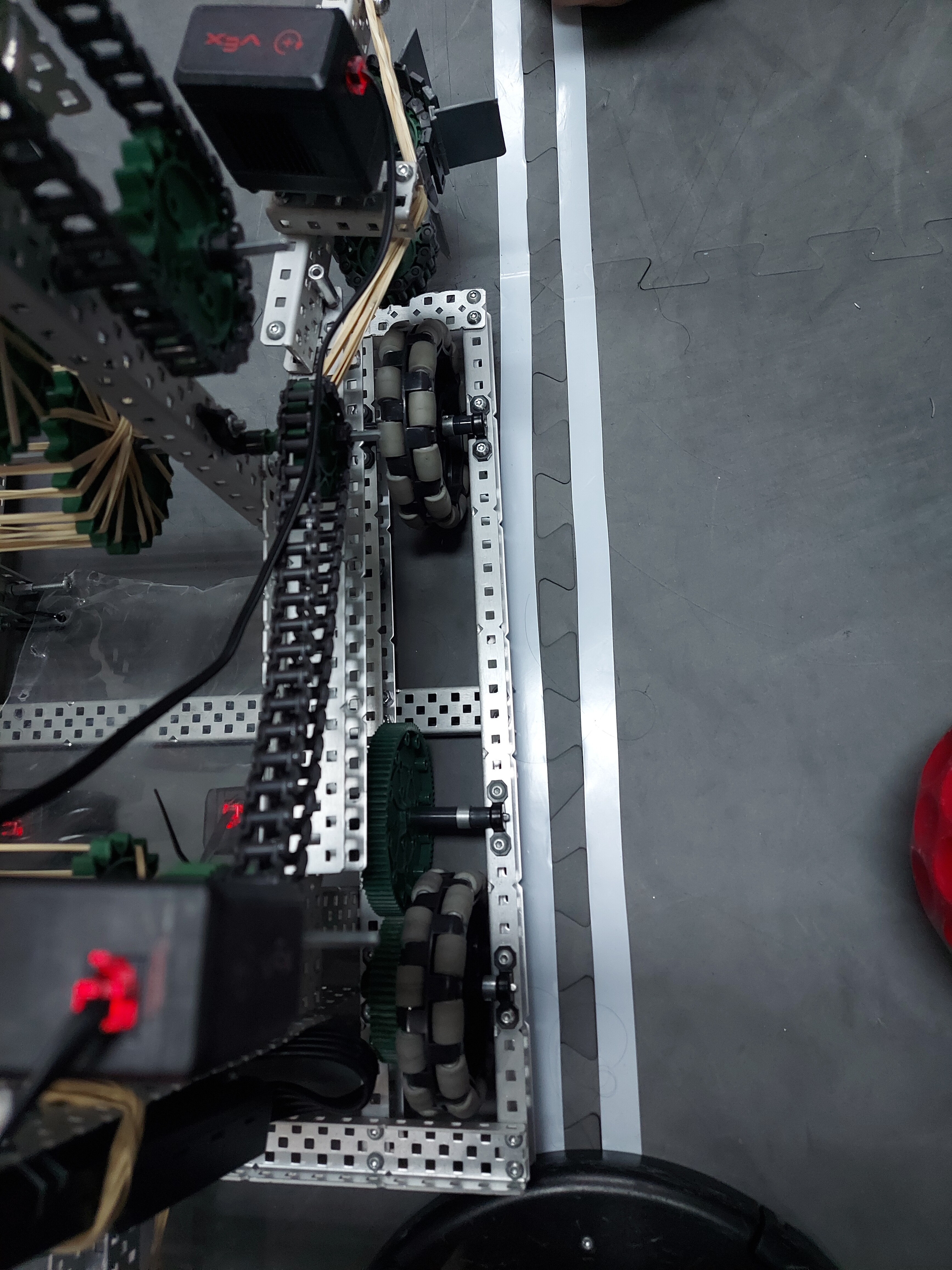

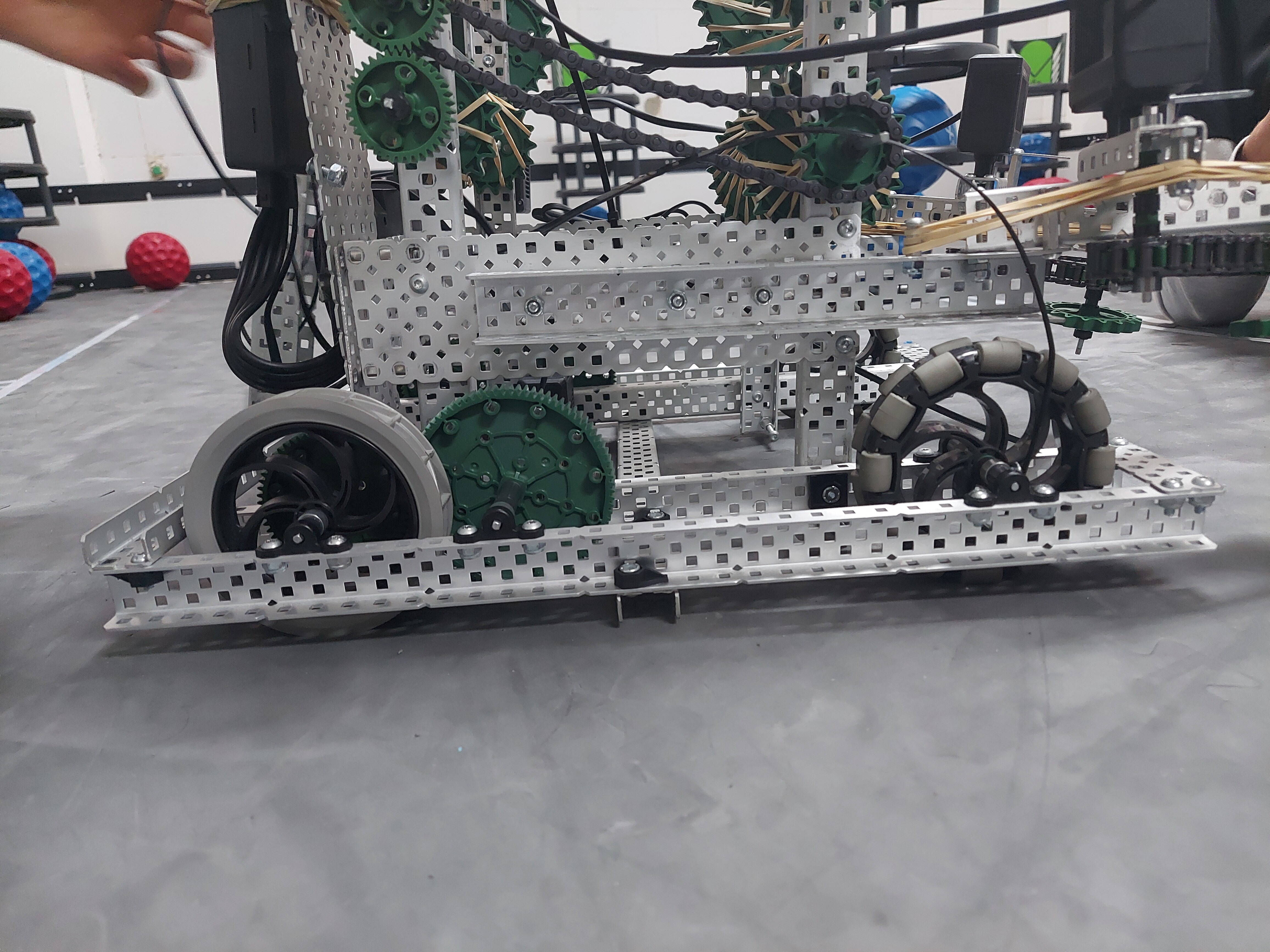

Here’s a picture of our drivetrain.

I’m kind of confused what I’m looking at here, I see what looks like a 1:1 ratio connecting your back wheels, and your front wheels appear to be linked somewhere with chain, but I’m not quite sure where.
Also, this may be from the perspective of the photo, but to me it doesn’t look like your shafts here (especially the back two) are perpendicular to the c channel on your drive, due to the inherent slop that screws have in holes. This would cause significant friction.
Do you have any better photos that could show how the whole drive looks? perhaps an angle from the underside?
Please ignore the traction wheels, we just put them there to try something.
Also that’s true that the c channels weren’t really perpendicular. We fixed that though but we still have the problem.
So it’s a 7:5 ratio two wheel drive, with only the back wheels getting powered.
is that a 200 or 100 rpm cartridge motor?
I can see that the two sides of your drive aren’t quite aligned properly, which is probably the source of your issue. I also notice you only have one screw holding that central cross beam to each side of the drive, you really should have two screws here because having only one point of contact creates a pivot, which made it much easier for your drive to misalign.
Also if those motors are 200 rpm cartridges, a 7:5 ratio with only 2 motors is very aggressive. That would have the equivalent torque of a 560 rpm 4 motor drive, so essentially nothing. If you can, adding two more motors would likely reduce the impact of friction by a great deal, and just improve your overall acceleration and torque.
