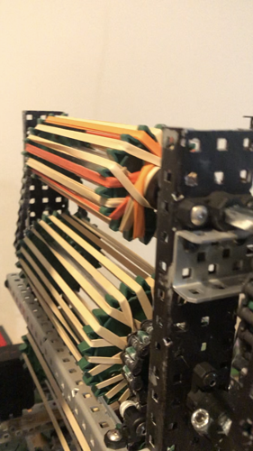

Our top roller on the snail bot has one rubber band breaking each test cycle. No other rollers have this problem. The rubber bands are not contacting anything except the ball and are attached the same way the bands on the other rollers attach.
Does anyone have an idea of why this is happening or if it has happened to you?
It may be the rollers are rubbing on the spacers that are on the axle. That is what happened to my team for a while. Make sure to actually rubber band then well and out of the way of where spacers may be contacting the sprockets. It sounds dumb but that’s what was happening to us

Could you post a picture of your top roller?

quality rubber bands are so worth it. also check for anything that could be rubbing the bands while it spins.
To prevent rubber band chafing we zip tie the bands away from the axle. Might be worth a try.
I’ve also seen teams use screws through the sprocket in the innermost ring of holes to keep rubber bands off the axle.

If your top roller is really close to the goal, it could be because the rubber bands spread outward when the roller is spinning fast which would cause them to scrape against the goal rim, the underside of which is really sharp for no reason

Here’s an image. Ignore the colors since we just happened to have different colors and I tried to make a pattern.
That’s a rather small flywheel you got there.
1600 rpm so the tangential speed isn’t too far off a larger flywheel at slower speeds
