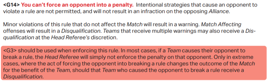

To me, this at first seems like a pretty clear case of G14:
Why didn’t you move your robot away from the platform after they stopped pushing you? the refs could have interpreted you not moving away as intentionally continuing to contact the platform.
Even if they did think your failure to move away was a violation, this did not interfere with their ability to balance the platform, so it should have been only a 30 point penalty at most.

This ruling is consistent with an Elimination match at the WPI Signature Event where a robot in a tug-of-war over a goal was pulled into transitive contact with a Platform at the end of the Match. I believe this is consistent with:
I think this is a good scenario to pose to the Official Q&A. Your case seems to have a bit stronger argument for a G14 exception than the WPI match. That said, it is reasonable to interpret “Note 2” in absolute terms as meaning that contact with the opposing Platform, regardless of any context of “how” that contact happened, is a DQ. I don’t think this is gameplay the GDC would wish to foster (e.g. teams decide to play a strategy where the Red team pushes a Blue robot into the Red platform in the last 5 seconds of the match since they can’t be called for pinning).
SG3 specifically assumes a lower standard than “match affecting”, instead:
Violations of this rule which do interfere with gameplay, such as preventing a Platform from becoming Balanced, will result in a Disqualification, regardless of whether the interference was Match Affecting or not.
Anything touching both the Platform and the floor tiles (transitively) by definition prevents the Platform from being Balanced and is therefore “gameplay affecting”

Perversely, when the Red Robot pushes the Blue Robot into the Red Platform, the Red Robot (transitively) now receives the “benefit of the doubt” under SG3b:
wow, it hadn’t occurred to me that a robot pushing it’s alliance into their own platform would still be protected by this clause because they’re transitively touching their own platform. This means that pushing your opponent into your platform is a viable strategy that’s protected by the rules, as against the spirit of the competition that it is.
These interpretations effectively nullify G14 in probably 90% of cases where it would have mattered. In my opinion, there should be a rule change which gives G14 a bit more precedence over G13 and SG3.
Perhaps this clause allows for G14 exceptions, though it may not be clear (given both this match and the WPI match, both made by very good and very experienced referees)
well, it is keeping the platform from being balanced if they are touching it at the end of the match… so it is kind of implied by the rule. (but it is kind of dumb)
It sure seems like it would have to, otherwise that is just ridiculous. I sincerely hope the scheduled manual update tomorrow addresses a lot of the lack of clarity issues! I think it should go like this:
  1. The blue was clearly forced into the penalty, so there was definitely a rule being violated and therefore there should be no automatic benefit of the doubt given to the red as being offensive.
  2. Then to look at the other part of the rule - G13 takes precedence over G14 for SG3. I would personally say that in this situation the blue robot is the offensive robot, as it was clearly trying to get to the goal while the red was solely trying to push it around.
  3. Therefore, the ref should err on the side of the blue robot (NOT the red) and move on to G14 (where it penalizes the RED robot with a violation of G14 - no enforcement of the penalty on the blue at a minimum).
