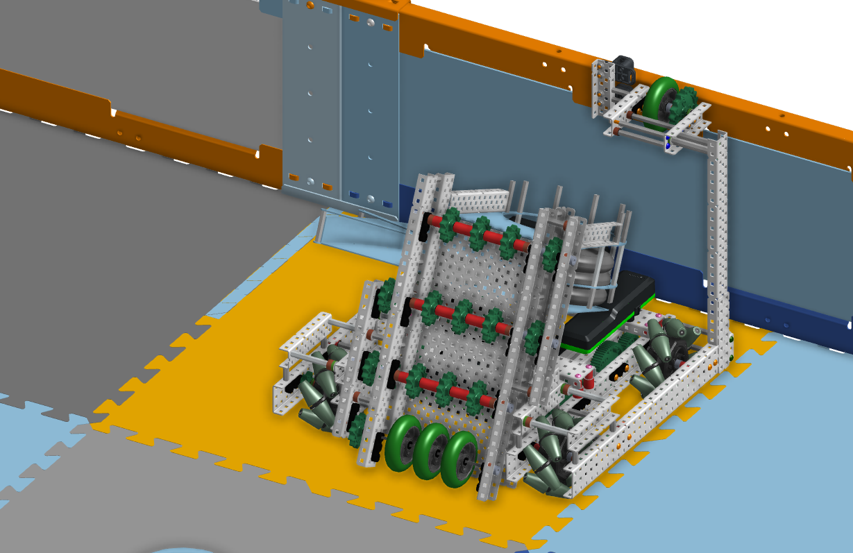

After 3 weeks of work, I have a decently meta design
I will be fixing the Roller tomorrow and gonna finalize the design on Monday.
