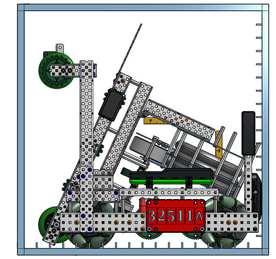

That is one possible way to do it, but to save space, I did it my way. The way is works is by spinning the roller till the top color sensor senses the desire color, and the bottom color sensor senses the opposite color. that ensures that the color change is along the equator which means that one color will be one top with a lot of margin incase it gets bumped.
I’m curious how using two opticals on top of each other is more space-saving than one pointing up?
as you can see from the side shot, placing two optical sensors flush with the wheel means I don’t have to cut space in the back for one to poke out.
Which side of the robot will the color spinner be on? The first picture has it at the back, but the second has it towards the front. Is the side view a newer model?
I moved it to the front so I would have to run a smaller chain.
