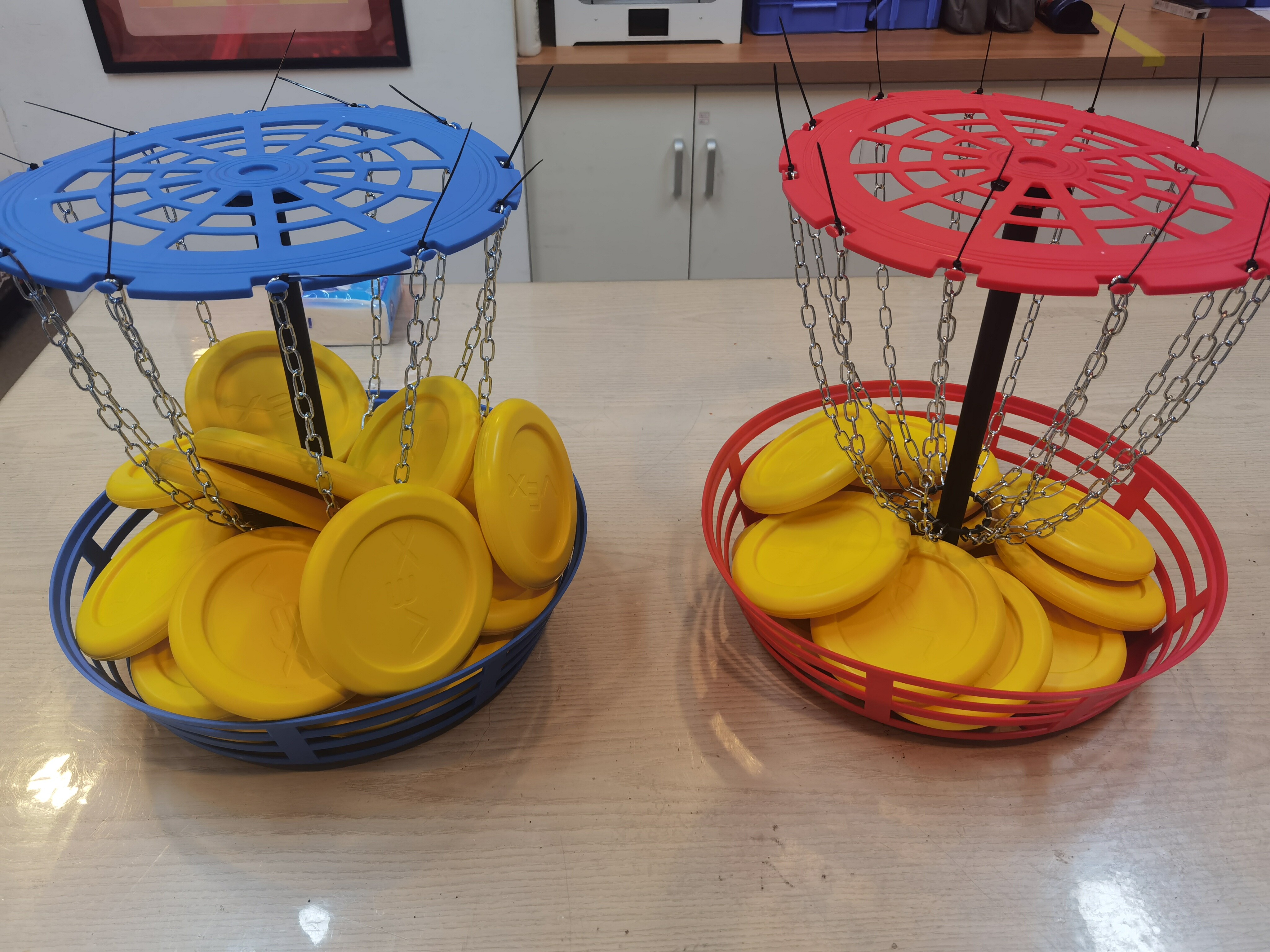

30 disks vs. 15 disks
Very useful.
At a glance, if there were scoring mechanisms that launched from the low to high goal at a steep angle, that pile of 30 seems possible. Even the long flat trajectories most are discussing would seem likely to get 20+.
Thank you so much!
Just for curiosity’s sake, can you try to put all 60 in a goal?
Yeah, I think last time I didn’t count very carefully. It is possible to score 20 or even 24 disks by a regular shooter.
Technically yes, if you stack them.
Can you try? I don’t see why you shouldn’t stack them.
having disks stacked in the goal would not happen in a real game (unless magic or smth)
Why not?
I may try tomorrow when I go to the lab :laughing: (btw I’m from China so it’s night now)
Well in fact while shooting at a flat angle, the chains actually helped to slow down and ā€œholdā€ the disks and prevents them from bouncing out.
How does ā€œbouncingā€ the discs off the top plastic and chain work? (A steep angle) Do they bounce out more or less than a flat angle?
I think it depends on the speed of the disks. We haven’t test an angle that steep but I believe flat shots are more preferable in most cases.
