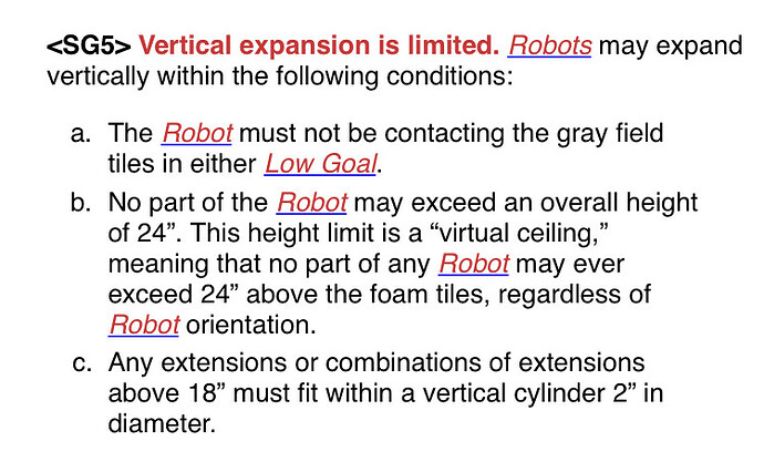

as long as you don’t touch the low goal’s 2d plan, you can still expand up 2 inches, which could be used to hook onto one of the bars.
I am just curious, even though I’m not on a team anymore. My idea was that a bot could climb and hug the high goal until the last 10 seconds. If the expansion thing would be an issue, the bot would have a one-shot puncher mechanism on the bottom that makes it jump to reach the bars. Such a design might only require 2 drive motors, or even one, leaving the rest for climbing and endgame expansion. This definitely wouldn’t be a meta, but it’s these wacky designs that keep things interesting

part b of SG5 makes me think that this is a no-go either way, since it has mentions of a ā€˜virtual ceiling’.

Vertical expansion is limited to 24"
Bottom of high goal is 25"
There is no way to descore high goal

or instead of saying this in this fashion, say, ā€œit is impossible by the standards set by the rules, blah blah blah 24 inch vertical blah blah blah bottom goal 25 inchesā€ no idea is stupid. people just need to pay more attention to the rules.

Not to mention you can’t even be taller than 18ā€ in the low goal

<G17> Use discs to play the game. Discs may not be used to accomplish actions that would be otherwise illegal if they were attempted by Robot mechanisms (e.g., interfering with an opponent’s Autonomous routine, per <SG8>).
Right, but what rule says you cannot de-score the high goal? It would be an SG rule… no SG rule says de-score is illegal. If unstated in the rules, it is allowed.
