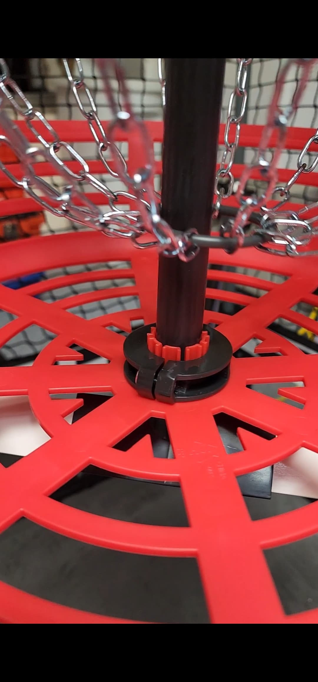

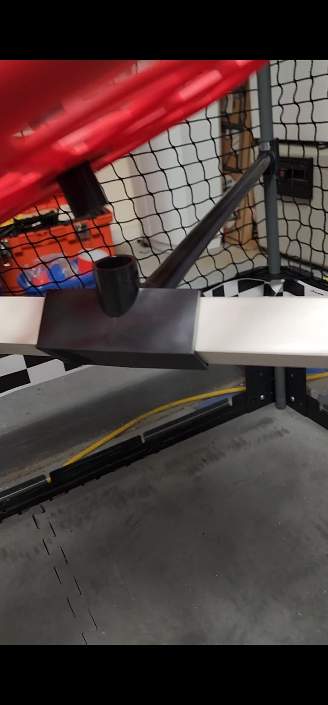

The goals themselves are held in by some PVC pipe and the same piece that the goals from tipping point had (the circular one that you tighten similar to a shaft collar). I’m a little concerned for the longevity of these pieces, and although I doubt a disc will be thrown with enough force to knock it down, theyre secured to the point where theyre able to spin in place (assuming i set them up correctly). Pictures below

The rubber ratcheting piece is designed to be rotated as it wears to keep it fresh, but yes on a practice field in your shop I think you may wear it out over the season. I think it was brought up elsewhere, but there is also interference between the bolt head through the roller and the “pointers”.
