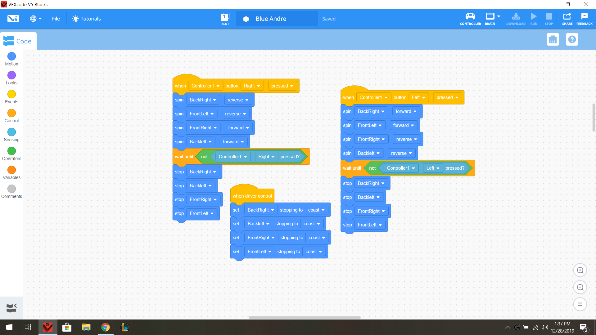

We are using V5 Blocks and have recently switched over to mecanum wheels after 2 competitions. We are currently mainly struggling with the strafing part. We know the motions for strafing left and right but our code isn’t working.

Right now your code goes
If button pressed, make the drive spin, wait until button pressed, then stop. Since the button will be pressed to move it, pressing the button will also make it coast so therefore your code doesn’t do anything.
In your when started loop, make a while true loop and use if, else if, and else statements to see when the controller is being pressed and move the drive based on that.
If button right pressed: strafe
Else if button left pressed: strafe the other way
Else: coast the drive
Is this better?
No, first of all, your right strafing code won’t run correctly (because it only takes place when the left button is pressed.)
However, you also have no way of strafing slowly, which I’d imagine you wish to do.
Here I tried again. Still doesn’t work
I think you have to put the if statements in a forever loop.
I think you also have to use an if then else statement and put the if statement in the else part
It should look something like this (ignore the inside)

Your if statememts checking if the buttons aren’t pressed won’t do anything, since they will only be checked when the button is pressed. Also, the code under the statements checking the opposite button will only execute if both buttons are pressed. I think the problem might lie in the fact that you are using event blocks. Try using sensing blocks in the main forever loop.

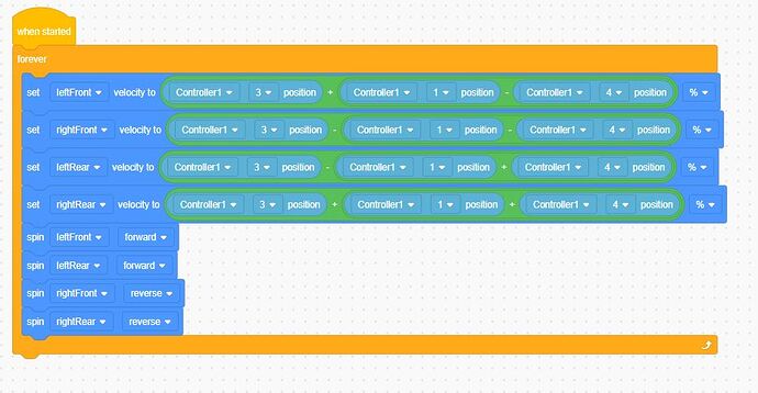

I see that the code is not for joysticks. I just thought you didn’t know how to program x-arcade so it works with joysticks. I’m not sure why you want a button to control strafing but if you want to try using joysticks here some block code. The equation for MotorRF looks different b/c Block implements it like V - (H+Y). Also notice the order of operations for MotorRR.

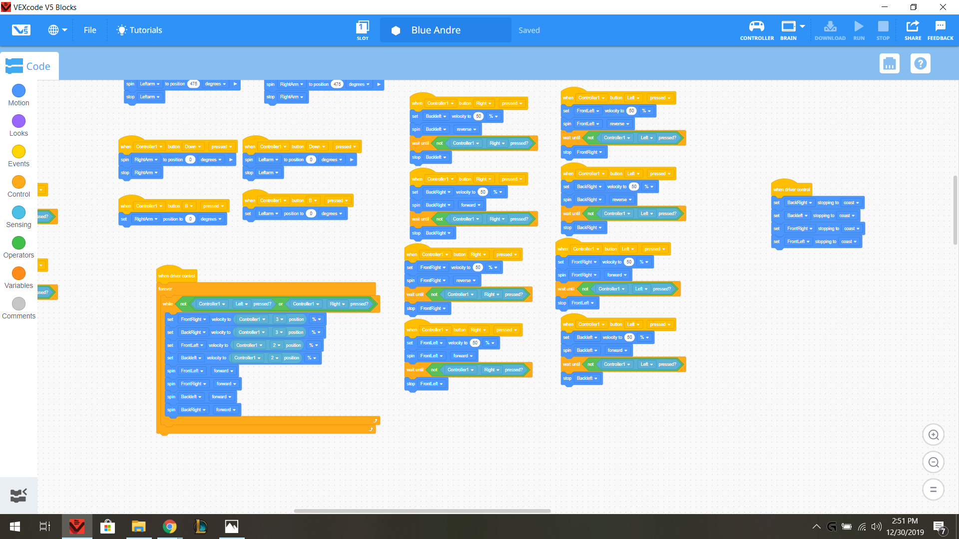

i found the problem first off i should have looked over my teammates code 2ndly nothing will happen because i have the drive train speed set to joy con position any sugestions?
here was the solution
i needed a while loop
Here is my code for mecanum wheels using blocks and the joysticks on the controller.
Hope it works for you.
