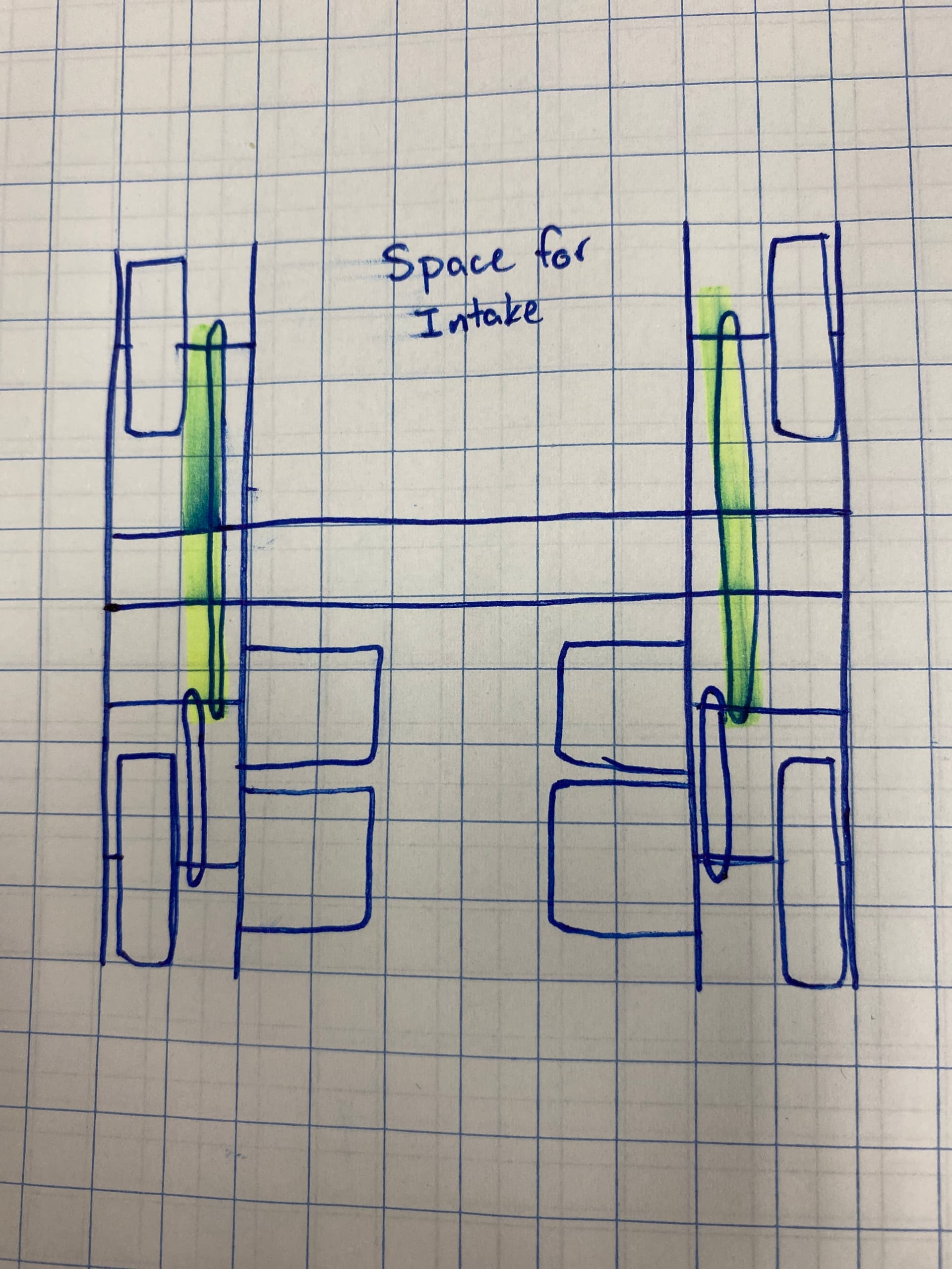

I was working on a two-motor drive design and was wondering yalls thoughts on whether this would be practical to save motors for other components here is the rough sketch
While chaining your drive wheels together is a good idea to keep them all powered, I would highly recommend 4 motor drive at a minimum for this years game. 4 motors to manipulate game objects is enough for almost all situations.

Though having 6 motors sounds good for the rest of your robot it is not the best idea, 4 motors are really good for any kind of robot so you can carry a good amount of weight and go over game obstacles. I really like the rough sketch though and it looks like a good idea, I might try to make something like that in my vex class.
With a game that only has a few different moving parts, it’s not necessary to give four motors for all of the subsystems other than the drive. Most robots are going to be running 4 or 6 motor drive this year, because with the right design and planning, you can use a 1 or 2 motor launcher mechanism with a 1 or 2 motor intake. While using two motors for your drive will give you a lot more freedom to power the launcher, intake, etc., it will make your drive extremely weak and will overheat after a short amount of time due to the stress put on the motors. In the end, it’s up to your team’s decision, but just keep in mind that you have 8 motors to use, and generally don’t want any left over. If you want more help on how to use motors, there are a lot of robot reveals that list their specs and motor usage, like this video, Vex Robotics Spin Up Reveal | 4082B - YouTube with the specs in the description.
Tldr: Two motors for your drive will be weak and overheat quickly when driving around a whole robot. Most teams use 4-6 motors on their drive, and leave the rest for the scoring subsystems.

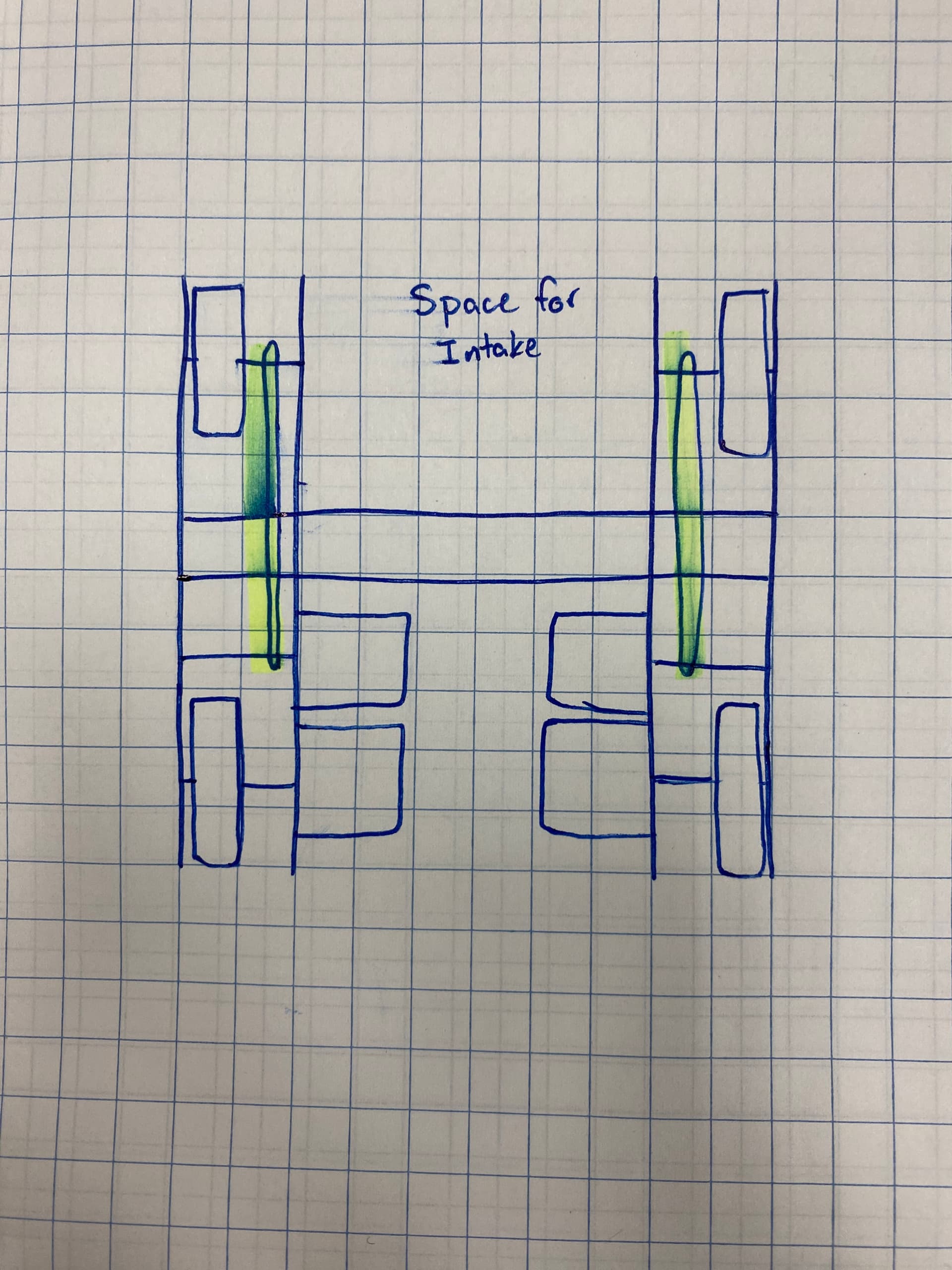

here is a 4 motor version
That is an option, but the motors might get in the way of the intake because they are mear the front and back of the robot. Here is an alternate solution to keep four motors and chain to connect the wheels. I highlighted the chain to see it easier
wouldnt that just use the chain for the one wheel?
i was think it would be able to use the chain for both wheels
but yes i under stand about the motor placement i will try to use that
With chain, it’s harder to link wheels through two motors because then the wheels would spin opposite from each other. If you had a separate sprocket on the middle shaft then link that to the bottom wheel then it would work, but not if you went directly from the front wheel all the way to the back
