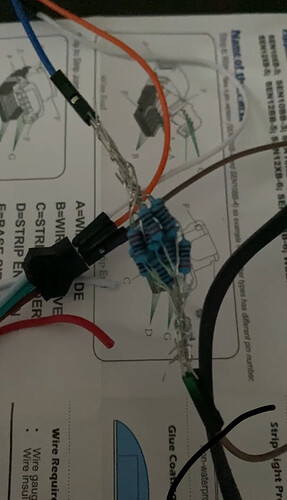

So turns out you don’t need a logic level converter, you can just use diodes instead. Putting one in line with the 5v power drops the voltage to 4.3v, which because the WS2812B led strips detect logic at .7*5v (input voltage) the strips want 3.5v logic. Because the diode drops the voltage to 4.3v the strips can detect logic at 3v which makes the strips work properly.
I originally tried using several resistors connected together but my Grandpa suggested I use diodes instead which work way better than the resistors.
sure, that can handle the logic level issue but does not address the waveform edge issue. However, if the LED strip works then it’s all good, just make sure the diode can dissipate enough power (worse case would be about 1.4W).
