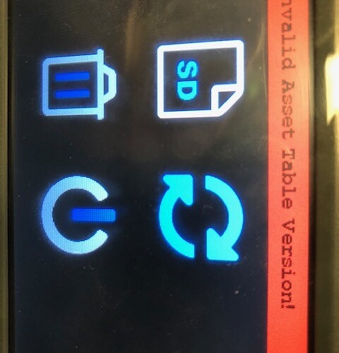

V5 Brain "Invalid Asset Table Version"
Brain boots up and gives the above message. (I attached a picture of the screen on boot up) Connecting it to VCS and it reads as if it is up to date for firmware. Is there any way to DFU the unit so that I can try to reload the firmware?

yes, sent PM, how and when did this happen ? During update from VCS ? or RobotMesh ? Were there any error messages saying to power cycle brain (or not power cycle brain) ?

I have the same problem. This is after a session using @RobotMesh_Support . RobotMesh prompted me to update the firmware, and I allowed it, and an error was reported, but RobotMesh and the brain continued to work for the rest of that session. However, next time I powered up, I got the “invalid asset table version” error screen
Ok, resolved my problem using the firmware updater utility
@MattSnyder, thank you for the report. We’ll look into the error handling code.
When the asset table version is invalid, this can be solved by re-downloading the V5 firmware. Within a Robot Mesh Studio project, click on the Options (gear icon at the top-right) and choose Start firmware update…. Wait for both the BOOT firmware and the ASSET tables to download and restart the brain.
Or, use VEX’s firmware updater utility.

Just grab the standalone V5 firmware updater from here, it will probably detect invalid assets and allow update.
If that doesn’t work, select the force update option after following the instructions below for showing the advanced options.

Follow the instructions here to enable the optional features in the V5 firmware update utility.
(no need to actually run the battery medic)
enable the “force update” feature and the utility should present the “Update now” button again.
