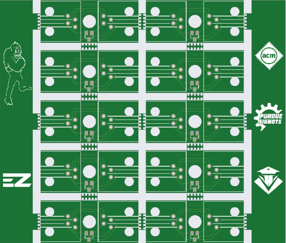

Here is the new board, it comes panelized in groups of 10:

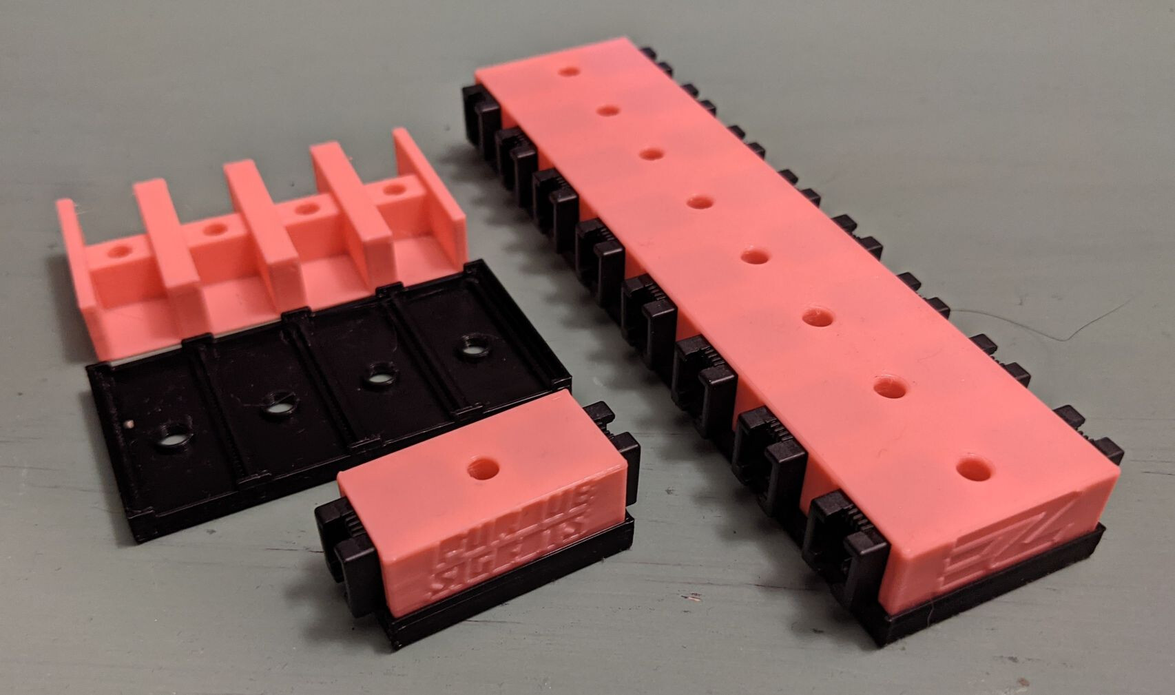

This iteration of the board comes with 2 main features that coincide with each other to improve its mountability on VEX components. We’ve added a thoughhole to the board as well as a 3d printable case for 1, 4, and 8 boards. This comes as part of our collaboration with the VEX Cad Project and VEXU team EZ, whom have designed this case and released the files on our wiki page.

For this iteration, we’ve abandoned Oshpark as our vendor for ordering boards and have instead provided instructions on JLCPCB for ordering boards instead. These have had two major benefits for the board:
  1. We have reduced the price of the board from ~2-3$ to roughly 40 cents for the board without jacks , leaving the price under a dollar with the jacks included. The unit price of the board stands at ~$1 at time of release.
  2. JLCPCB offers a free SMT service for the first purchase, so there is no need for tediously soldering TVS diodes anymore. You just need to solder the jacks on both ends.
Do note that the boards now come in panelized orders of 50 to reduce the unit price, but for organizations encountering this issue this should be roughly the amount you need anyways per team given 3-4 v5 brains.

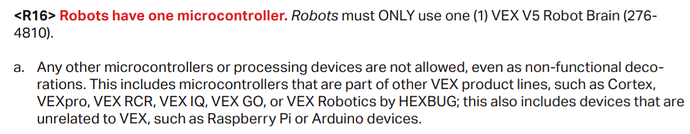

i don’t know if this is technically considered a micro controller or not, but because of this rule (R16), i think that they wont let you get the board listed as non functional decoration
Thanks for the rule, but there are only passive components in the board. I’ll submit a Q&A question to ask. They have allowed electronics before (ie LED lights) in the past.
It’s not a microcontroller. A TVS diode is a passive component.

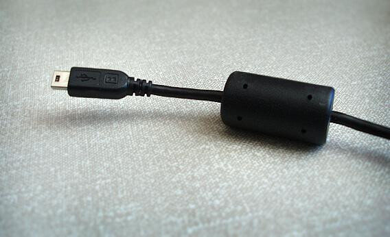

Perhaps we could come up with a in-line version like a choke (see photo). The RJ9 sockets take up the largest amount of space. Solder the diodes into a cable and cover it with shrink tube. Pretty hard to sneak in additional logic - less of a concern for inspectors.

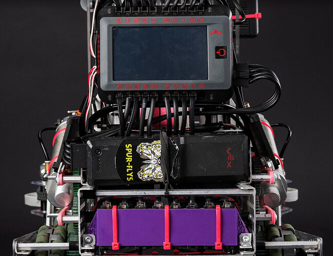

Hi, redacted team here, EZ3 at QIPE. I used ESD Boards during competition when I shouldn’t have because they are illegal.
In the image below, the purple box housed 8 ESD Boards and was on both halves of the tether, totaling to 16 ESD Boards. This acted as a coupler for the tether wire and stopped our ports breaking.
We tried our best to hide them during QIPE by placing a pink polycarbonate piece over that said OOGA and BOOGA, the names of the robots. The night before inspection, we painted multiple other polycarbonate pieces to avoid suspicion of a single oddly placed non functional piece of plastic.
If the referee’s saw them or not I can’t say, but I was very lucky no one approached us about them.
Using them during competition was an unnecessary risk to the time my team spent on the robots.
I suggest all teams use these. Going through the RMA every few months to replace your brain is an inconvenience that the ESD Boards can prevent. Just make sure to unplug them during matches, and they should be considered non-functional decoration. I’ve asked on the Q&A if these are considered non-functional decoration here.
