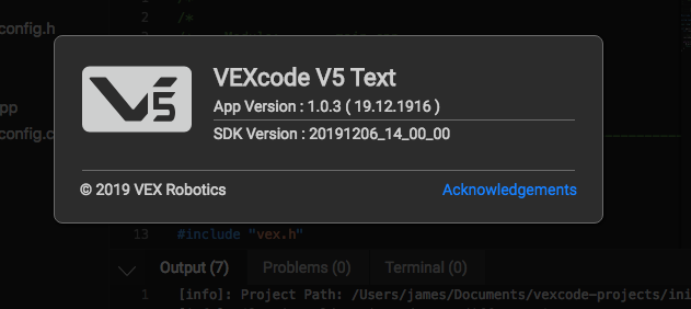

when I copy and past the config code ( vex::inertial Inertial( vex::PORT2 ); ) it gives me the error:
[clang] No type named ā€˜inertial’ in namespace ā€˜vex’
I’m running the most updated version of vexcode, what can I do to fix this?
Which version is that ? you need the 1.0.3 version released in December.
1.0.3 is working for me on PC but not on Mac
you could check the sdk version, but inertial sensor is working on both Mac and PC in 1.0.3
Anything unusual about the installation ? perhaps reinstall, I don’t know.
