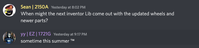

Any chance we will get a Spin Up update?
Screen Shot 2022-05-22 at 9.15.37 AM
@Unionjackjz @Yuanyang1727G
Any update to the Spin Up update?
